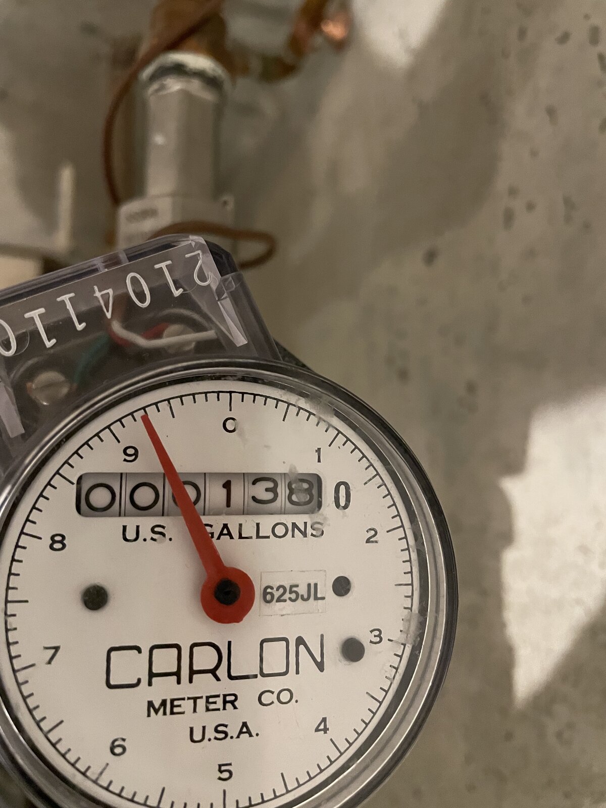

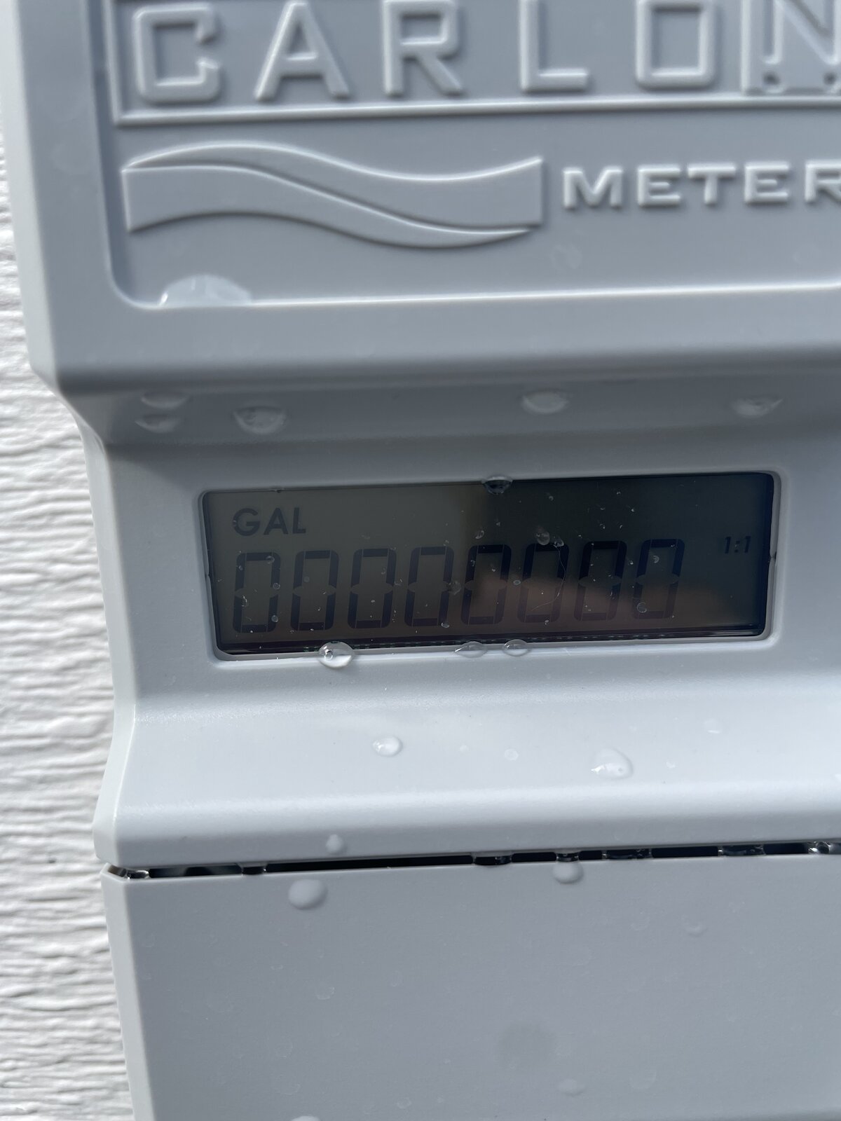

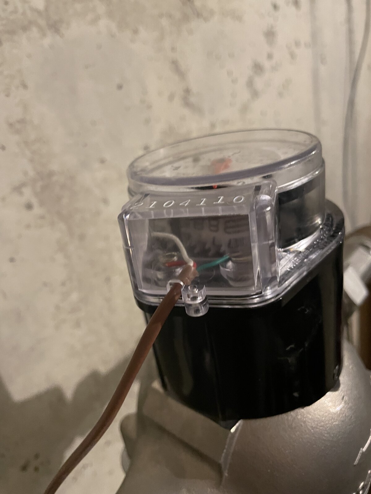

Outdoor deduct meter showing all 0’s
23 May 2023
2
United States
Had an irrigation system installed and the Carson deduct water meter (dial) is working but the wired remote meter that is on the outside of the house for the water company to read is showing all 0’s. The outdoor display unit and the indoor meter have both been replaced and still snowing 0’s. Any ideas? Think only thing left to replace is the wire from meter to display

No wonder it’s not working! Haha thanks for the heads up, had no idea 1. different meters were used and 2. I was in the wrong country for advice. Good news is I got it fixed from contacting the manufacturer and they were able to tel me what to do.
