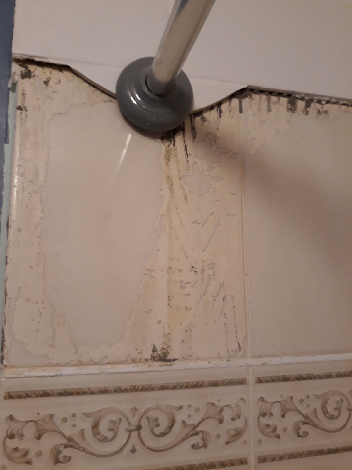

Hi, i am not sure why the thread was locked? I have taken off a couple more tiles and you can see this material, any idea what it was? I did smell a lot like like plaster. 20200511_160914.jpg
The original tiles are on plasterboard fixed to studs, its a timber kit house. These original tiles like i say are absolutely solid and fairly flat, could i get away with overtiling if i use mapei prim eco prim grip and bal single part flexible? The new tiles are the same size as the originals and i really don't want to have to remove the original tiles.

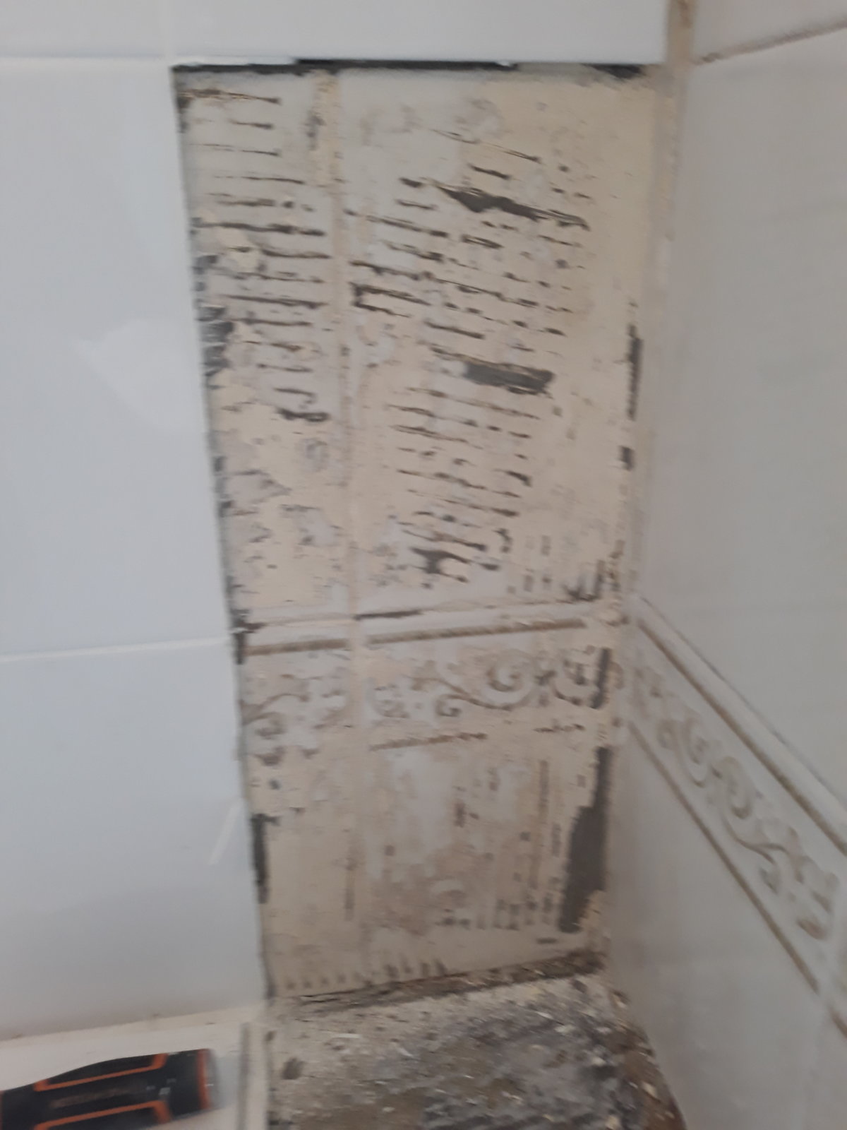

Would bal white star fibre enhanced be suitable or am I better with powdered adhesives? Here is some more of that residue on the original tiles20200512_003539.jpg

Hello ross94, the big issue here is the weight you are adding to your existing tiles by tiling over them. All substrates have a maximum weight limit after which there is a risk of debonding. Plaster skimmed walls have a max weight is 20kg sqm, bare plasterboard is 32kg sqm, tile backer boards and construction boards up to 100kg sqm depending on which one. It sounds like your tiles are on either bare plasterboard or more likely plaster skim. In either case though I would guess that you would exceed the recommended safe limit for your substrate. If it was me I wouldn't risk it.
