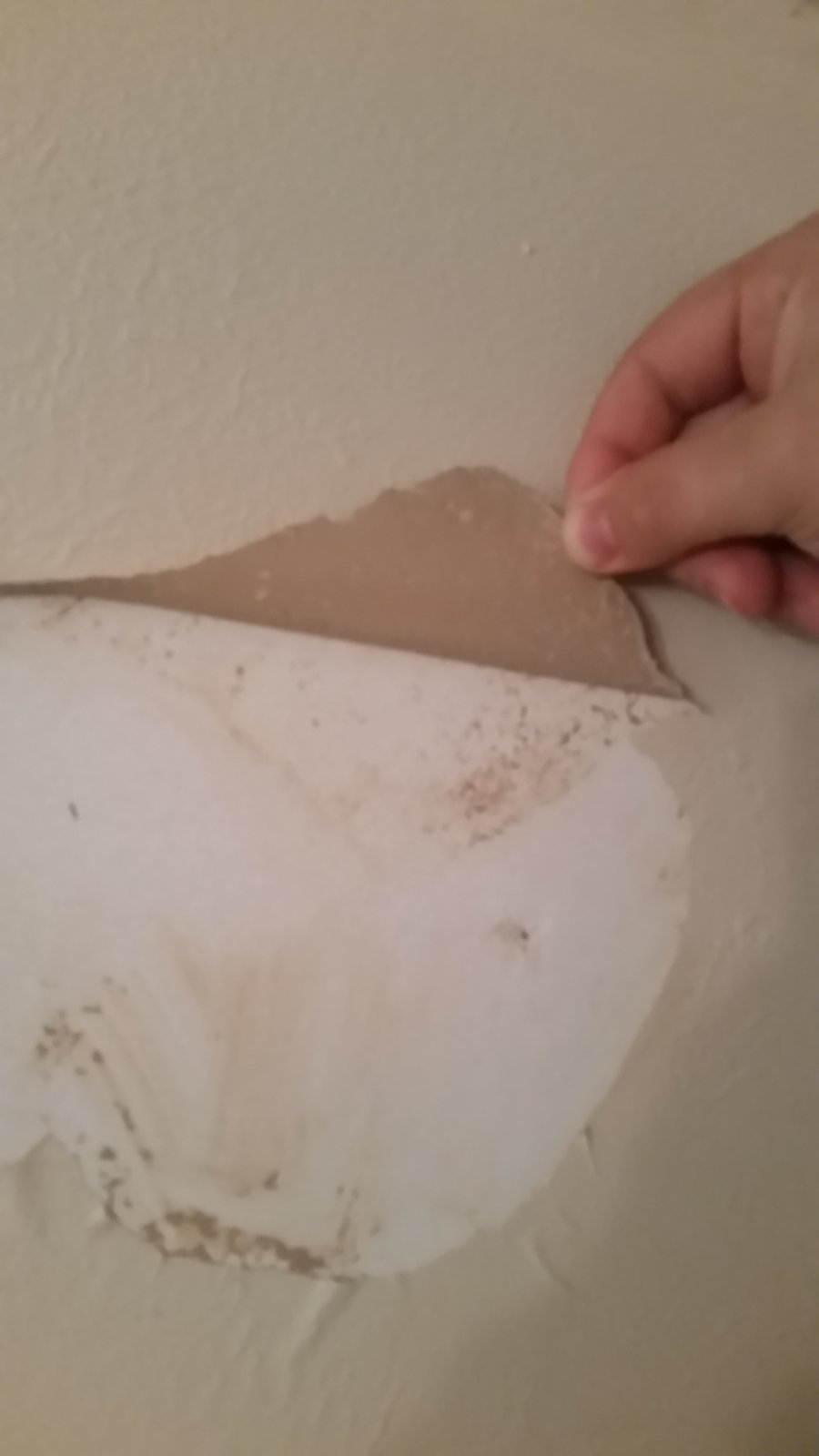

    Hi all,
    Today I noticed a bubble forming underneath some paint on my living room wall which was applied over 2 years ago.
    Upon closer inspection It felt like there was water underneath, so I made a little hole and a load of brown sticky liquid seeped out.
    I cleaned it all out and forgot about it until today when I i noticed it again but larger and more brown liquid.
    Has anyone seen this before and have any advice?
    I have checked under the floors upstairs in case there was a small leak but there is not.
    Thanks in advance
    Martyn

    brown liquid?
    Is it near a chimney, and has it rained recently?
    post some pics.

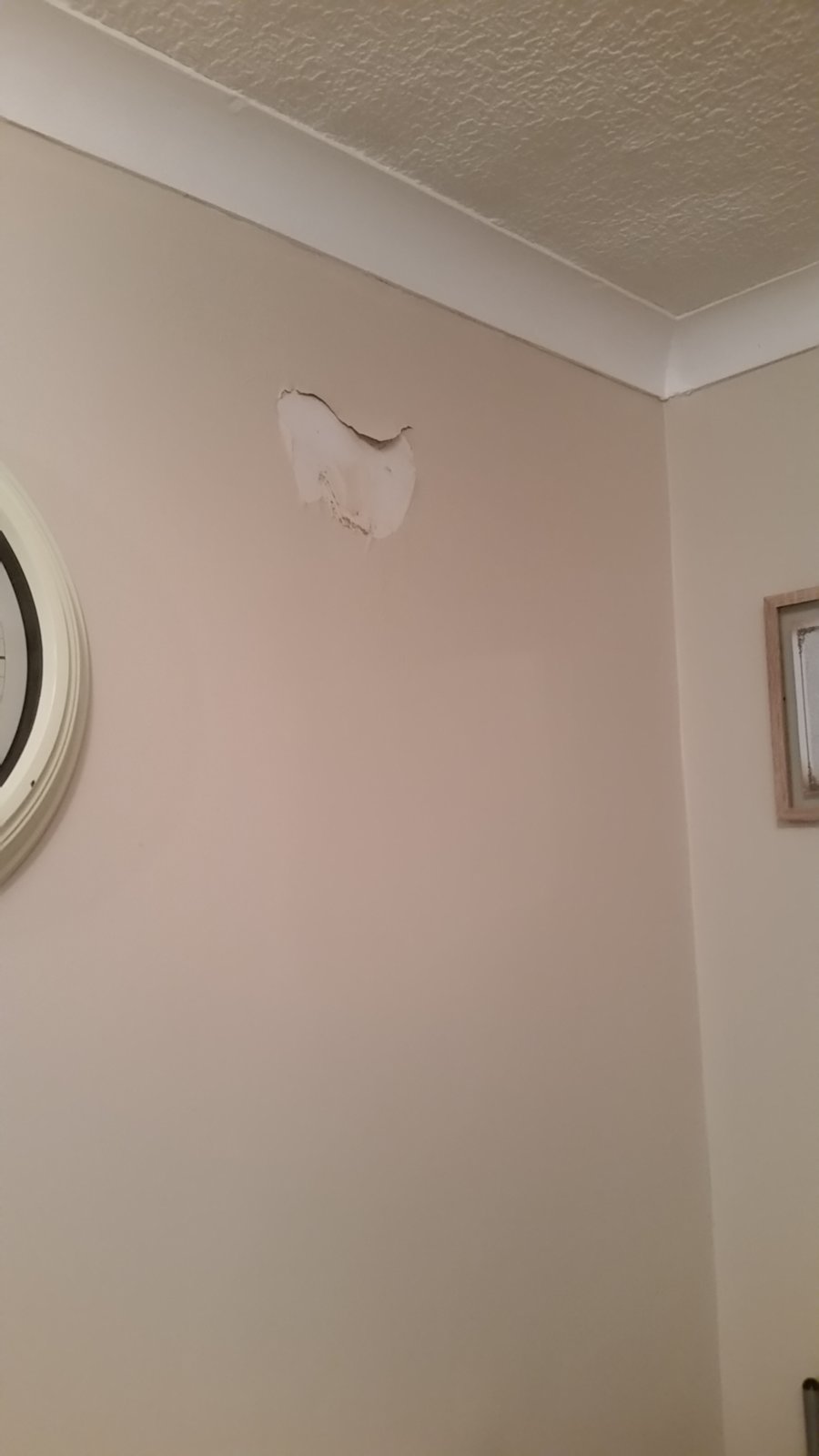

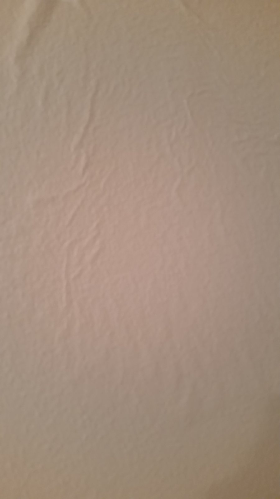

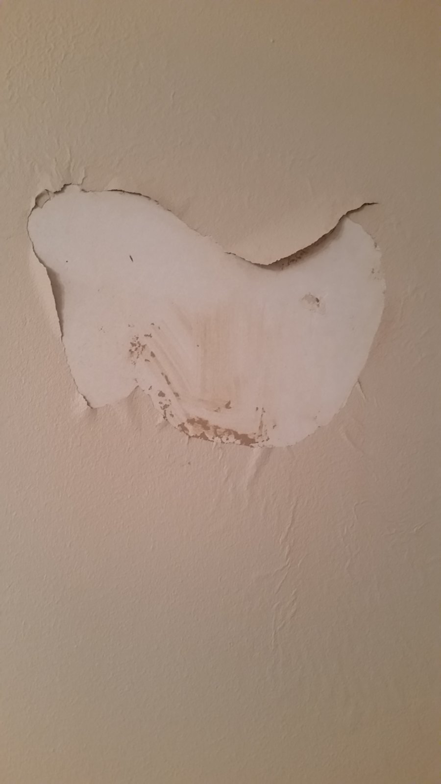

  4. Martynrbell
    Martynrbell
    Joined:
    22 Nov 2016
    Messages:
    28
    Thanks Received:
    Country:
    It has rained, but nothing worse then over the past few years.
    It isnt anywhere near the chimney .
    I've uploaded some picures below.
    Unfortunately I wiped away all the liquid before posting
    My wife has pulled a bit of the paint away.
    One of the photos shows the wall after all the liquid has been scraped towards the hole
    1502313641786-639239481.jpg 1502313671836-199225086.jpg 15023137391901194699273.jpg 1502313778636-2001073488.jpg
    Thanks again

  7. Bosswhite
    Bosswhite
    Joined:
    15 Jun 2012
    Messages:
    2,913
    Thanks Received:
    405
    Location:
    Southampton
    Country:
    Is that wall an outside wall ?
    • Thanks Thanks x 1
  8. Sponsored Links
  9. Martynrbell
    Martynrbell
    Joined:
    22 Nov 2016
    Messages:
    28
    Thanks Received:
    Country:
    Nope, the other side is in my kitchen.
    The wall to the right with the picture frame on it is an outside wall
    But is unaffected

    If the paint is coming off as clean as that, it may have been sealed with PVA prior to painting, which is a big No No !!!
  12. Martynrbell
    Martynrbell
    Joined:
    22 Nov 2016
    Messages:
    28
    Thanks Received:
    Country:
    The wall was painted with a mix of white paint and water prior to painting is that what you mean?
  13. Robbie uk
    Robbie uk
    Joined:
    9 Apr 2007
    Messages:
    2,059
    Thanks Received:
    267
    Location:
    Cheshire
    Country:
    No that's a mist coat which is correct. Sometimes people use PVA first but that will cause problem later.
    Think you need to scrape off as much of the paint as you can and seal it with a decent stain block and start again.
    • Thanks Thanks x 1
  14. Martynrbell
    Martynrbell
    Joined:
    22 Nov 2016
    Messages:
    28
    Thanks Received:
    Country:
    Just thought id get back to all that helped in here,
    Turns out the water was seeping down from behind the current walls.
    the only owners had put cladding up over tiles and it seems that some sort of condensation was building up and eventually causing it to drip and over time messed up my walls.
    bathroom remodel now in progress :unsure:
    Thanks all for your help
