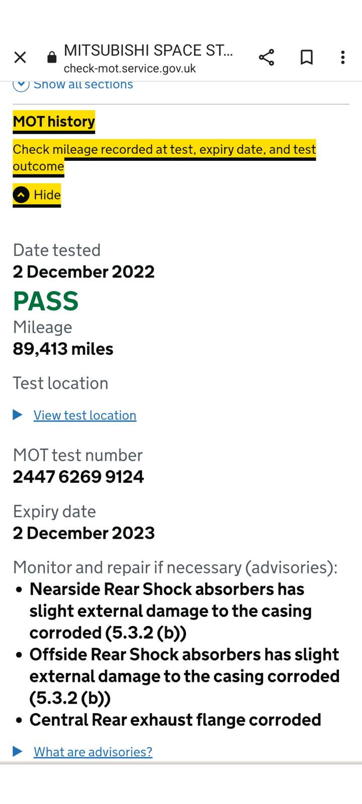

SpaceStar is potentially facing the end...
Shocks all round were on the advisory last year.
Plus a corroded exhaust mount.

There isn’t anything in the Advisories to panic about.....so long as the shocks aren’t leaking or showing real damage they should be ok - likewise the exhaust mount.
Motor factors can often supply non genuine import parts so nothing to panic about there.
Comline stuff is fine - there may not be a huge choice for this car anyway and any pollen filter will do.

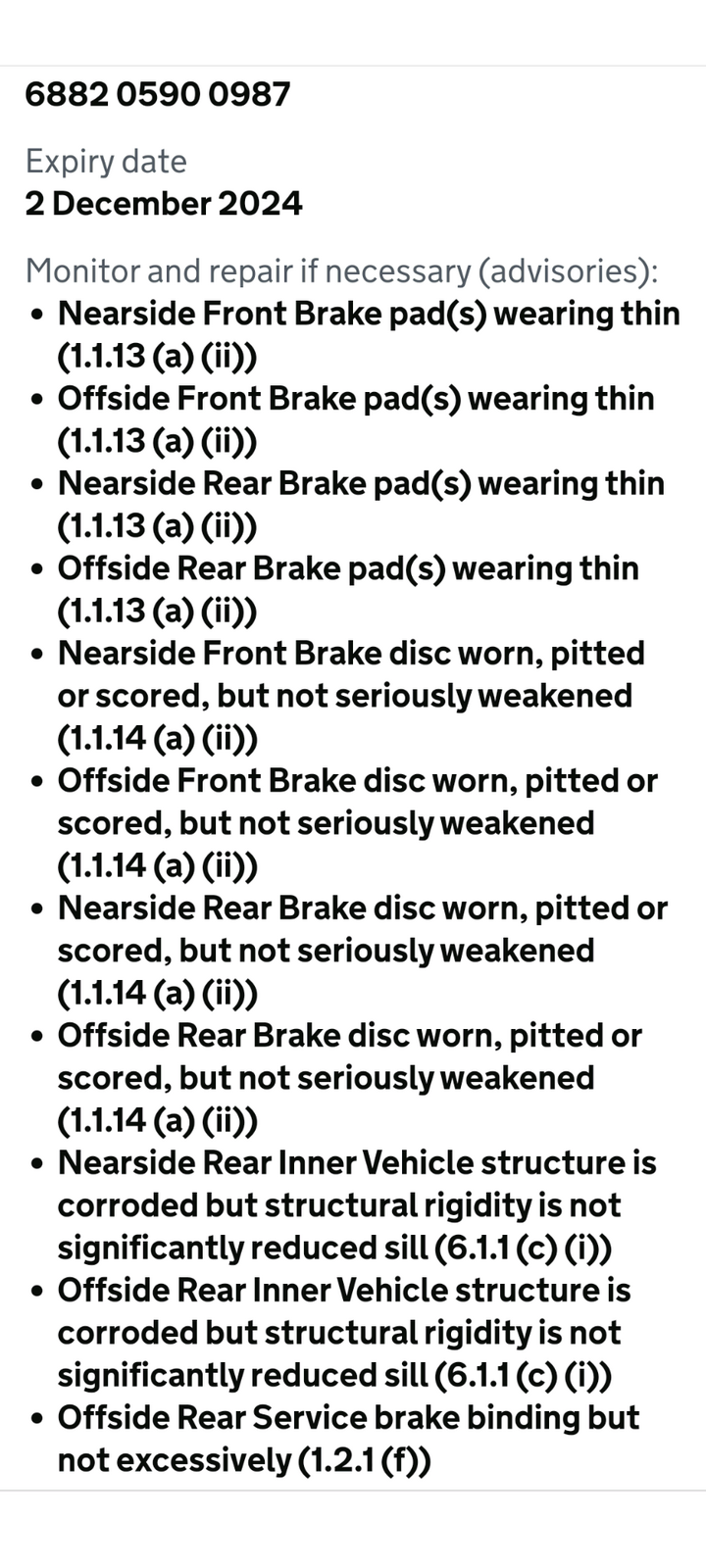

The car passed its MoT, but now we have to weigh up the cost of repairs.
As well as the below, it needs a good service and the ignition problem looking at, plus I still haven't got round to fixing the wipers yet. They pass the MoT, but they are dreadfully sloppy. Never known any others like it.
Just weighing up the costs now....
Had estimates for the brakes. Anything between £550 and £715.
Service will be £170 plus fuel and cabin filters.
Sills will be £300 for welding or less for anti corrosion treatment.
Misfire will need replacement coil pack and HT leads.
Wipers. Still haven't got round to fixing them, but having had a look, I think it might be a bit beyond me. The spindles are worn and slop about, the blade smacks the driver's pillar and they park too high. It's a nightmare to be in when it's raining, as the constant snack...smack...smack...smack does your head in good and proppa. I think I need to fit a replacement set of parts.
The trouble, as I've mentioned before, is that one is limited to second hand parts and it's more luck than judgement that you'd end up with parts that are less worn than yours....
I wonder how thin the pads actually are......!
Nothing there to worry you apart from the chassis welding, but you’ll need second hand bits for the wipers.
Of course, you now have another year on the tarmac so maybe you could consider the cars future this time next year?

The corrosion can't be too bad if they are suggesting treatment instead of welding.
Brakes are wearing parts, might be needed on any replacement car too.
Wipers, probably needs 2nd hand parts or using some bodge clips to take up the slack
