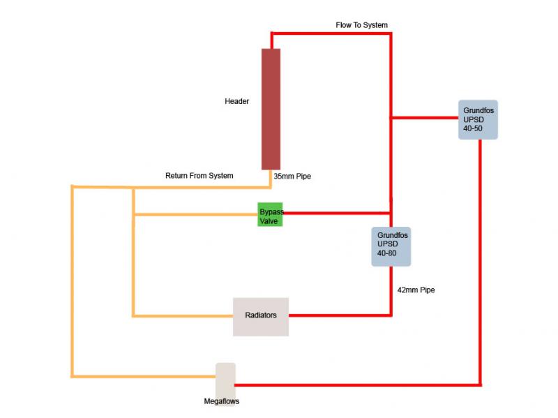

I hope someone here can shed some light on my problem.
There appears to be some kind of circulation problem on the central heating side of the system but I am unsure of the cause.
We have a low loss header fed by two keston C55 boilers. When the bypass valve is closed there is a pressure increase as the pump starts to work harder and most radiators heat up fine but some do not.
When the bypass valve is opened water seems to circulate very easily around the central heating system and the bad radiators start to warm up however it seems that flow water stops going to the radiator circuit and flow and return just cool down. It would appear the bypass route is the easiest path for the water so it just goes that direction rather than back into the header.
As soon as the bypass is closed flow through the central heating gets hot but again there is a circulation issue.
Could there be a blockage of some kind on the return side or parts of the system blocked with iron oxide deposits?
Could it be the return from the megaflow circuit is causing resistance by trying to flow backwards through the return from the radiators?
The flow and return pipes into the header are 35mm. I would have thought this is large enough but I may be wrong.
