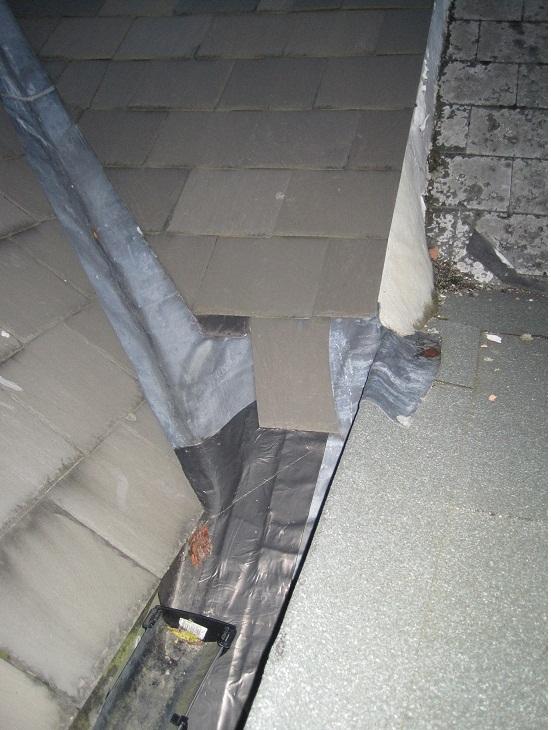

hi. we have a possible problem with moisture getting into the corner of our living room.
It seems to dry out, then soon after rain it seems to be worse.
have a look at the pictures here
The inside picture shows where some of the water sheen can be seen. several splodges indicate where the water has soaked into the plasterboard via a dab of adhesive.
Outside shots show the gutter i have installed to catch anything coming off the narrow piece of roof.
I have put some render and waterproofed it in the corners where there was a crack running vertically in the right hand corner.
What can i do to diagnose this?
My idea is to strip off the plasterboard etc from the corner inside and try to see where it coming from.
any help greatly appreciated.. thanks.

That roof is a right mess. It would have been better to extend the wall up, form a back gutter in lead which would then channel the rain around onto that extension roof or into the gutter
As it is, there is either a problem with that flashband and lead, the flashing to the vertical sides, or inadequate drip from the lead- letting rain run back towards the wall.
You would be better off spending a day on the roof sorting it out, rather than taking plasterboard off

got up the and took some more pics. this one should show what youre asking about..

Looks like you went walk about in the dark taking pictures?
I may be being paranoid, or i have been involved in too many "conspiracy theory web pages, but"
The paint that I see on your last posted image is just a wee bit too new for my liking?
I think your neighbour is experiencing shall we conjecture and say some damp problems?
Also I think I see some vestiges of either moss or dirt around the cement that is newly painted, if this is dirt then it can act as a wick and allow water to get in where it is not wanted.
I would suggest a very, very friendly approach to your neighbour to ask if they are having "shall we say problems" in some areas of their property???
From that last picture it seems that someone has patched it up recently and just stuck some self-adhesive flashband on top of lead - this is a recipe for disaster
So this seems to be a known problem which someone has tried to fix/bodge.
However difficult you do really need to get the whole area sorted out from the outside.
:oops: :oops: Well 'someone' (me) has done that recently to try to combat the problems. It obviously hasnt worked.
Whats the problem with using flashband on lead? (I used a heatgun to ensure the backing was good and sticky before applying it)

Its a days work for a roofer.
I would rip out that whole lot, lead, slates and f/band. its a bit of a disaster.
That`s a day`s work for a QUALIFIED LEADWORKING roofer :idea: . Not a member of the Travelling community . In fact a long day , I would say . I can do a bit of lead welding and a neighbour runs a specialist leadworking co. Both of us are Plumbers originally . Sussex not Essex , unfortunately :cry:
