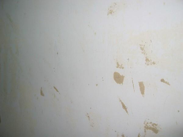

I am re-decorating a bedroom that had vinyl wallpaper which I peeled off leaving the backing paper. Just before I starte papering I checked into the forum where a search advised NEVER EVER leave the backing paper.
I took the advice and I am now left with an awful surface of flaking and bubbling paint, different paint surfaces, gouges into plasterboard etc.
Have a look
and
These are after I spent ages removing the old paste and gunge.
What are my DIY choices to achieve a reasonable surface for "fine decor" textured vinyl?
Jim
Fill in all the big holes and gouges, Remove all loose and flaking paint. Cover walls in a good quality lining paper, hanging the strips horizontally. Then hang your wallpaper as normal.
Not sure what the professionals would say but it worked for me.

I've now filled the gouges & removed flaky paint etc. I'll now have to sand the walls before putting up lining paper. Is it definitely better horizontal? Also, should I size before lining paper?

Hanging the lining paper horizontally is done so as to avoid vertical seams lining up between lining paper and wallpaper. Probably best to size the walls first. Good luck.
