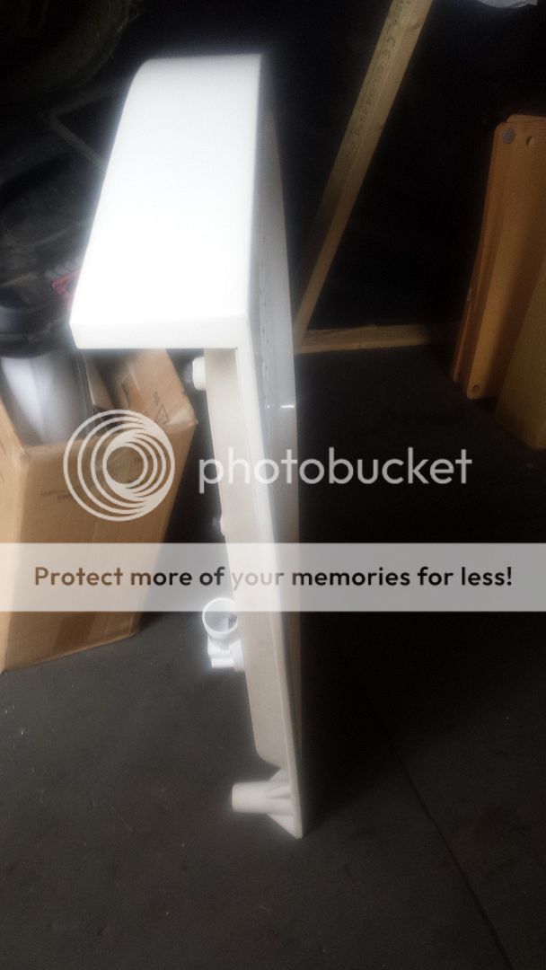

Now the shower tray is a stone cast one with fret on the underside . No specifications on how to fit and does have these feet. See pic
Is mortar required under the base or just supporting where the feet are or can it just be set into place ?

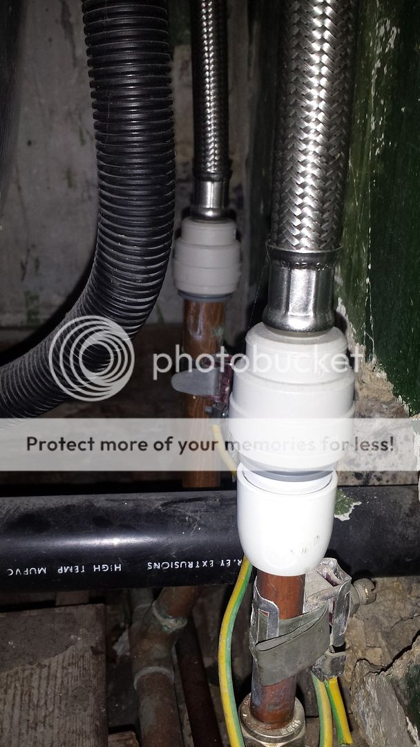

This is the feed for the cold i was planning to take then blank off or even find exacty where it comes from and switch out a t piece for a straight coupling and get rid of the hot pipe all together ?
The cold will be diverted left under floor then up the wall to shower

1) That doesn't look like a stone cast tray
2) You will need the legs (I can't make out if you have them or not!)
3) Mortar base not required for leg supported trays

6) If you are cutting supply pipework and it will be redundant then trace back as far as possible and cap off close to the supply (to avoid dead-legs)
7) You post suggest that you are installing an electrically heated shower - this needs to be fed from mains cold supply.

edit: Looking at those feet I'm surprised that there are only 4 in the centre of the tray - look like poor weight distribution.

The tray is a stone resin one

I stand corrected on the stone resin tray (assuming you trust the Chinese supplier!).
Re the cold feed - if you are installing an electrically heated shower (which your post suggests) then you need a mains cold supply - is the supply to either your bath or basin cold mains?

Actually though the mains supply would be one going to the bath with the 22m pipe.. supply shut off is directly below the bathroom and the routes the pipes take. Well the bath taps / supply anyhow :)

Erm how i know which are mains feed ? As said the both have great pressure
If you have existing H&C supplies then using an electric shower is a dreadful idea! Without a high load shower (in terms of electrics usage) the output temperature , especially in winter, will be warm at best. The cost of using electricity to heat water is significantly higher than gas (assuming you have a gas boiler heating your domestic water).
A better solution would be a thermostatic mixer shower
To check if mains fed - close the main stopcock (the cold water at the kitchen sink should be dead) and see what effect that has on your bathroom basin & bath.

I agree with Newboy - really doesnt look substantial enough for a stone/resin tray. Would suggest you need far more legs to distribute load.
Don't let your cheap tray get in the way of what you want to do. Be prepared to sling it and buy quality if it starts to get in the way of a class installation.

Sorry to pour more water on your fireworks but back to the tray.
There is no upstand on the tray - means the tiles will run down to the tray surface and you will be totally dependent on the silicone bead to provide a seal between the wall (tiles) and the tray. This isn't a problem providing that there is no movement (and looking at the support arrangements for the tray, that would seem unlikely).
