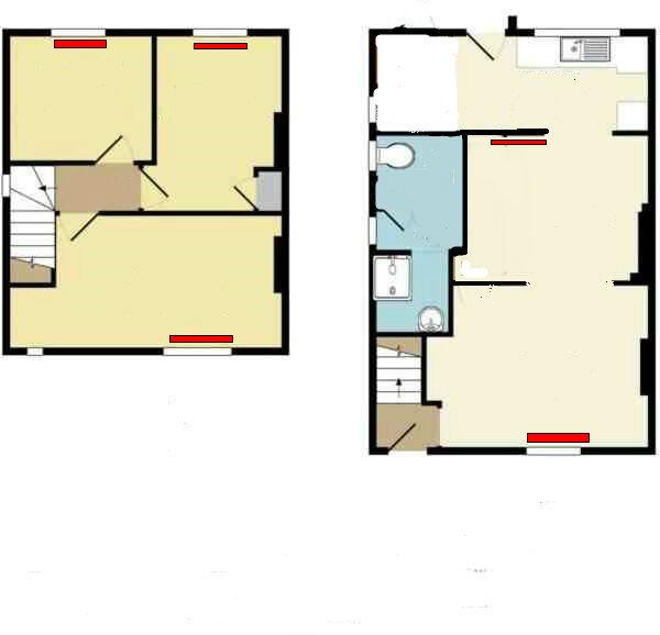

Hi there
Just looking for some thoughts on where I should position the radiators in my house.
I've attached a rough floor plan below, with the red rectangles showing where I was going to put them.
Does this look OK?
Cheers
Looks ok. Nothing in the kitchen or toilet? Might be an idea to have a small rad at the bottom of he stairs, behind the front door.
I would say the same as above, if not I would of thought they may get a bit nippy when the weather turns cold.
