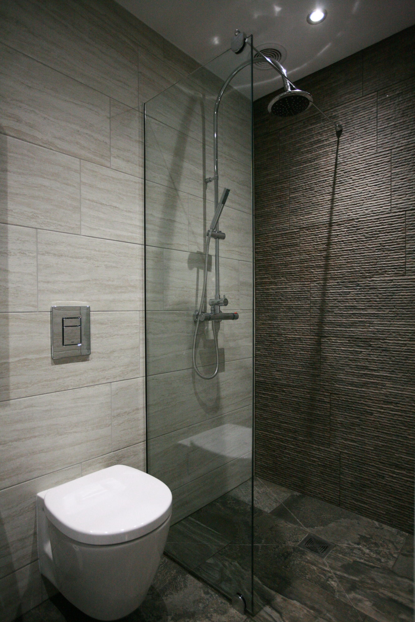

My house is quite old and the floor levels were a mile out. Ripped up all the floorboards and glued and screwed sistered joists with noggins to set floor levels, using 25mm ply for floor outside of tray. I did put a very slight slope on whole floor towards the drain - can wash whole floor down more easily. I do have a slight step up in the doorway, but this was inevitable no mater what i did due to the underlying uneven joists.
I do have electric underfloor heating to warm tiles and speed drying, but this added negligble depth to the floor overal.

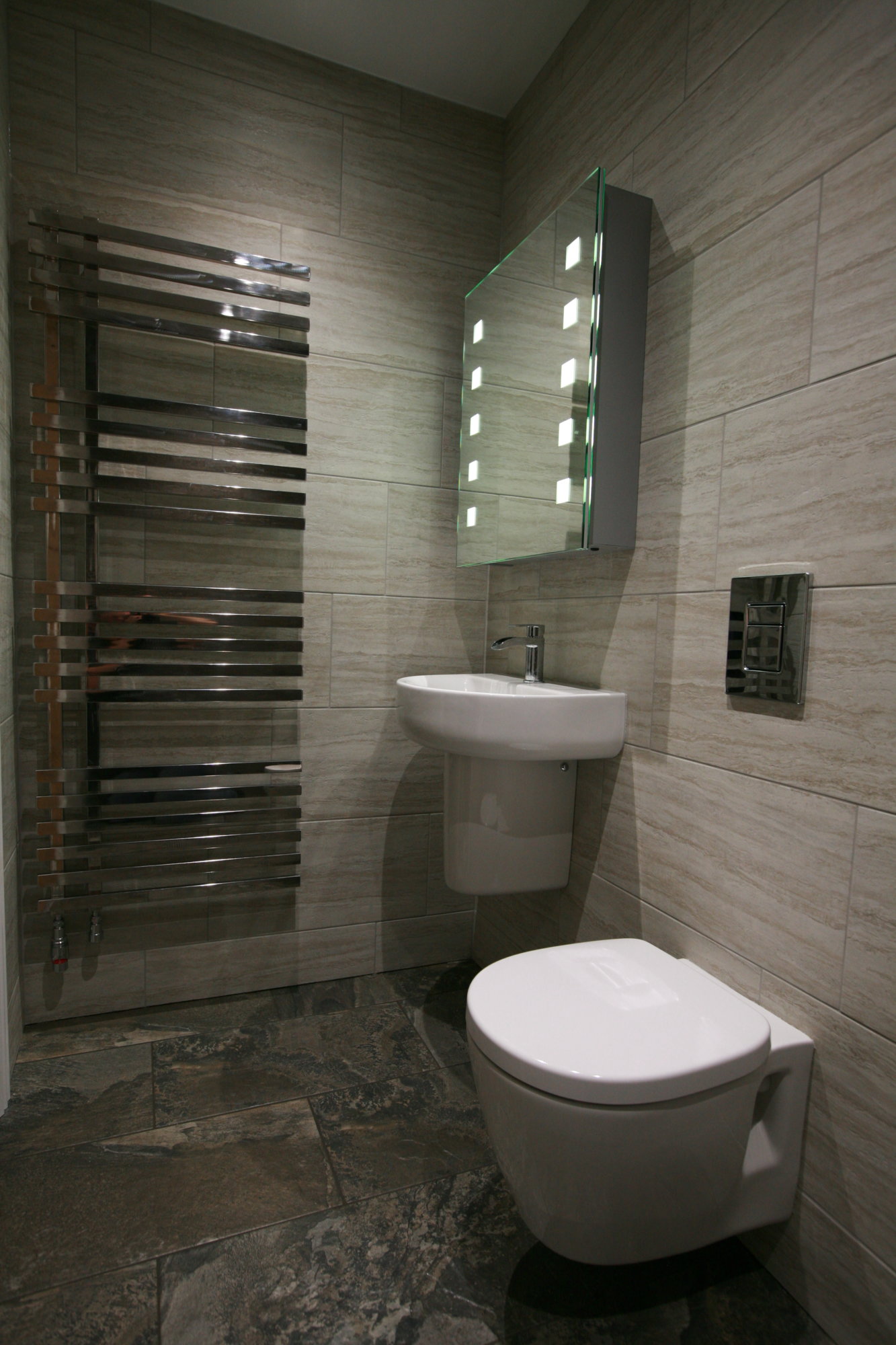

Cant find pics of it part constructed at mo, but this is finished job:
Reds, that looks quality work and what you described is pretty much what i had in mind for the construction. I see you have a supported framed cistern inside the wall, with a floating toilet, had any niggles with that cistern given the fact its hidden?
No problems as yet. Its a grohe one, get to cistern through flush plate, fair sized hole. Worst case i go through the wall behind! :LOL:
Its fitted in a stud wall made of 2"x8" (can just squeeze in frame and sidesward running 110mm soil pipe behind it) and the other side is just a plasterboarded bedroom wall.
