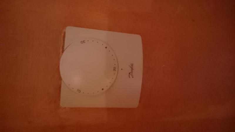

    Hi, I have a pretty traditional setup with a gas powered boiler for heating and hot water with a single room thermostat which is just a simple dial to set the trigger temp for the radiator heating.
    I would like to replace the thermostat with a time controlled one so that I could get it to trigger the boiler to heat the radiators at set times and at set temperatures so overnight at 18 degrees, during the day (weekdays) at 15 degrees and early evening at 20 degrees.
    This product looks suitable:
    http://www.salus-tech.com/products/thermostat/programmable-room-thermostat/_c1_23_st620pb/
    But I wanted to check if I'm over-looking any other relevant products. I'm not really looking for internet control, wifi etc.
    My simplistic (possibly overly so!) view is that the current thermostat is just making a circuit that causes the boiler to start heating the radiators (via the programmer which is set to "always on"). So, a new unit with more flexibility is just replacing the outputs so should be an easy swap?
    Any help/suggestions appreciated.
    Adam

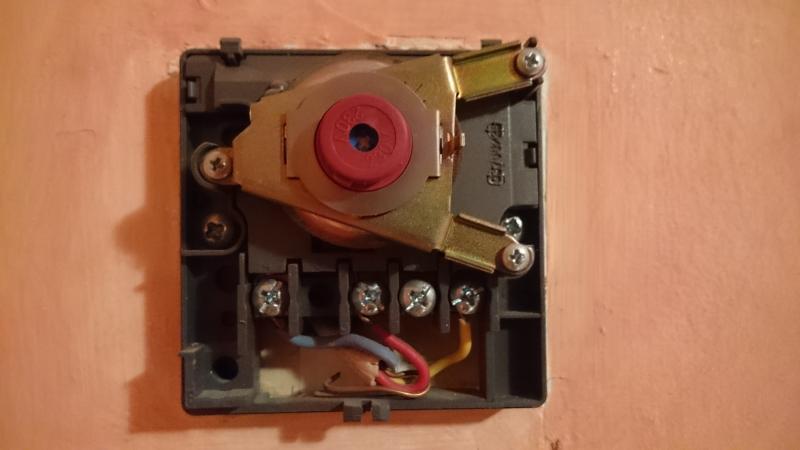

    Thanks guys, I have the new thermostat that needs just a live in/ out.
    I opened up my current one and it has the following:
    What do I need to do to replace this with the new one? I was hoping to see a similar live in/out so bit stumped.
    Adam[/img]

    The thermostat you have is an old mechanical type. they have a little internal heater called an accelerator that improves their switching accuracy. In order for this to work, it needs a neutral connection. Your new one doesn't need the neutral, so it needs to be isolated. Usually this is done by fitting an insulated screw connector and tucking it out of the way. Do not connect the neutral to your new thermostat or you will cause damage.
    The usual method of wiring is.
    Red = Live
    Yellow = Switched Live
    Blue = Neutral
    I have come across the odd rogue installation which uses a different convention, so it will be best to either check the wires with a multimeter, or trace them back to see what they are connected to.

    Great thanks, was wondering why it needed power.
