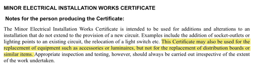

Hi,
I am having downlights replaced in the bathroom (directly above bathtub) and living areas, including the switches that control the lights. I have asked for minor work certificate for the work, but the electrician says certificate is not required because it's not alteration. Is this correct?
Thanks in advance!

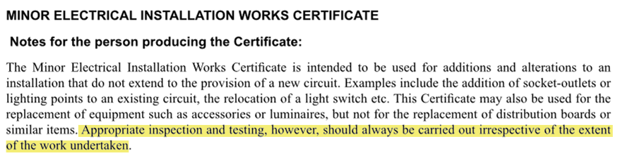

If any testing is done then the results might as well be recorded - a certificate.
Nothing to do with the type of work.
He's under no obligation to test given the scope of work though

As this job is minor you should get a minor works certificate.
BS7671 Appendix 6
May and must are 2 different words.
Never said they weren't. Just posting what is actually in the regs rather than other peoples "I think", "I do" etc.

To my mind I would always issue a certificate to show what condition it was in when I left. It is what is not entered which is more important.
Like for like does not come up. But that is basic what one is looking at, it's a bathroom so any more than change a bulb should be inspected tested and results recorded.
