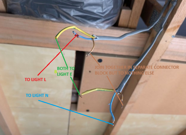

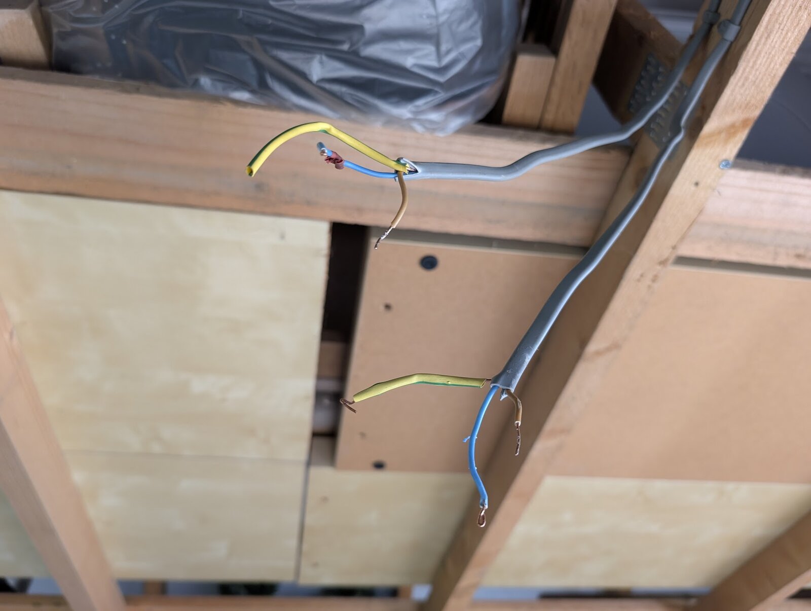

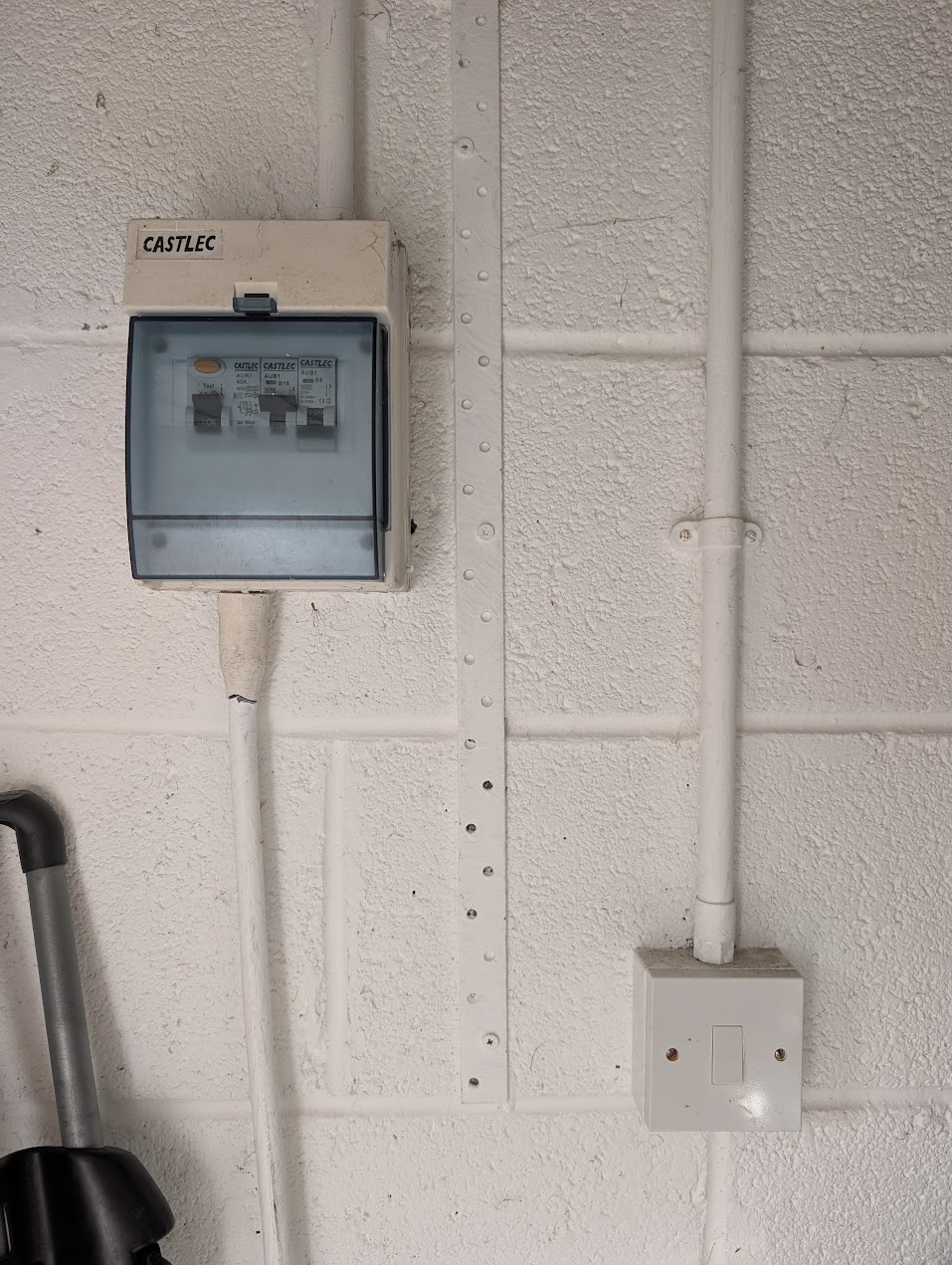

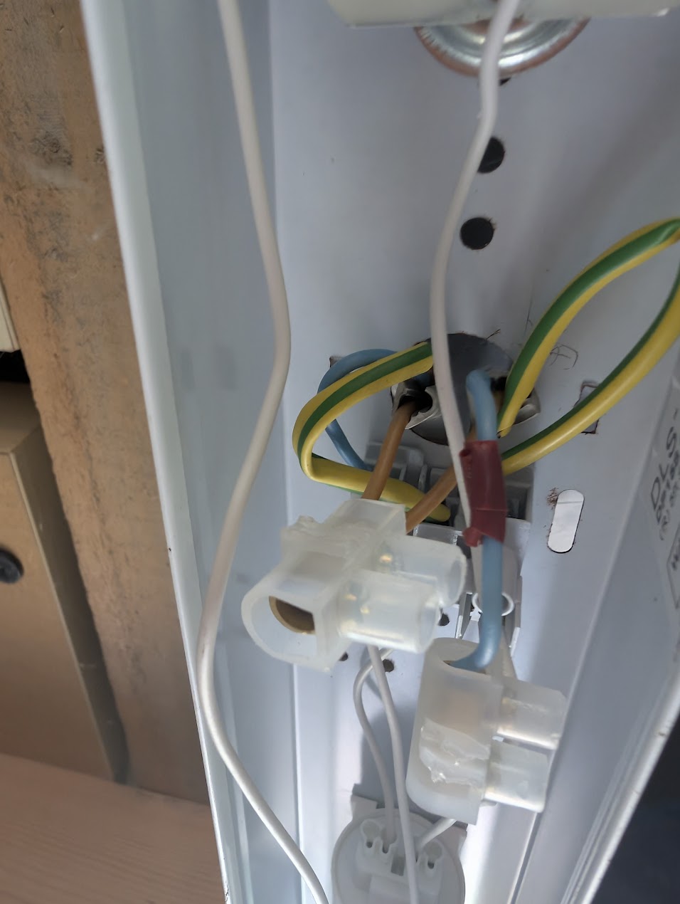

I want to replace a fluorescent strip light which has already been removed. The first picture shows the wiring left after removing the light. One of the wires goes back to the fuse box in the second picture, and the other wire goes back to the light switch in the same picture. How do I connect the new light shown in picture 3? Picture 4 shows the wiring in the previous light.
