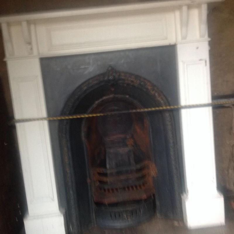

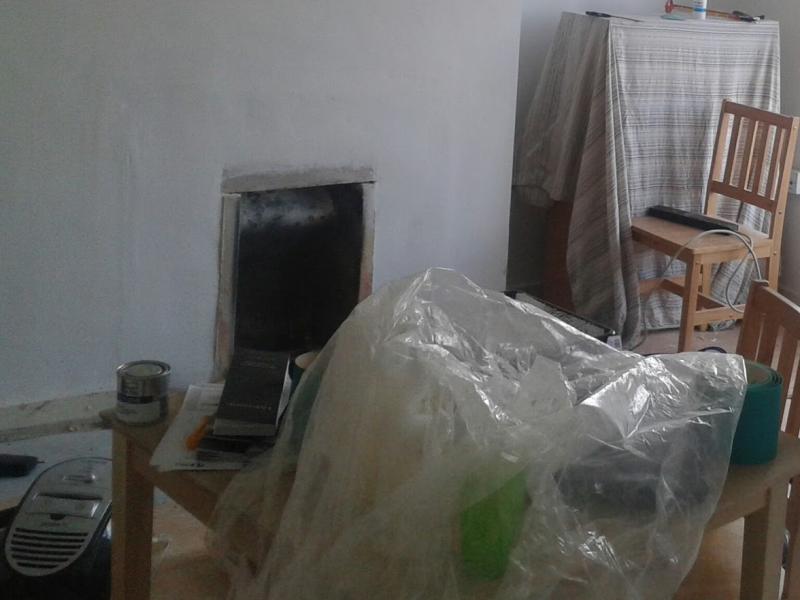

I want to install the iron fireplace and its surround in the attached pic, and replace the simple hole that currently exists there (again, pic attached showing the white plastered wall).

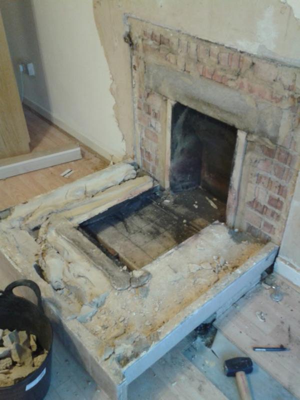

Attached is a pic showing what is behind the current white plastered wall of the fireplace.

2. measure the replacement insert - not the surround, and outline the dimension lines (height & width) on a pic of the chimney breast. The opening might need widening and going higher.
3. what is pic 1. showing?

2. If the opening needs to be made higher, I'll be chopping away pieces of the (concrete?) lintel at the top of the hole; is this safe?
3. pic 1 is actually showing what the fireplace currently looks like - the surrounding brickwork was plastered up and painted.
5. Front hearth is filled in with floor filler and flush to the surrounding floor.
