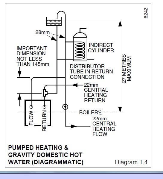

Refer to the attached diagram from the Glow Worm 52/3 back boiler manual for the installation and you will see that my Central heating and hot water system is gravity fed hot water with a coil from the back boiler to heat it and also has an ELECTRIC element as backup.
I may be a friggin ****** as far as you are concerned but I hope that explains it for you genii.
FF, that system is nice and basic and The back boiler surely can be repaired for a reasonable cost as most first line spares are still around. To improve the system it can be converted to fully pumped operation. Just a few things to consider. Good luck
