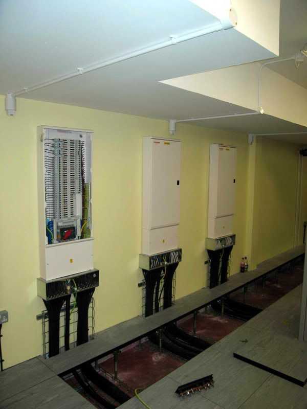

You don't need to have two CUs just because you have lots of circuits. 20 ways or so are not uncommon in the better brands. See pictures in http://www.diynot.com/forums/viewtopic.php?t=70551&start=0
If you have loads and loads of circuits then you could always fit a TP distribution board with a single phasing kit fitted to it.
Then you could have a board with as many circuits as this :shock: :shock:

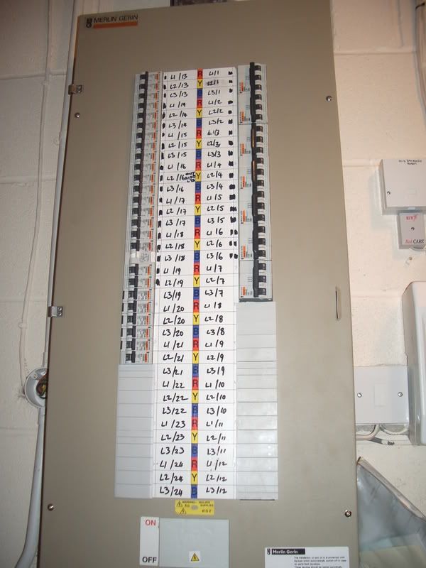

And if one's still not enough....have 3!
:wink:
PS. I wonder who will be first to spot the deliberate mistake in the open board?
