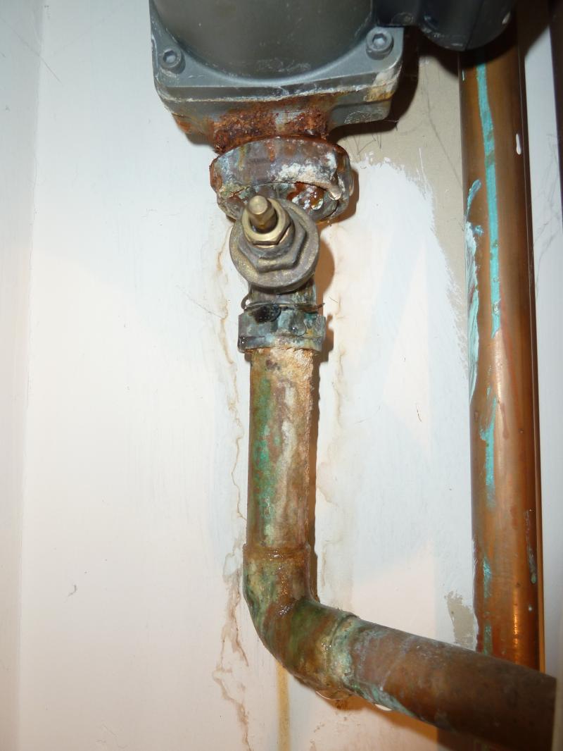

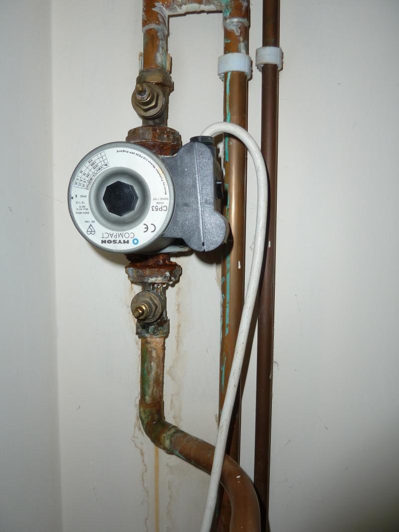

I've read a few posts on here about replacing a pump, so I have a good idea already. At least I know my heavily corroded mess will not be a simple swap.
I'm replacing a Myson cp53 with a Grundfos 15/50. I've read on here to grease the pump thread (Silicone Grease) to aid in future removal\ maintenance. Is this standard practice\necessary, or just a good thing to do?
If so, where can I buy it?
I'm looking to replace the pump values (gate type) because they're corroded and the spindle is now dripping, and they're probably stuck to the pump.
Apart from being 22mm size, are they all roughly the same shape\ size? They have no obvious markings apart from 'made in italy' (the house is about 12 years old). Is there a particular brand that fit nicely with the grudfos rubber washer?

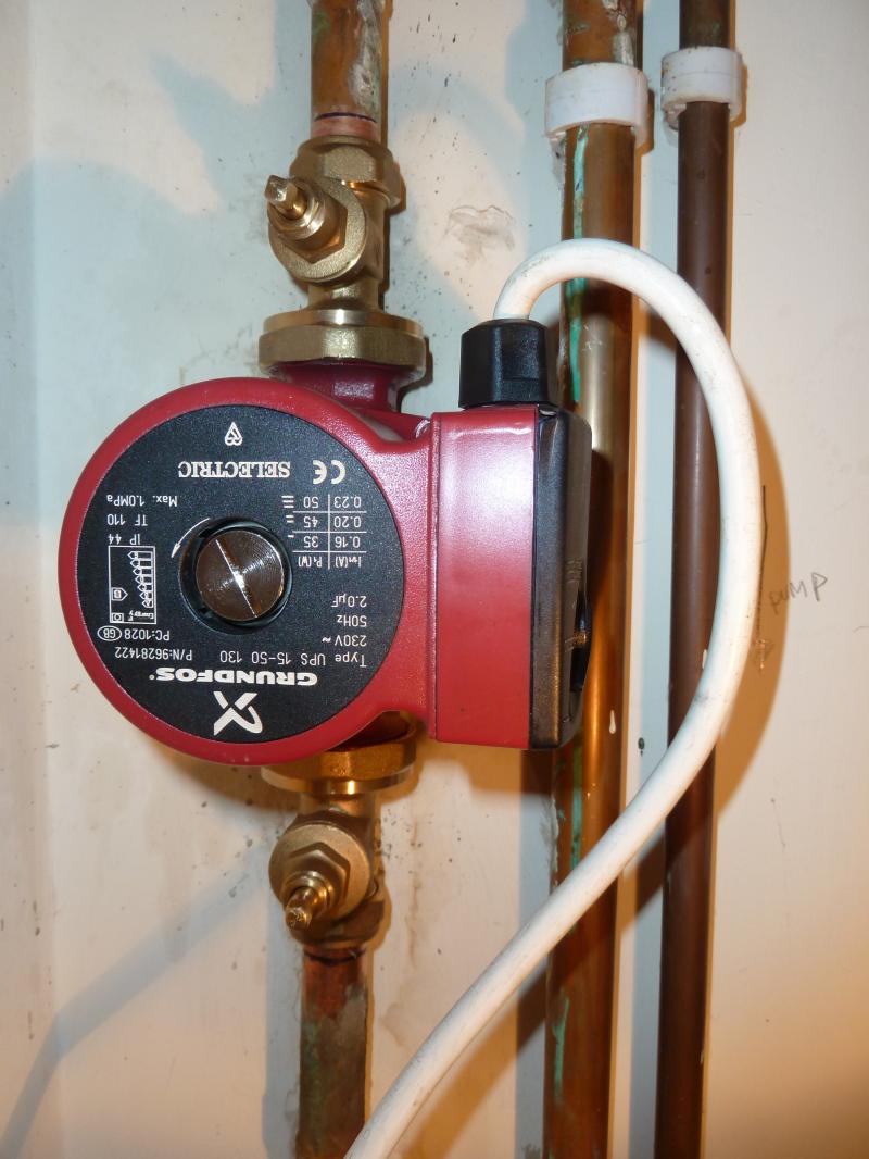

Thanks for the tips. My first difficult plumbing job, so I thought I'd post the results.
Before.
Before.
After, just needs some pipe clips.
