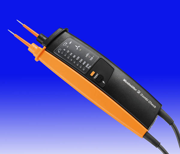

mcalpinep said:
I take it all I need is a circuit tester (which I have).
Don't know what you mean by "circuit tester". If it's a neon screwdriver, then it's better than nothing, but there are strongly held opinions amongst the glitterati here which are basically that it isn't a great deal better than nothing.
Something like this is better:
or just a basic multimeter, which you can pick up in Maplin, or even (wash my mouth) a shed, for £10-20, which if you think about it is less than the savings you're making by installing the oven yourself.
Don't forget - while the spur is disconnected, go round and find which sockets are on it, for future reference.
