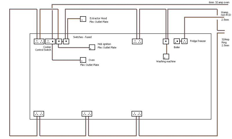

This is my first post, the existing wiring to my kitchen is a disaster and possibly dangerous, as i am fitting a new kitchen soon anyway I intend to upgrade/replace the wiring.
I am hoping that you would have a look at my wiring plan and come up with suggestions/ideas about it, so I don't look a complete idiot in front of the BCO!
Any help is appreciated.
I have called building control and intend to start work proper in may.
What size cable are you using for the oven ?
Don't forget your RCD with regards to socket outlets and buried cables.
Is your CU suitable for a 40A circuit ?
Is your bonding up to scratch ?
I was going to use 6mm cable for the oven, both circuits will be on rcbs. all the switches will go above the counter top and are away from the taps.

PS. On a more technical note - 40A is pushing it for a 6mm cable (depending on installation method - best to change down to a B32.
A ring is not a good design for a kitchen (or indeed at all) owing to their being large fixed loads.
Consider running a nonRCD circuit for your boiler and freezer
Thank you, you all, I will persivere, I've revised the plan as per your suggestions, but on the boiler/freezer radial, would I be better off using a rcbo?
Or increase the size of your cable, depending on the load
