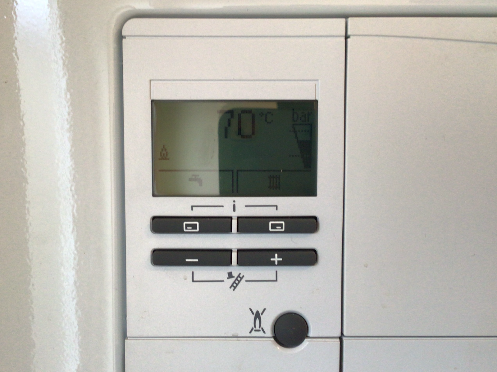

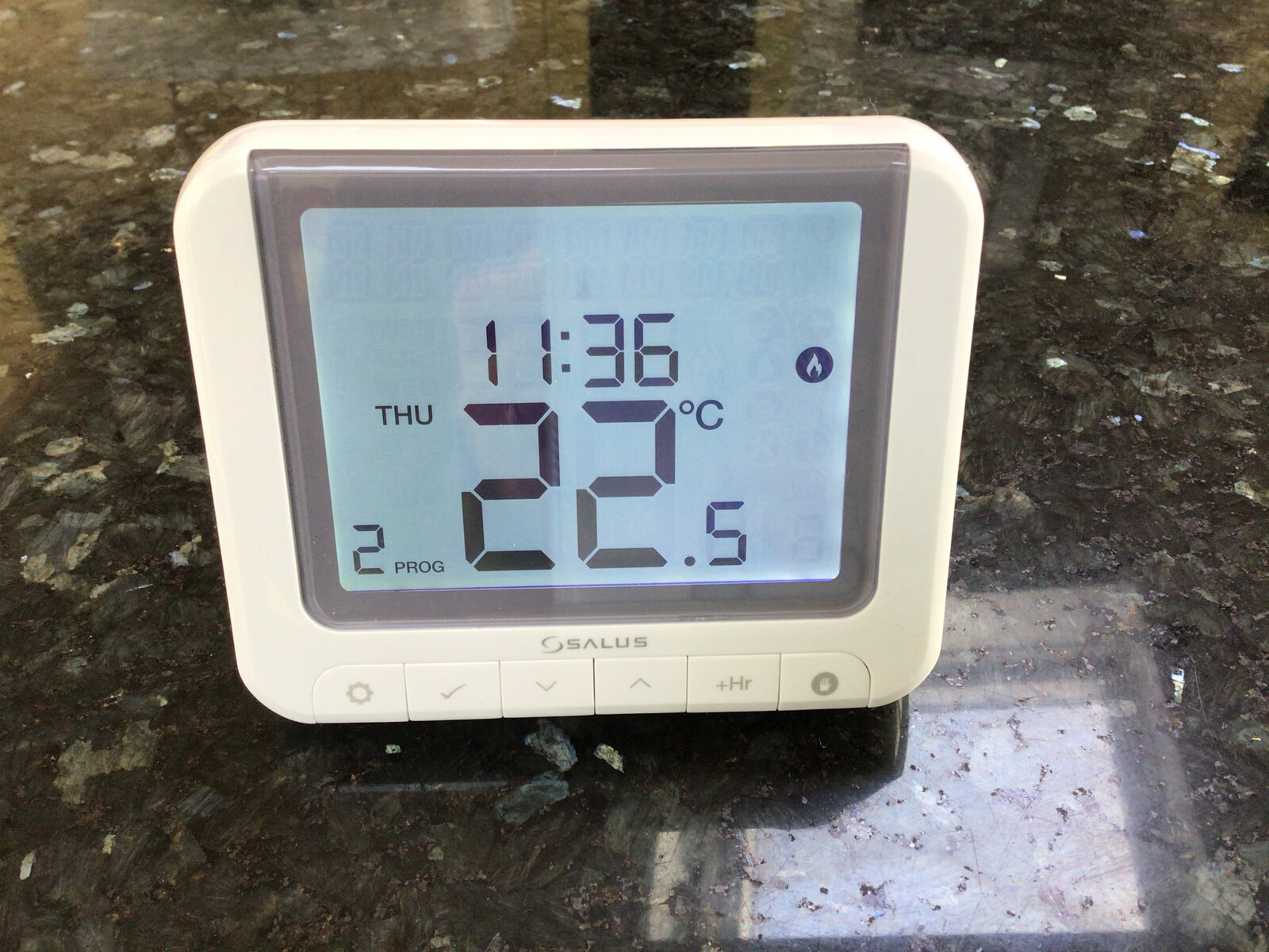

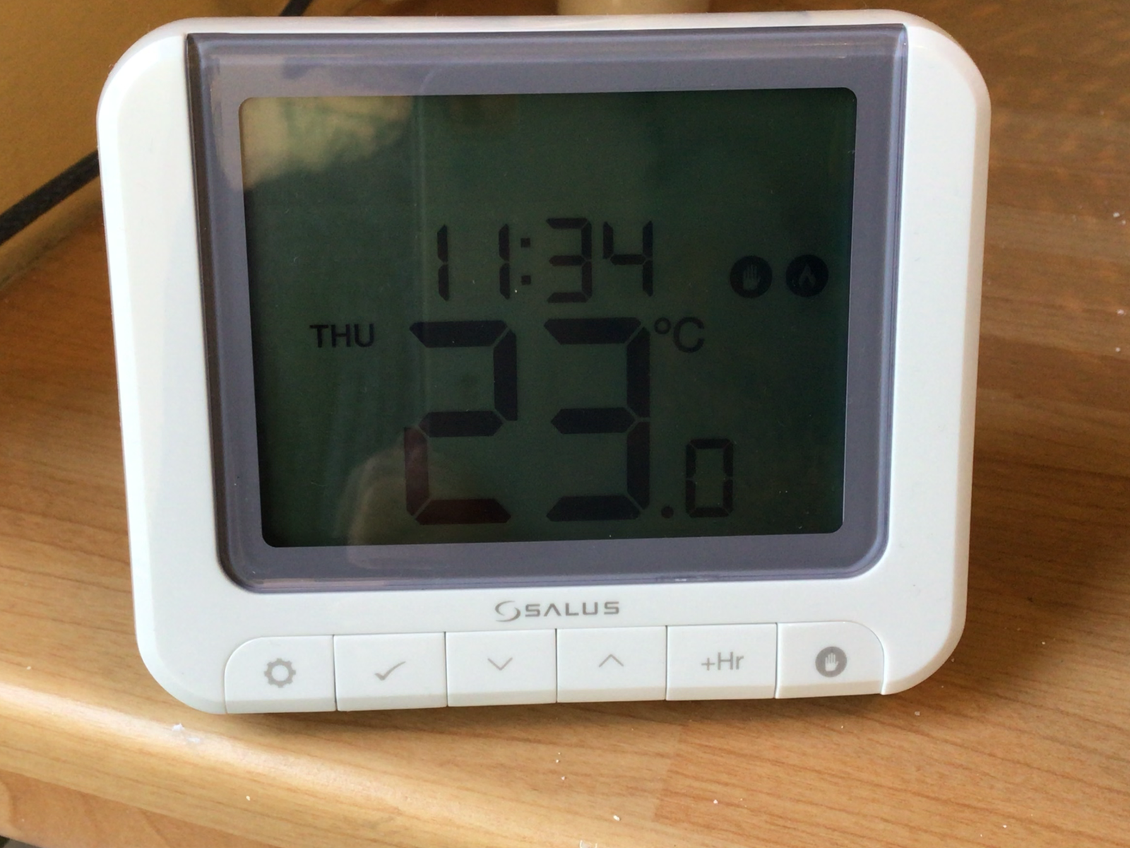

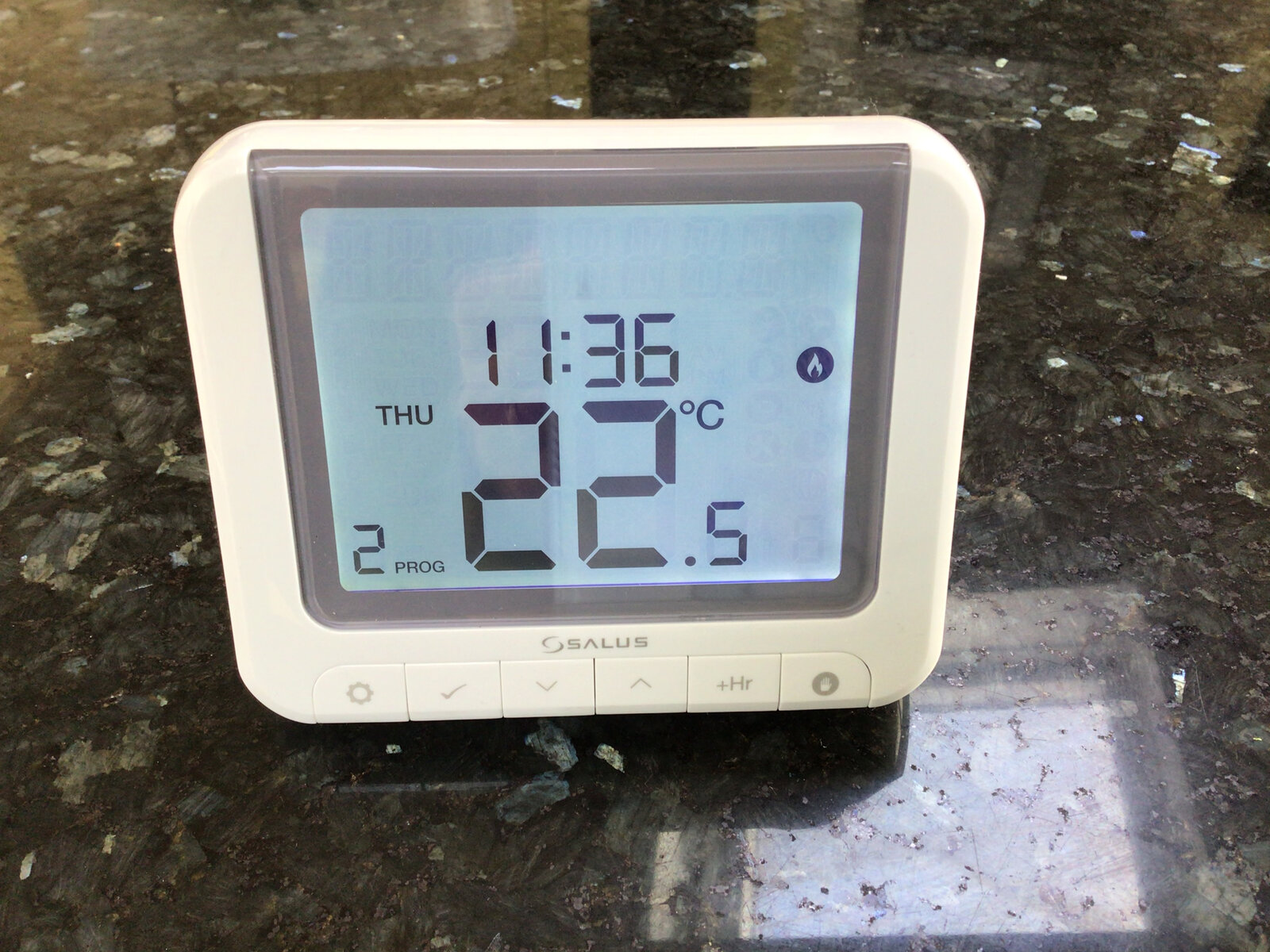

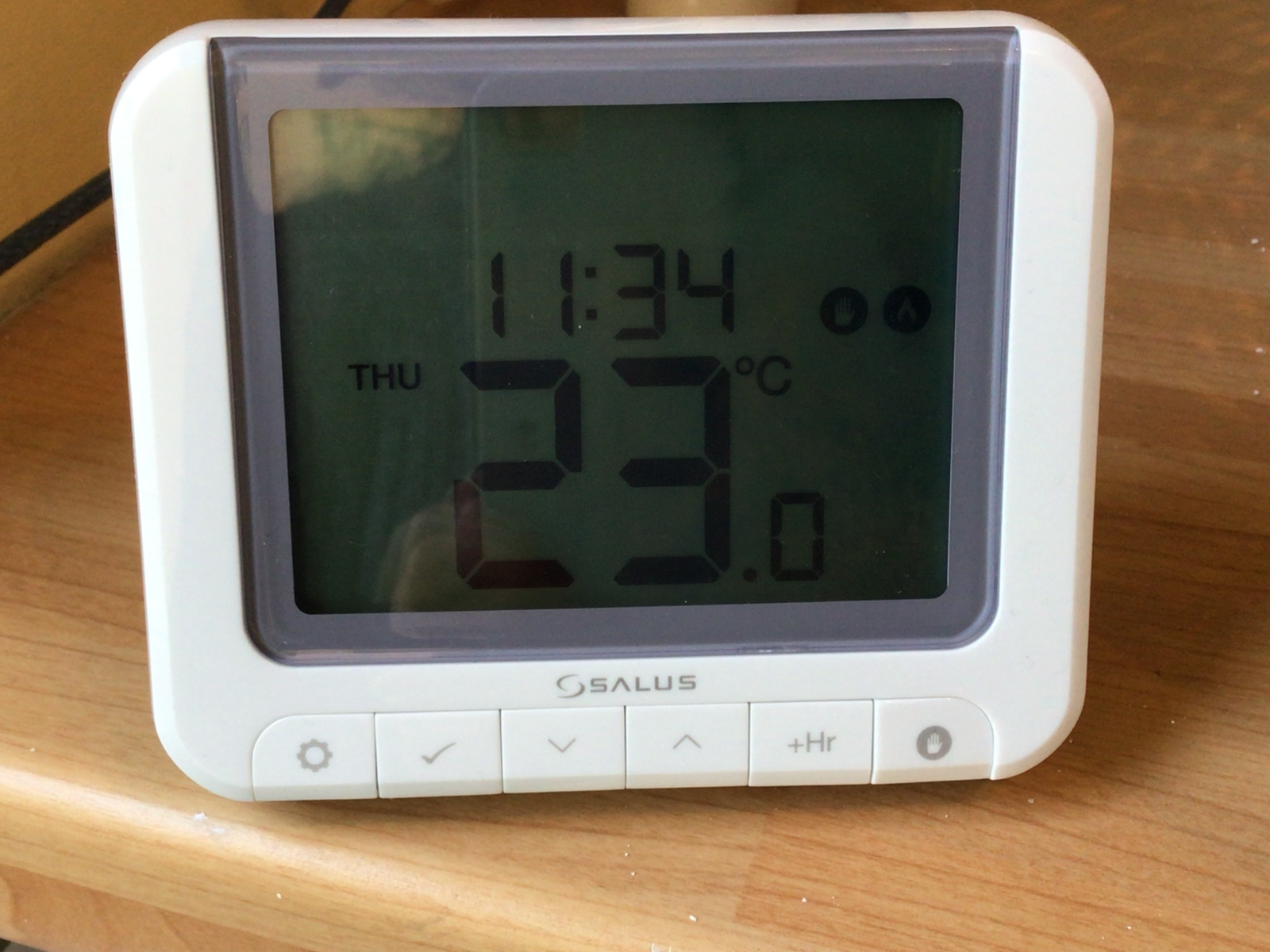

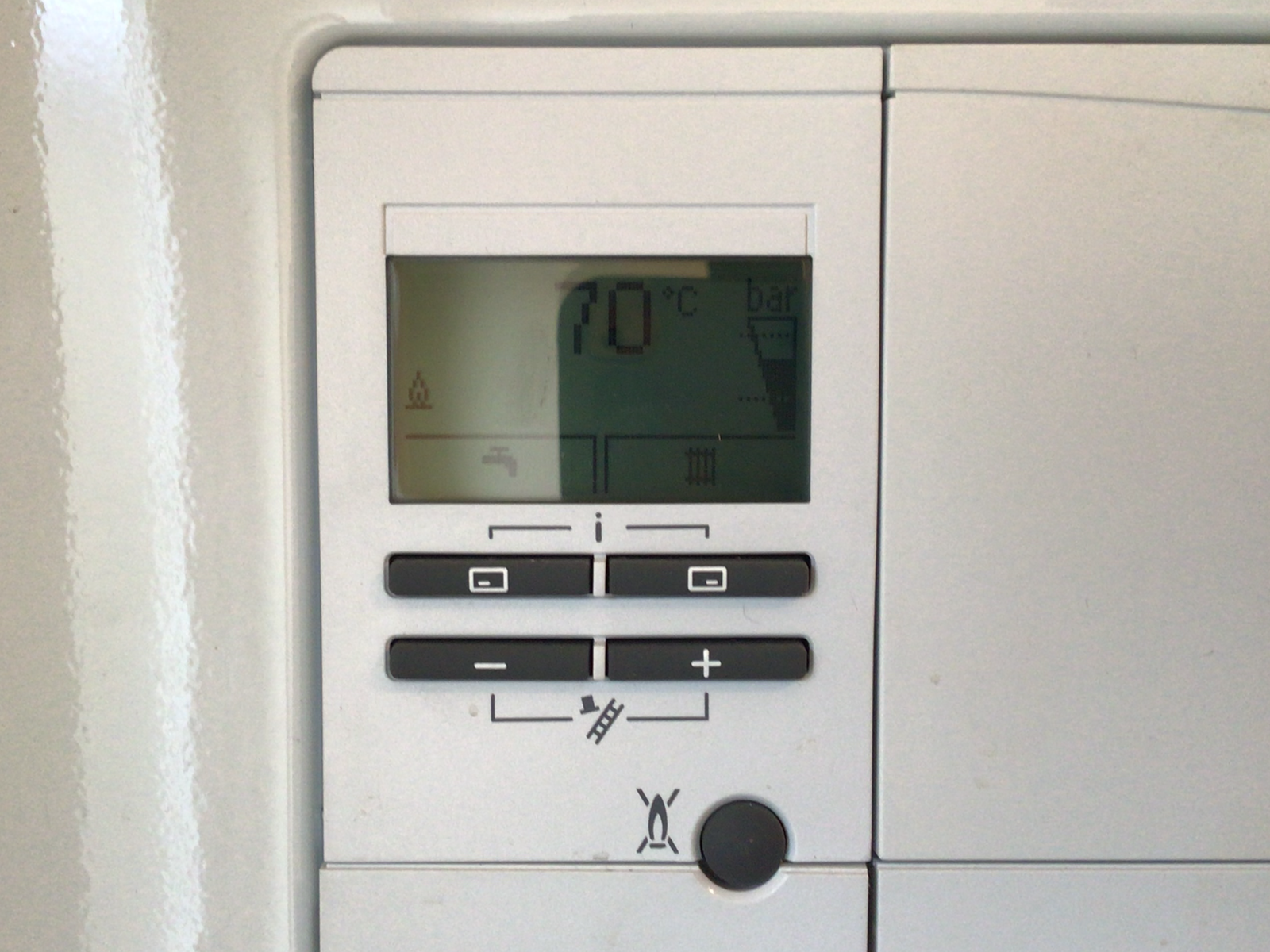

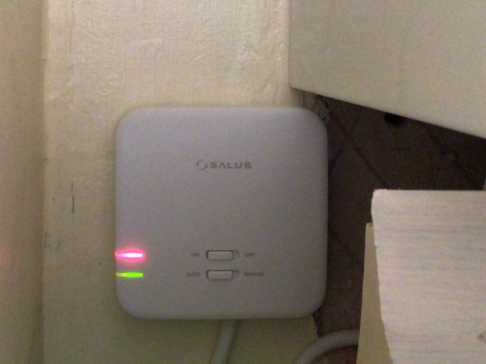

The +1 button simply brings the heating on for 1 hour when pressed if the heating is turned off, the manual button brings the heating on untill the next off period is reached, post a pic of your boiler controls and your Salus,do you have any other existing controls still installed , room thermostat, timer ?

Do you mean if I push the Manual button, the heating will stay on until tonight when it is due to go off? And the different settings for the rest of the day will not operate?
Now we have warmed up a bit, I will have another go at getting it to work automatically without the Manual button and Hand showing.
As you ask, I will see if I can attach some pics of the Salus, with Manual hand indicator on and off. And also the boiler, but we didn't think we could control the heating with the boiler itself.
nope it will stay on untill the next off period, say you had the room to reach 18deg and you press the oride button, once the room reaches the set temp it will go off and revert back to normal
