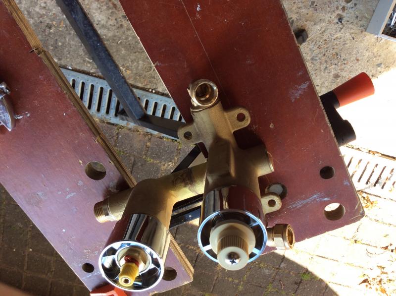

    Stupid question but how do I get these dam elbows to line up and point downwards?
    Whichever way I start the fitting it always ends up in the direction shown and not down as I need it?
    Surely it can be left loose, I'm obviously using the wrong connections
    . Help!

    Washers

    Just spoke to the plumbers merchant I got the, from, he says Ptfe to form the seal, is that good?
  5. Well putting them in without any will defiantly result in a leak.
    The skill us in enough ptfe to seal it in the correct place

    Yes PTFE tape...wind it to form a taper on the thread.
    Washers...no way.

    It's a parralel thread onto a seating face? Why wouldn't you use a washer to create the seal?
  9. Loctite55 rather than PTE tape

    YEP!! Loctite 55 is the way to go!

    Because the surfaces are not machined sufficiently flat to take a washer.
