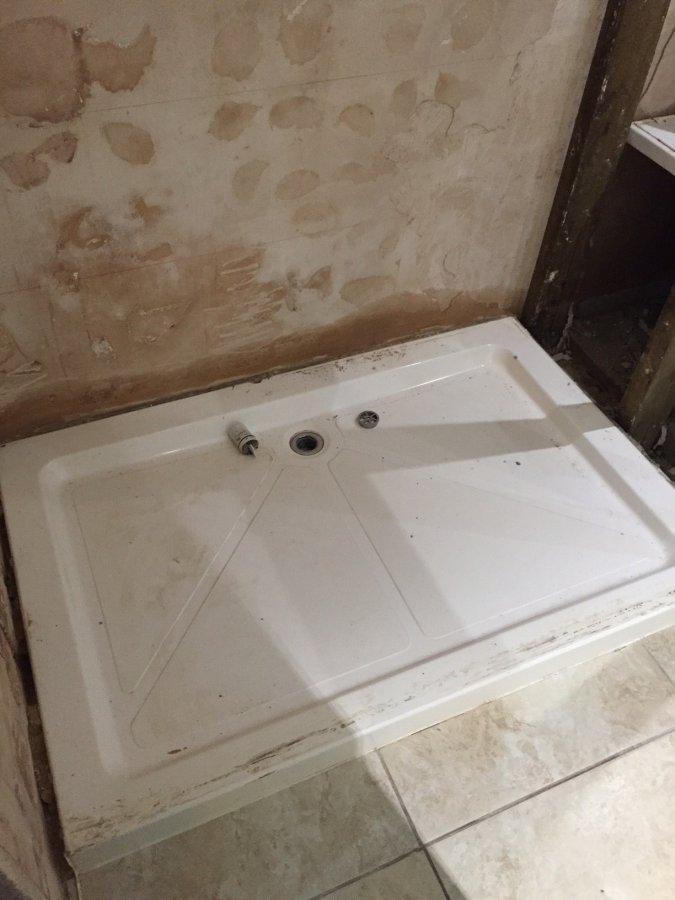

Hello all,
I wonder if anyone can advise me on the following ?
I've recently had a flood issue in the flat and the bathroom is currently stripped ready for re-tiling. Prior to this flood there was a damp wall next to the shower cubicle and I had always suspected that the grout was loose or there was a leaking pipe in the wall feeding the shower (vertical).
The bathroom has been dried out and has sat dry for a few weeks now however over the weekend and given that I could now eliminate the vertical pipe as the cause as this is now exposed and no evident leak I thought I would run some water from the bath hose (which definitely has no leak as pipes are also exposed and have been using this to shower for a few weeks) into the shower tray for an hour or so to see whether any damp reoccurs which would then point at the tray/waste piping.
This is exactly what happened and the exposed (untiled) wall is now damp again at the bottom. I did a quick test with a water bottle close up and could see some water going in the side of the drain all the way round so this definitely needs to be re-sealed.... however I'm now concerned that maybe there is a leak in the waste pipes below ??? looking down the pipe from the drain grill (when taken off) I can see water and remains at a certain level.. does the fact that this is steady and not drying out mean that I can eliminate the potential of a leaking pipe ? Are there any other tests I would be able to do ?
This is a ground floor flat by the way and no access from underneath the floor..
Many thanks in advance for any advice !
James

Hi All,
Thanks for the posts etc. muchly appreciated !
Here is a photo of the shower tray. you can see the wall which has been affected by the damp
You will see this is quite a large shower tray and is quite heavy and fixed to the ground.
The issues with attempting to lift it and inspect it are that firstly I can't seem to get twist / lift / the drain flange out prior to lifting and I'm not entirely sure how all is connected and don't want to make the matter worse basically.
I tried a small water test again last night and could see 'some' water going around the side of the drain flange cover but not too much so suprised it would cause this amount of water to collect underneath and rise the wall ?
Any thoughts ? Happy to take more pics if that helps...
Many Thanks
James

Your waste is almost certainly leaking and water is pooling at the base of that wall, then soaking up the plaster. You will have to remove the tray and re-make the waste once you have found the leaking joint. I think.
