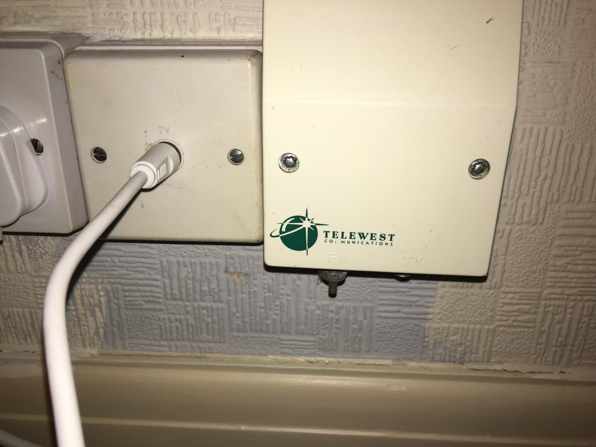

Now this is really strange. I have signal in both front and back rooms but cannot for the life of me trace it to an aerial in the loft or anywhere on the roof.
I even cut a cable in the loft that appears to go to the aerial socket in the front room - and it still works!!
Is there anything obvious I am missing? I found a very old aerial up there connected to nothing that was in real tatters.. but nothing else.
I started looking as bought a new one to update the signal for HD free use channels.. it really is perplexing!!
Is this just freeview signal from a wall coax socket? Perhaps previous owner tapped into the neighbours aerial?

You may need to do a bit of detection and elimination to work it out. An aerial needs a line of site to work, so if you can work out where you're nearest transmitter is, then using a compass, you'll know the direction the aerial should be pointing in. If you can eliminate the areas of the property that aren't in line of site, then you can narrow down it's location.
A loft aerial wouldn't normally be powerful enough to work without a booster, so have you found anything like that on your travels. And if it was cable, then you'd need a box to translate so you'd have found that.

Hi Doggit,
Thanks for the reply.
Nope, not found anything even close to that in my travels in the loft and looking at all the external cables in the house. I'd notice a powered booster too from the smart energy meter and so been able to discount that too.
I can see two more modern coax (brown) aerial cables in the loft but I cut that straight through yet they both still work.
The only reasonable explanation I can see so far is that either as above its piggy backed onto the neighbours.
Or there is a tele west box in the rear sitting room which appears to be connected to the coax box (I need a star shaped tool to open it up - as per pic)

You may well have solved the problem; a quick check on Telewest shows it's a cable provider, so if you take out the screws to the coax box, you may see the cable going into the Telewest box.
No need to apologise; it's always interesting looking at different scenarios. And best of luck with the project; unfortunately, it'll always get worse before it gets better - just keep the wine glass well topped up.
It does indeed. So both rooms are connected via the telewest box through the floor void I am guessing.
Shame as in the front room HD channels are available but the rear room struggles with even standard itv and channel four let alone HD.
Thoughts as to the quality differential?

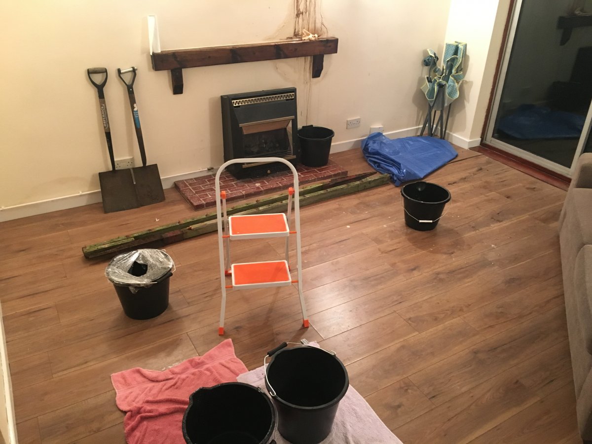

Oh trust me the aerial is all but one minor problem to keep the grey cells working. Today's issue... a leaky flat roof.. in many places...
Use a bitumen sealing paint for now, and then go for fibreglass in the summer.
Great idea mate Problem is it's about 25m2.
Builder is due in May. Was planning to lay a 1200 gauge DPM sheet on top of the currently laid Tarp.. if I only knew what I knew then now :-/
That shouldn't be a problem at all; the good thing about fibreglass, is that you can just keep working across the roof in sections. It's a progression system rather than get it all done in one go type. If you've got a few dry days, you'll strip off the existing roof, repair the decking. lay down osb, set up the edges, glue down the fibreglass, and then do the top coats. Check out eBay for some pretty good videos, and you'll get an idea of what's involved.
