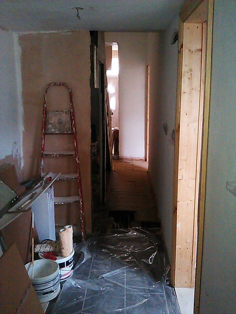

Building control have informed me I need to install a fire door between the hallway and the area in between that and the kitchen.
However, I've only got 76cm between the wall and the wooden upright (which seems to support the stairs) on the left once I removed the old bit of panelling.
You can't really see the upright in the picture but it finishes at the same point as the plasterboard.
Is it possible to get fire door liner kits and doors small enough to fit in this gap?
Thanks in advance.
Just make your own frame up with some 32mm softwood. You could add some panelling to make it look like a panelled door but only after your BCO has signed the job off. Technically you would be harming the fire door and consequently your insurance would likely be invalidated too should the unthinkable happen.

There won't be any need for a closer. The strips are not mandatory I believe if the OP were for example having a frame/door assembly supplied however when the door/frame is being put together like this I would expect the BCO to insist on the strips.
