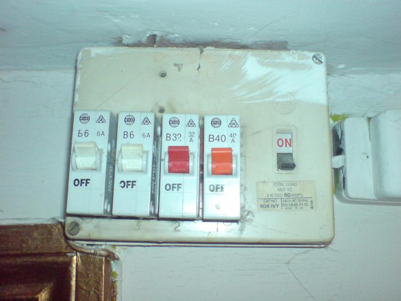

a photo of the front of the oven, a photo of the connections in the socket you refitted, a photo of the fuse board ( large and clear please ).

Fuse Box

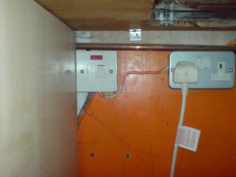

The CCU - lovingly positioned behind the dishwasher for all our emergency needs - the light is on and it switches on and off fine.

That looks like an FCU (Fused connection unit) with a wire seeming to go to the metalclad double socket outlet with the oven plugged into that.
Does the FCU feed the double socket, if so does the socket work with something else plugged in.
Just because the light is on on the FCU does not mean that it is wired up correctly or that wires have not been pulled out. (I have seen some FCU's with neons wired up so the neon lights even when no fuse is present)
Yes you’re right - it is a FCU. It does feed the double socket - but that's only got the dishwasher plugged into it which works fine. So the thick cable coming out the bottom must be for the oven and just at the top of the FCU between it and the copper pipe you can see a tiny bit of black cable coming out - which is for the hob ignition which also works currently.
