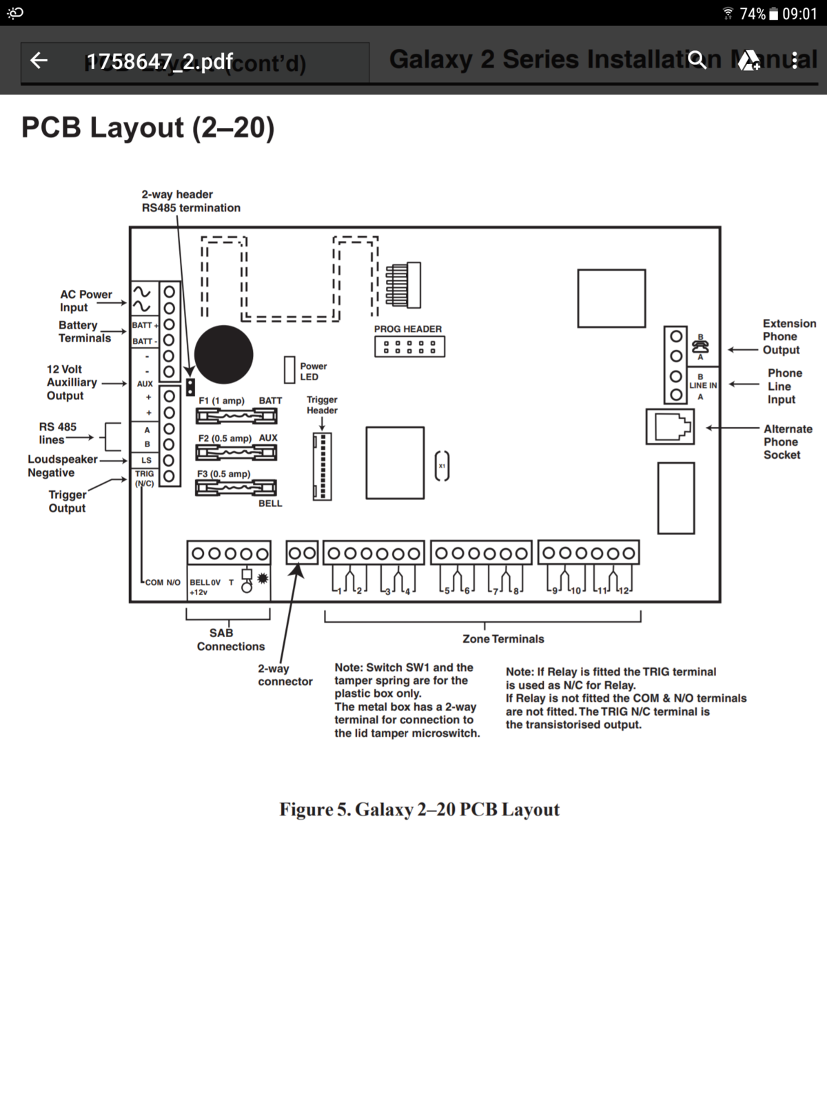

I have an sd1 on my old alarm it had 3 out pa-intruder-fire but what would I connect to on galaxy 2-20 pcb thanks
The galaxy has outputs for PA,INTRUDER.You could also use the bell trigger as well to connect the SD1 to.
You can us the bell trigger output to connect the dialler for INTRUDER.
If you require a PA trip then you need to use an output.
On the 2-20 you will use the trigger header.This will require a ribbon connector for you to use the outputs to trigger the dialler .
If you are using a Rio for zone expansion then you could us the outputs on the Rio expander to trigger the dialler

handmanjo is it the trigger output or the bell sab if it's the bell which one the - or + thanks
It's neither the bell + or - as they are the supply. It's the output that has the picture of the bell that's the bell trigger.
