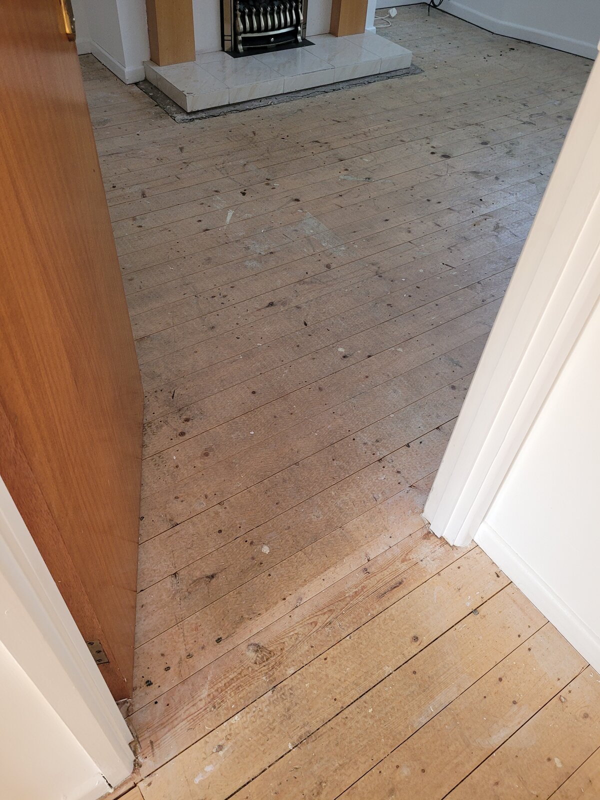

Hi I am sure this has been asked 1000 times. I have bought a house and have squeeky and creeky floor boards. Really loud. I need to get it sorted before the carpets fitters get in. Any tricks or tips?
What type of floor? Many repairs? Condition of floor?
timber tongue and groove not sure how many repairs as just bought the bungalow. First thing that struck me when we viewed was how good the floorboards looked. We where close to sanding and varnishing. But decided to carpet instead

Screws every time. Pulls the boards down tight plus easier then if taking boards up in future.
Make sure no cables or pipes below where you want to fasten board!

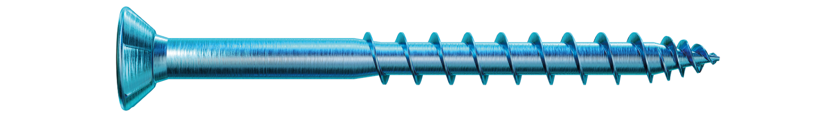

The best solution is to screw them down properly with the right type and number of screws pulled up tightly. A good, if expensive, screw for this type of work is the Floor-Tite, as sold by places such as Toolstation. Even then there might still the possibility of some creaks if, for example, the sole plate of a wall has been nailed down onto a joist, but the nail has just grazed the joist because it was wrongly driven. Talcum powder doesn't do much - it's an old wive's tale - stopping movement by properly fixing is more likely to achieve a result
