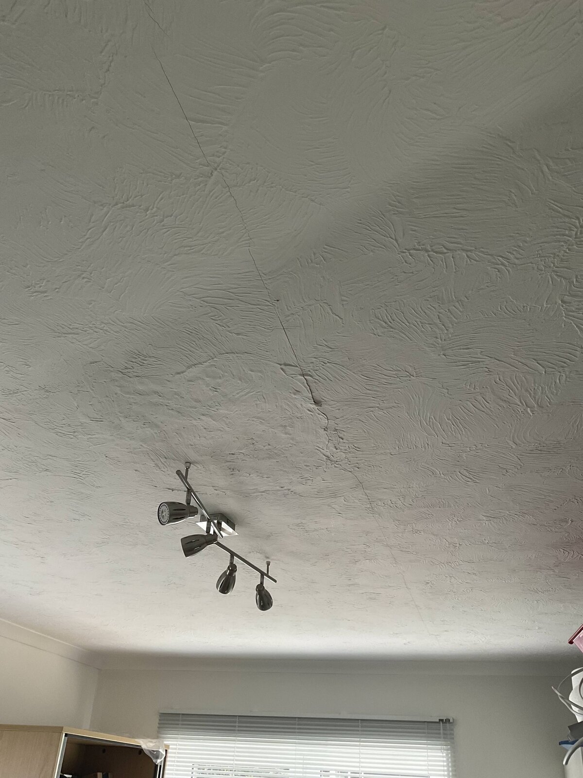

I've got this crack. In my ceiling. Should I be worried?
The crack is along the line of plasterboard. There is a lightweight block wall in the room above, about 200mm to the right of that crack. The wall is supported by the floor joists above which run 90 degrees to that wall ie. left to right in the picture below.
I've been in the house 10 years and the house is 50 years old. The crack has changed little in the ten years I've been here. But, it's time to decorate this room. So, should I do something about it, or just leave it?
Oh yes, that wall also takes "some" roof loads down it as well. I replaced all the clay tiles with slate a few years ago.
Any thoughts?
(Bonus points for the first person to say you need to get a structural engineer in).
Given that it's randomly messy artex with a central blobby feature centre where I guess a 1980s rose has been removed, I'd say it's not worth caring about.
Unless you're going to get rid of the artex, in which case find the joists and screw the plasterboard up firm either side of it before skimming it. Mesh scrim tape across it would be a good idea too.

Thanks for the reply. I'll probably board it over rather than remove the artex.
I was also wondering about structural issues.

Just overboard as you suggest and hide the artex at the same time - and forget about it.

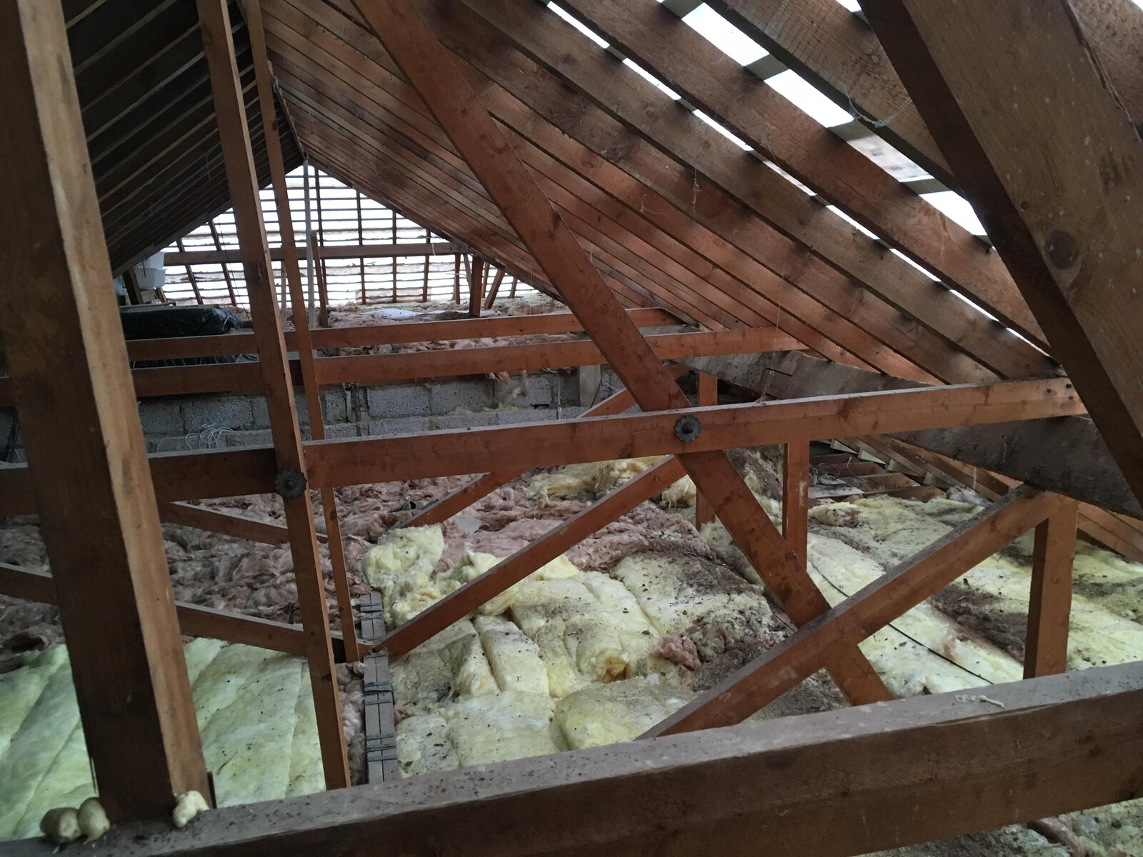

Has there been any building work that has altered the construction since it was built.
The only building work that could have affected it is when I replaced all the roof tiles with slates. So the roof was unloaded then reloaded again. I'm pretty sure the crack had started to form before that though.
Here's a picture of when the tiles were off. The relevant part is right at the far and of the photo and you can't really see it but you get an idea of how the roof is constructed. The horizontal timber in the middle foreground, in the insulation, is similar to what I'm talking about. I don't think there's a huge amount of load going down there though. Maybe more just for bracing?

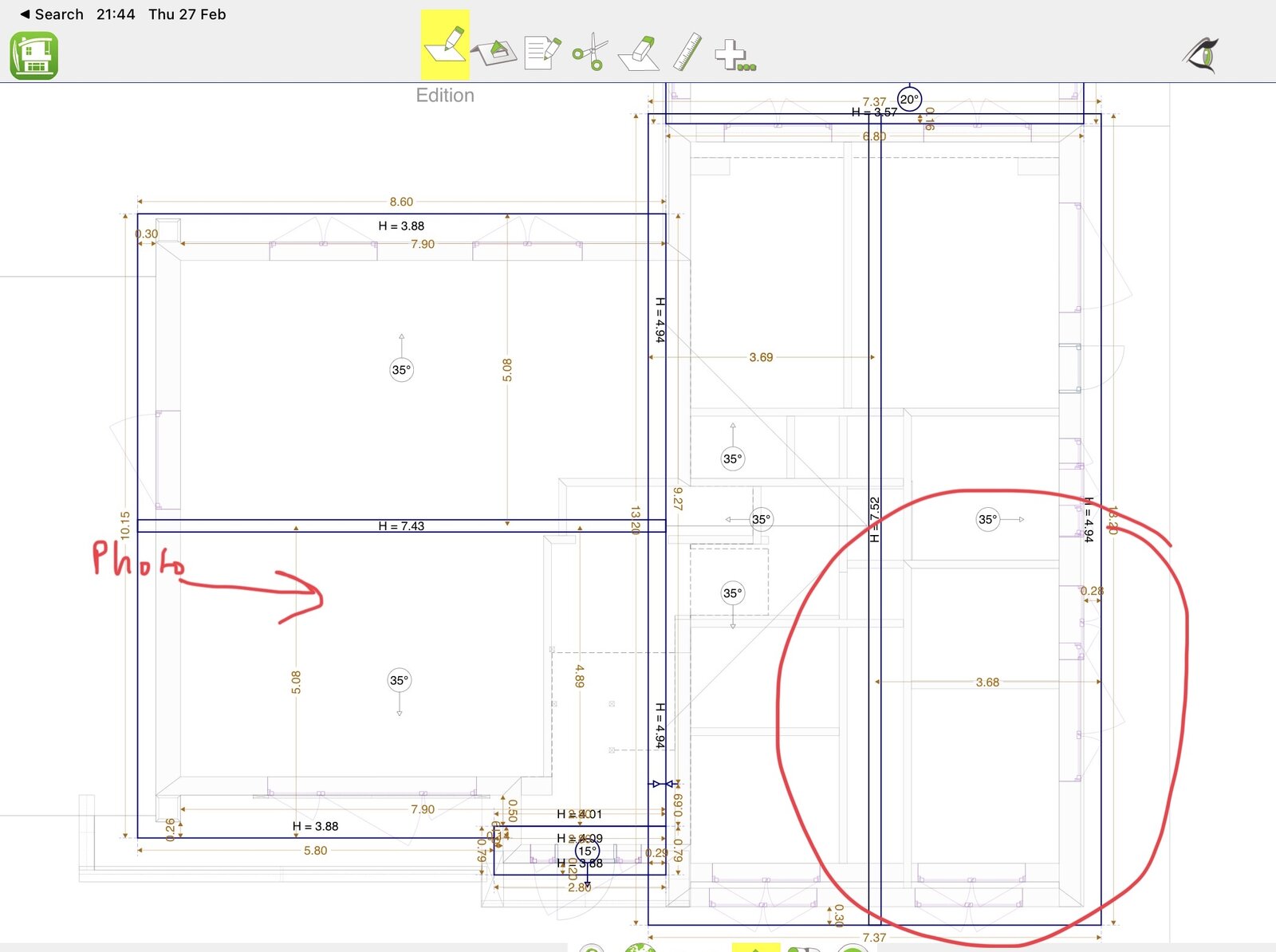

Here is a plan of the roof showing the direction the photo was taken. The room, which is below this area but on the ground floor, is in the circled area.
The second picture is the first floor with the lightweight block wall circled in red. Floor joist direction in blue dashed.
The third picture is the ground floor room with the ceiling crack shown in dashed green.
If the room with the cracked ceiling is not directly beneath the roof, the roof is less likely to be the cause, unless it was bearing on an internal wall, that was supported only by the cracked ceiling.
I wonder if the joists of the first floor (the cracked ceiling) are too long or too thin? Can you measure them? Can you measure the deflection?
The timbers of the roof itself look to my unskilled eye to be quite generously proportioned, although I don't see ironwork in tension that I have seen in comparable roofs.
