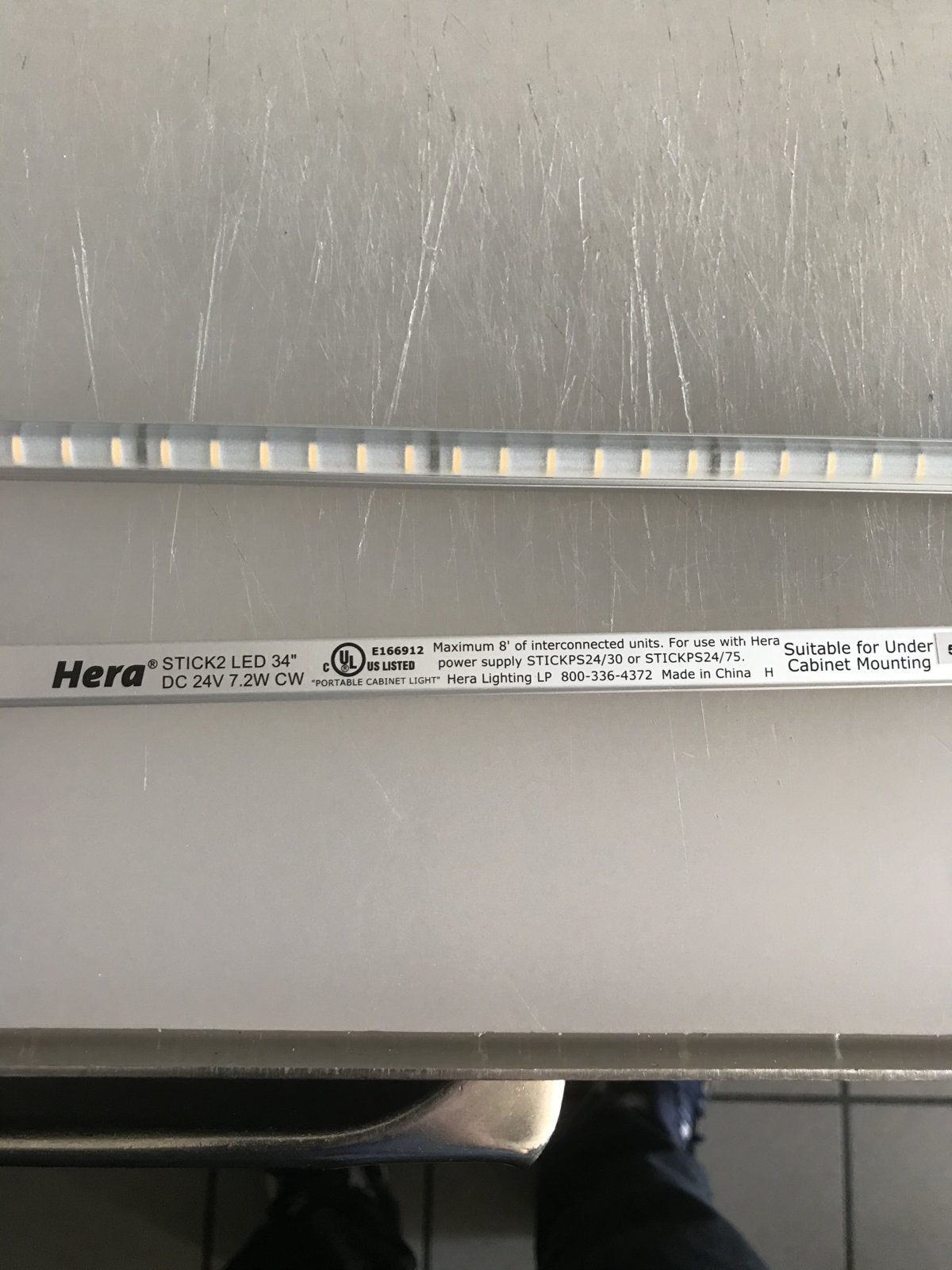

I have these striplights under my kitchen unit and they’ve recently stopped working. I’ve been doing some troubleshooting and can share the following:
- I’ve used each of the 3 interconnected lights individually and none of the work. I found this strange...
- there is AC power detected by my 2 pole tester at the connector that slots into the strip lights
- the power will appear/disappear when flicking the switch
- there is also power at the mains cable leading to - I assume a driver - the driver is inaccessible
I could purchase a new strip light and try this but I find it very odd that none of the three interconnected lights work when used separately.
is the issue possibly with the driver but this still means that voltage is detected by the 2 pole tester?

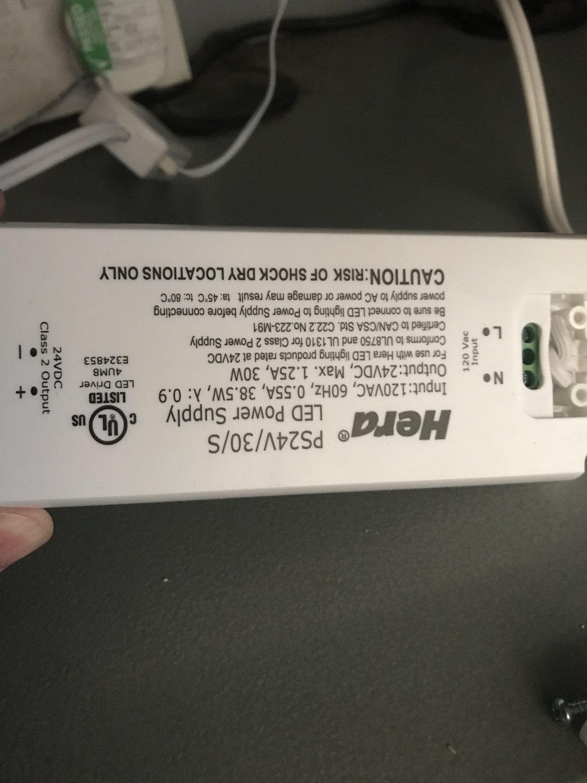

UPDATE: got to the driver. 240v is going into one side and nothing is coming out of he other end. It just lights up the AC light on my tester. There is no associated voltage reading.
On a different cabinet and it’s driver, I am getting a reading of 24v on the same end of the driver. Also if I swap the drivers, the affected lights start working.
I am tempted to conclude that the driver needs to be replaced?
Here’s a pic of the driver.
Also, why is the continuity light activated when I apply the test probes to these two probes and the switch is flicked off? I thought continuity is when I have a probe on either end of the same wire. That shouldn’t be the case when I am touching one of the probes on live and another on negative?
