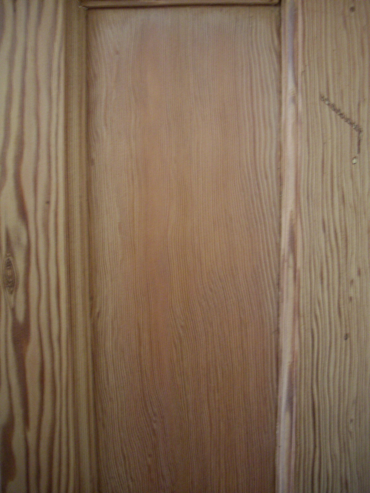

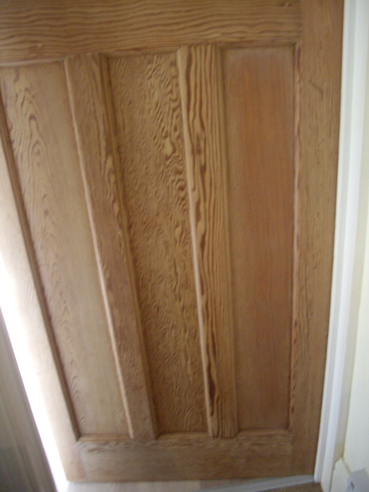

After stripping several layers of varnish from the wood and sanding down (rough-to-smooth) the door is almost ready for a new coat of varnish.
But, as you can see, on the bottom left panel a patch of 'something' refuses to budge, despite an industrial level of abuse and cutting edge sarcasm i can't shift it.
What could do the job?

If you mean the other left.. I'm wondering whether it's somehow been less sun faded. The grain in that middle panel is just gorgeous btw
It almost looks like different wood.
I have seen something similar happen if you sand with too fine a grade of paper at too fast a speed with a rotary sander.
Perhaps you could try to sand it using an orbital or random orbital sander and 80 or 100 grit paper.
Less sun is a possibility but the substance has a waxy feel to it - perhaps an attempt at staining it?
The original varnish was put down in the '30s so i've no idea what kind of shellacking they gave it.
The grain is my primary reason for slaving over this wood for the past six weeks. I love the random waves and lines and different colours, even textures. I really wanted to put a layer of varnish on this weekend but until i can shift this weird brown patch i'll have to be patient.
I have a soft copper brush and will consider using it - gently! - on the grain tomorrow, perhaps with a dip of white spirit.

Sanding down was the first option, rough 60 to smooth 240, which worked well on the rest of the door but hasn't really done much of anything on this stubborn panel.
I'm reluctant to use a 'nuclear' option as my new bathroom floor would never forgive me - and remind me daily - if i erred.
And after a morning of endeavour i can see no real difference in the panel. It may be a tad lighter but that could just be wishful thinking. Any further sanding will certainly render the wood thinner - i can already feel a faint ridge along the grain where i've had to work harder so i think i'll just have to let it be.
Thanks again for your help.:)

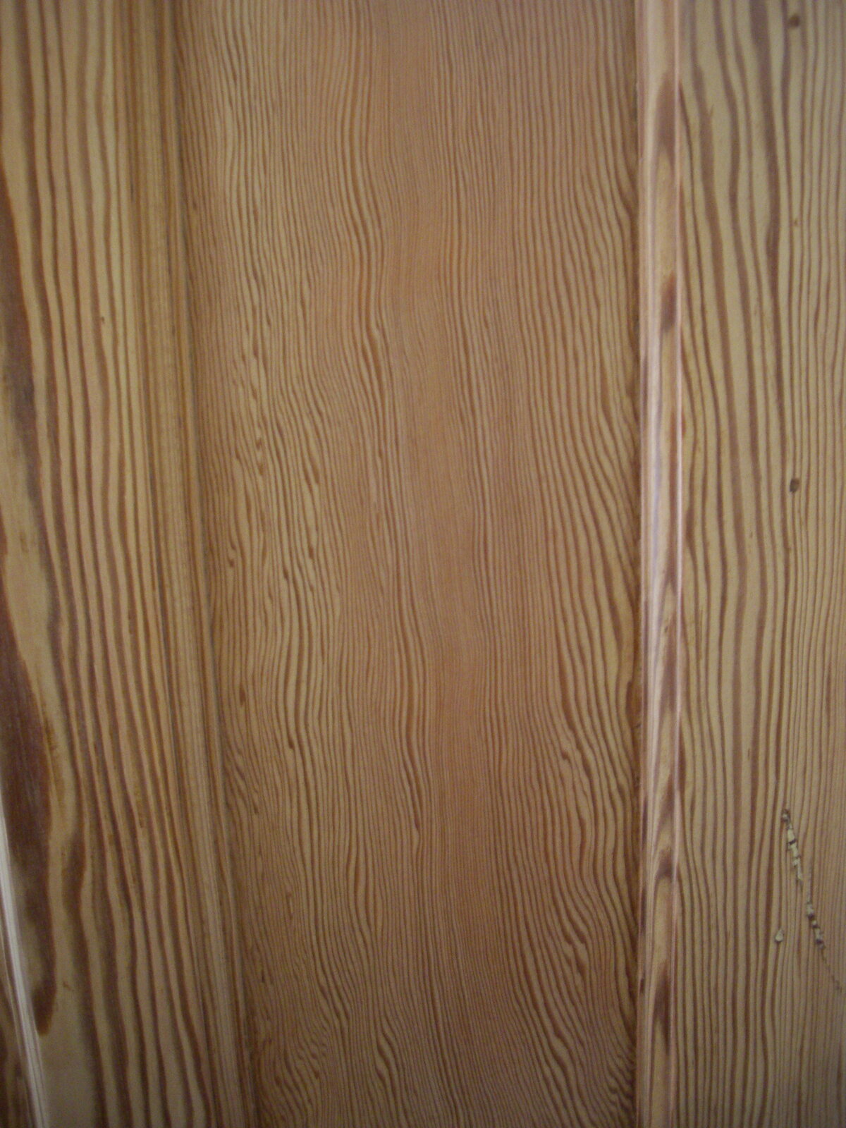

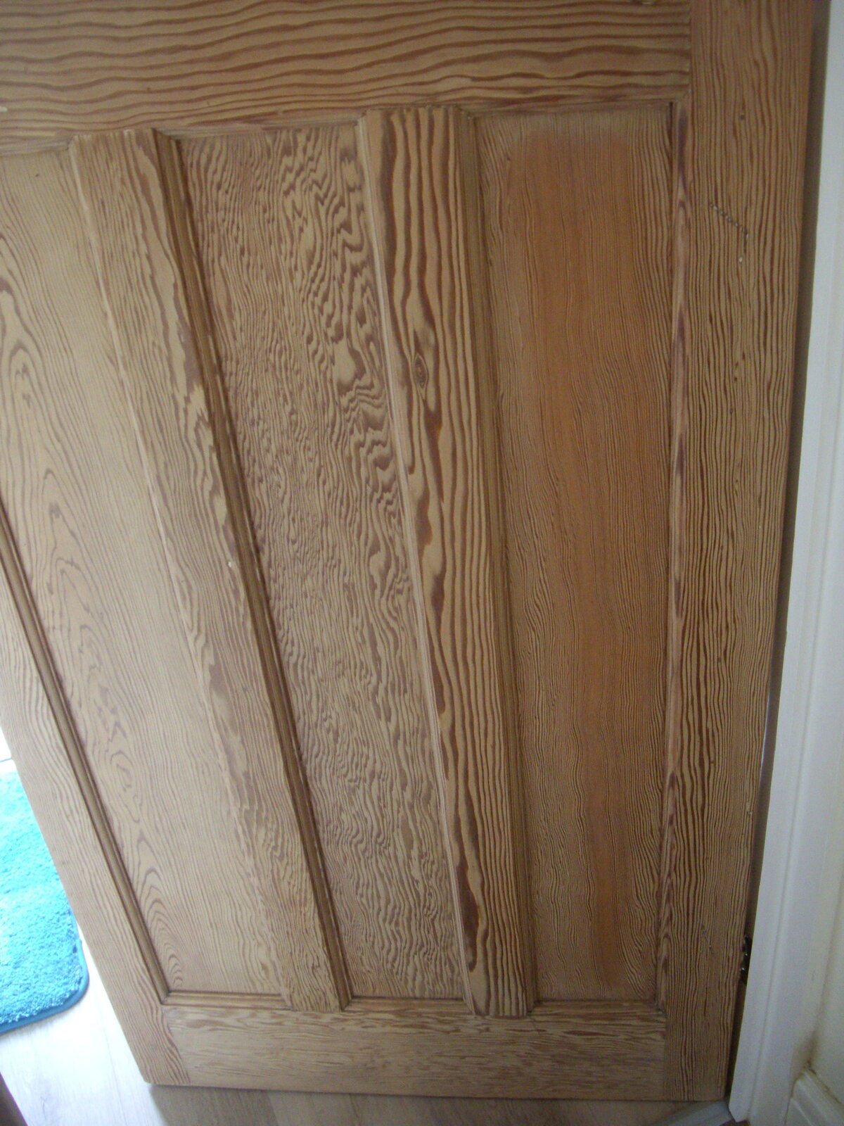

Update*
After giving it one more go with wire wool and clean spirit i managed to fetch a good deal more out of the grain and after going over it again with a dry rub i think i might be getting somewhere.
