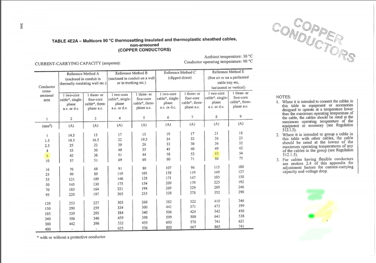

Hi
I need to put a 63A RCB 6 way weatherproof consumer unit ( Garage unit ) with 2x6A , 2x20A , 1x32A MCB's, in my workshop at my farm , now the supply to it, comes from the Main 83A 3 phase fuse box on the other side of the wall where I want to mount this unit , the length of cable would be around 500mm max .
Question , with it being such a short length of cable for the feed could I use a 6mm2 cable ! , as I have loads of it, but no 10mm2 .
cheers
spike

Sorry yes I mean RCD , I understood that the 63A RCD is to take the full load of the MCB's it supplies , however it also protects the cable feeding it from its source , no! , there will never be a time that all the MCB's will be on full load .
I could use 2x16A instead of the 20A and use a 20A instead of the 32A ! .
Attached BS7671

So, the supply cable is only protected by the 83A ? fuse.
10mm² is not technically big enough.
If it's normal PVC t&e then the insulation won't handle 90c.
I think first you need to know your load, if you down rate the MCB you have to be sure you won't leave yourself with a small overload.
If it's only half a metre, it's only going to be a small percentage of your overall cost to use 16mm2 tails.
The length doesn't matter, if a 50cm cable or a 50m cable is overloaded it'll still melt the insulation and short.
Table 4D5 is for normal twin and earth.

OK , guys got it now , will get some 16mm tails , and a 100A RCD and use the MCB's that I first was going to use .

Have changed the Main supply fuse feeding the 63A RCD from 83A to a Lawson 63A ,( this is off the Yellow phase , house is off the Red phase ) and used a 10mm2 cable to supply the 63A RCD , yes I know I really should put in 16mm2 tails ! , needed it doing today
