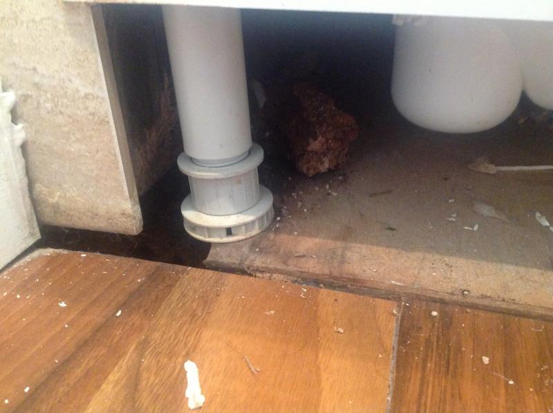

Hi all,
I've recently bought a house. I noticed the shower tray in the em suite had dropped a fraction tearing the seal. I took of the facia to have a look and see if I could adjust one of the riser legs. I've found that the shower tray legs are supported on what appears to be some half nice chip board, with a hold cut out for the pipe work. Ok not a massive surprise.

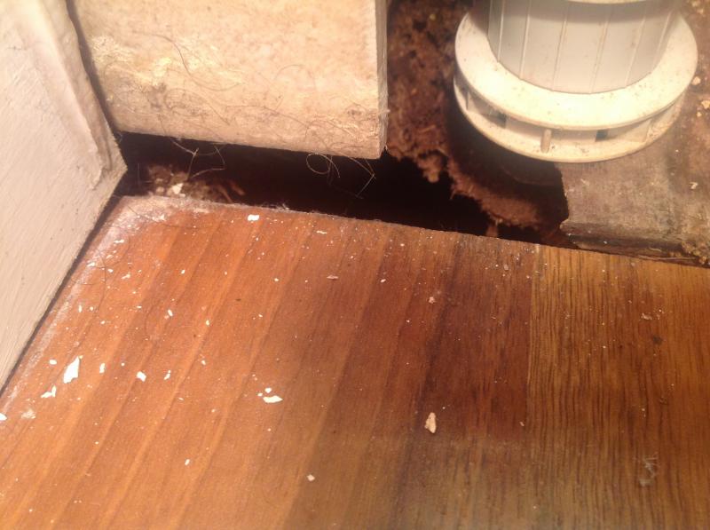

However what was a surprise to me is what's under the board, nothing. The cause of the drop was that one corner of the wood had flexed and now wet just snapped/rotted away.
This lets me see down into empty space, the space between this floor and the living room below. Now that doesn't sound great to me!
What's the drill in this situation? How do you go about dealing with this? And what can I expect to pay a friendly local tradesman for it?

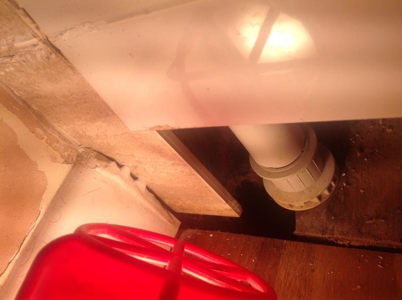

Probably the easiest way if you can wind up the legs then slide some lengths of say 4x1 underneath then adjust the legs down again, this will hopefully bridge any rotted chipboard
Chip board flooring isn't the best material for underneath showers. Many tray manufacturers recommend replacing the floor underneath the tray with plywood. If there are no noggins or joists to support the floor underneath in the problem area, then your tray needs to come out, and the floor repaired properly.
It might be more feasible and cheaper to access the area through the ceiling below, add a baton to support the problem area then slide in some ply or timber under the legs from above.
The tray feels fairly sturdy it's just the lack of support under this fourth leg so I am presuming that the board in those corners is resting on some sort of brick work.
I couldn't really get an angle to show that there is nothing beneath the problem riser leg.
You`re a one , Andy - that`s not hair it`s the fibreglass mat :idea: The works Reliant Van was like that all over the inside :mrgreen:
Hahah the misses has been away for about a week so a lot of the trappings of the modern world go out of the window, like cleaning! Alternately, yup that's fibre glass :)
