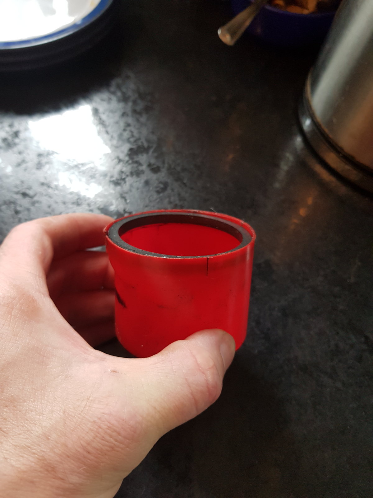

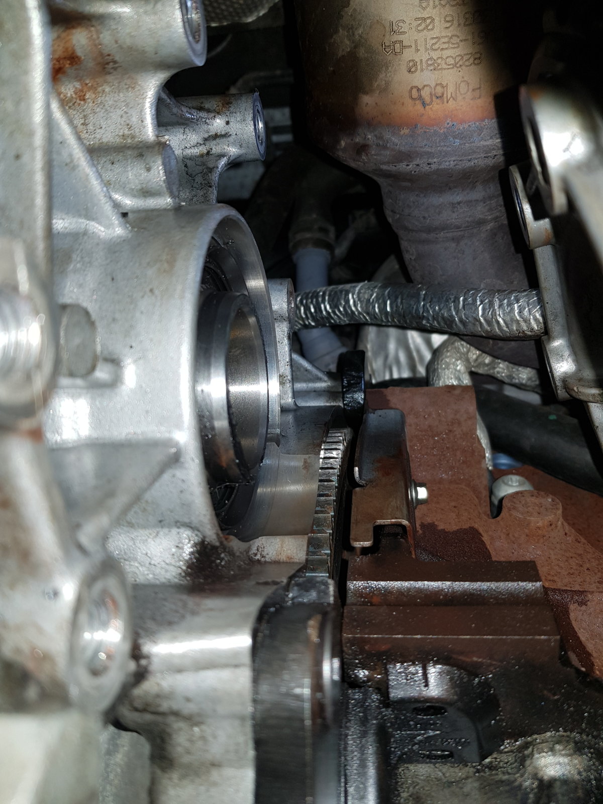

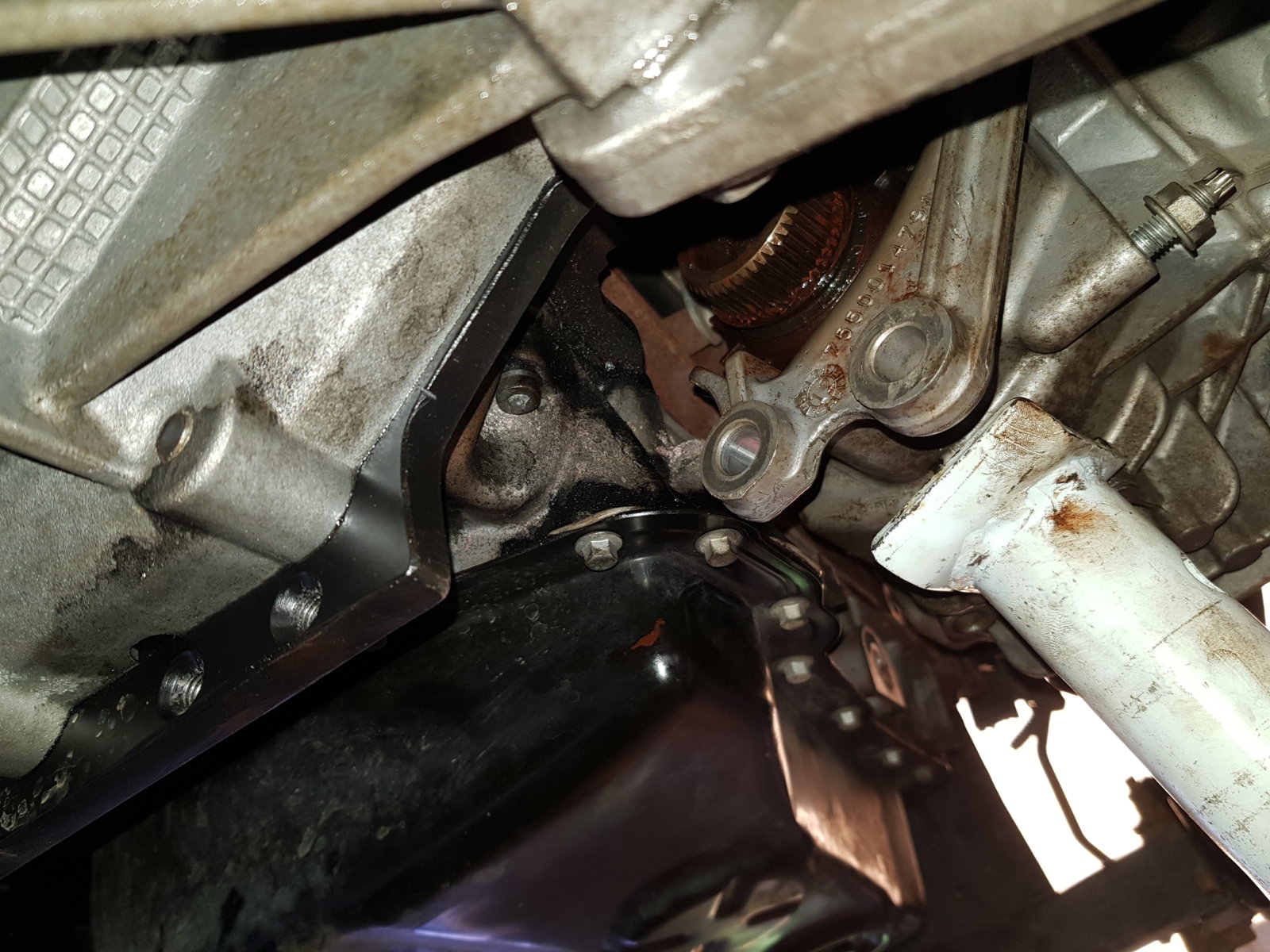

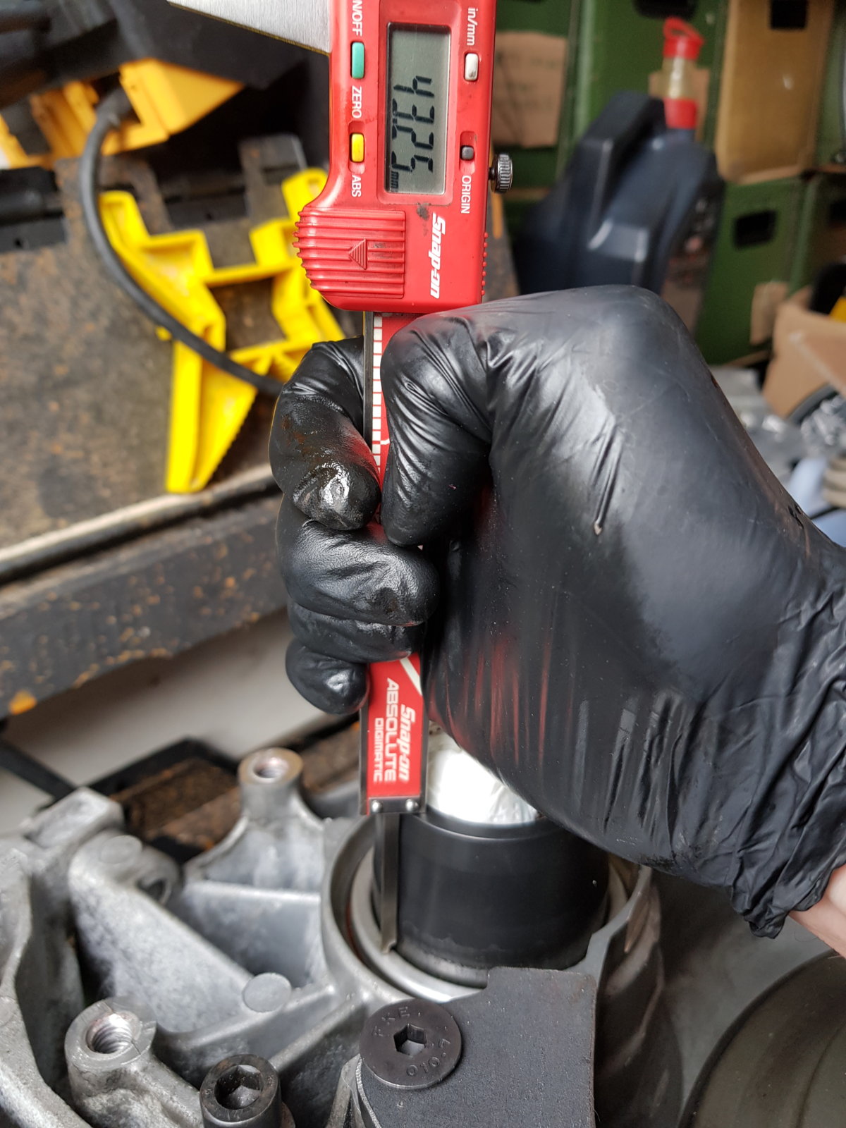

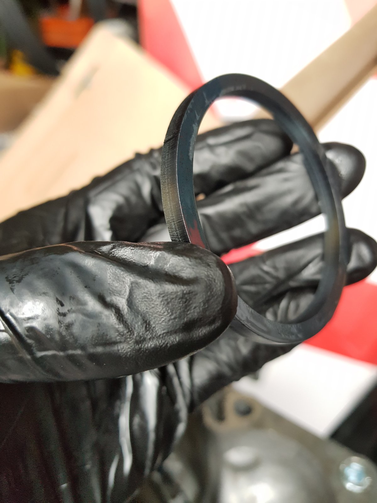

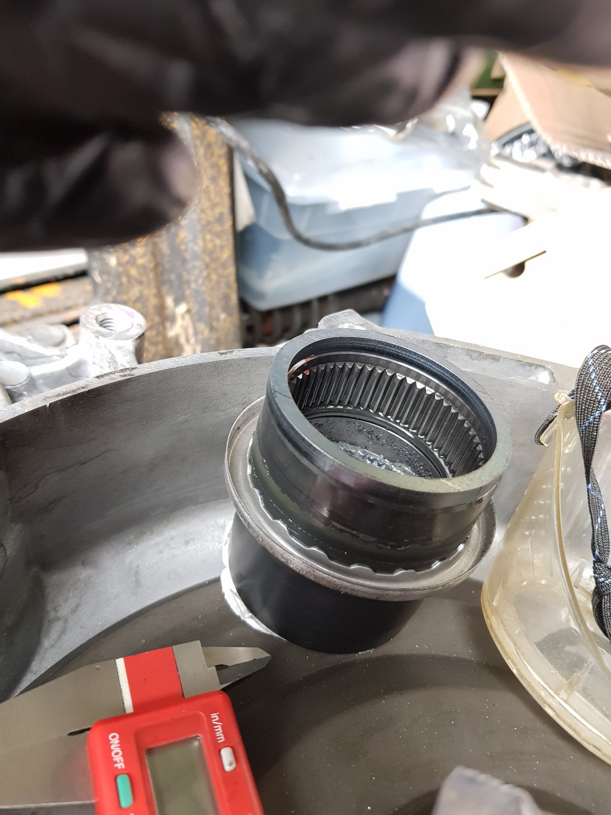

Well, we have done a fair few thousand trouble free miles then we had a random oil leak a few weeks back...
I had a custom spacer machined to space the AWD transfer coupler out 5mm when I fist fitted the gearbox and it "popped" in past the oil seal, nice and snug.
Thing is the coupler has an internal O ring and it was "just" too far out, I'd used a smear of Three Bond sealant and that had lasted so long then we had the weep..

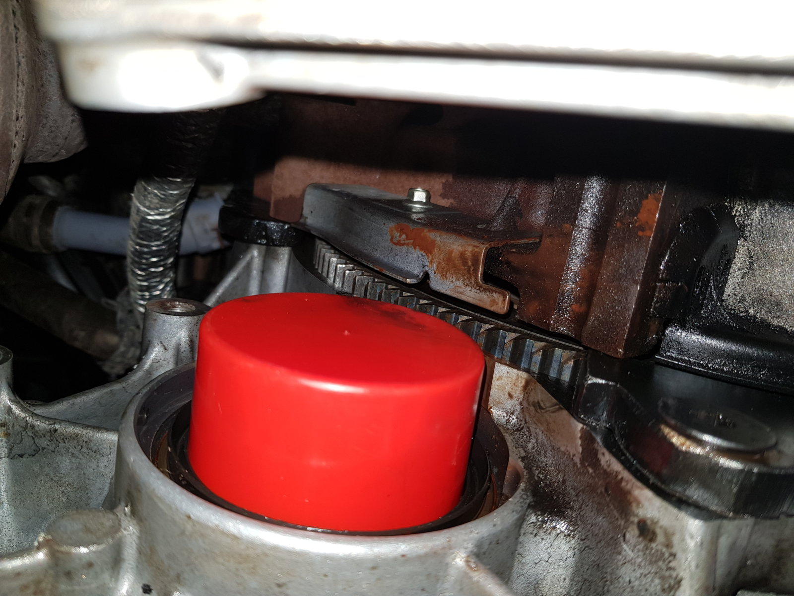

Soooo, laid under the car with transfer case as far out as I could move it I had to try and get this bloody spacer ring back out!. Spent 2 hours on Sunday then called it a day at 8pm got no where with various picks and didn't want to wreck the seal.
Had an idea on Sunday night to try and use an aerosol cap to try and stretch the seal slightly and grab the spacer ring, that would then slide out inside the cap.
First attempt failed on Monday morning but second time was a success!, I genuinely could have cried at that point..
Anyway I managed to refit the coupler with new O ring and reposition the AWD transfer case to take up the difference.
Glad to say all went well and been two weeks now leak free!.
I must admit I did question spacing the coupler out at the time but had to get the car back on the road asap so went with it (hindsight is a wonderful thing).

For our car this coupler spacer was the only question mark, managed to remove it and re-shim the PTU so confident now it's good for a long while to come.
It drives great, just a shame I had to put so much time into it.

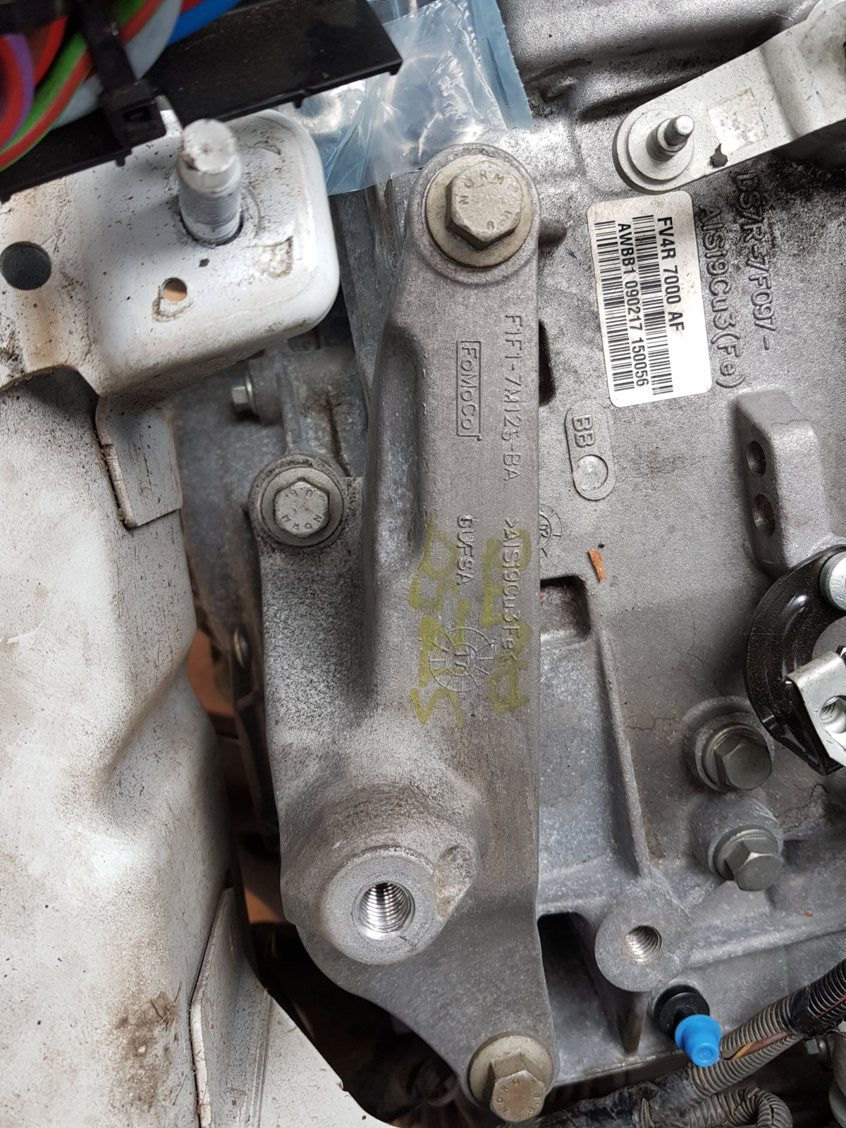

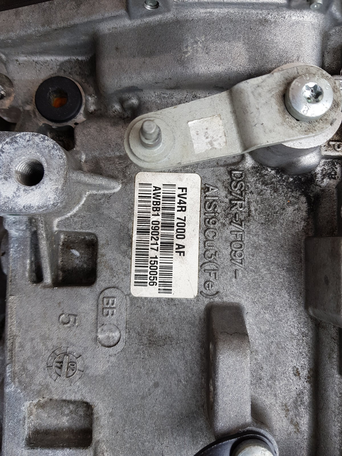

Hi Keithmac, I wondered if I could pick your brain as you seem to know far more about these transmissions than the dealers do! From your research, do you know when Ford introduced the improved 6DCT450 like the 2017 one you fitted? I’m potentially looking at a 2015 Mondeo which has covered around 100k miles. It has the history to show the fluid changes have been completed but I think if it has the same 6DCT450 box as your original 2013 version I’ll leave it; I don’t mind tinkering with cars but I lack your skills and confidence to remove and strip a transmission! Thanks in advance for any info.
I've had a good look at the Kugas and it seems when they went over to the 2l Diesel 180bhp engine they started fitting the new generation Powershift.
On the Kuga it is labelled as FV4R 7000, I don't know if the Mondeo took the same code as the Kuga Powershifts are all AWD.
What engine has it got?, if it's 163 it's definitely the older gearbox (avoid like the plague!).
The casing is nigh on identical from the outside although the later gearbox has only 3 bolts holding the mount (early gearbox has 4).
