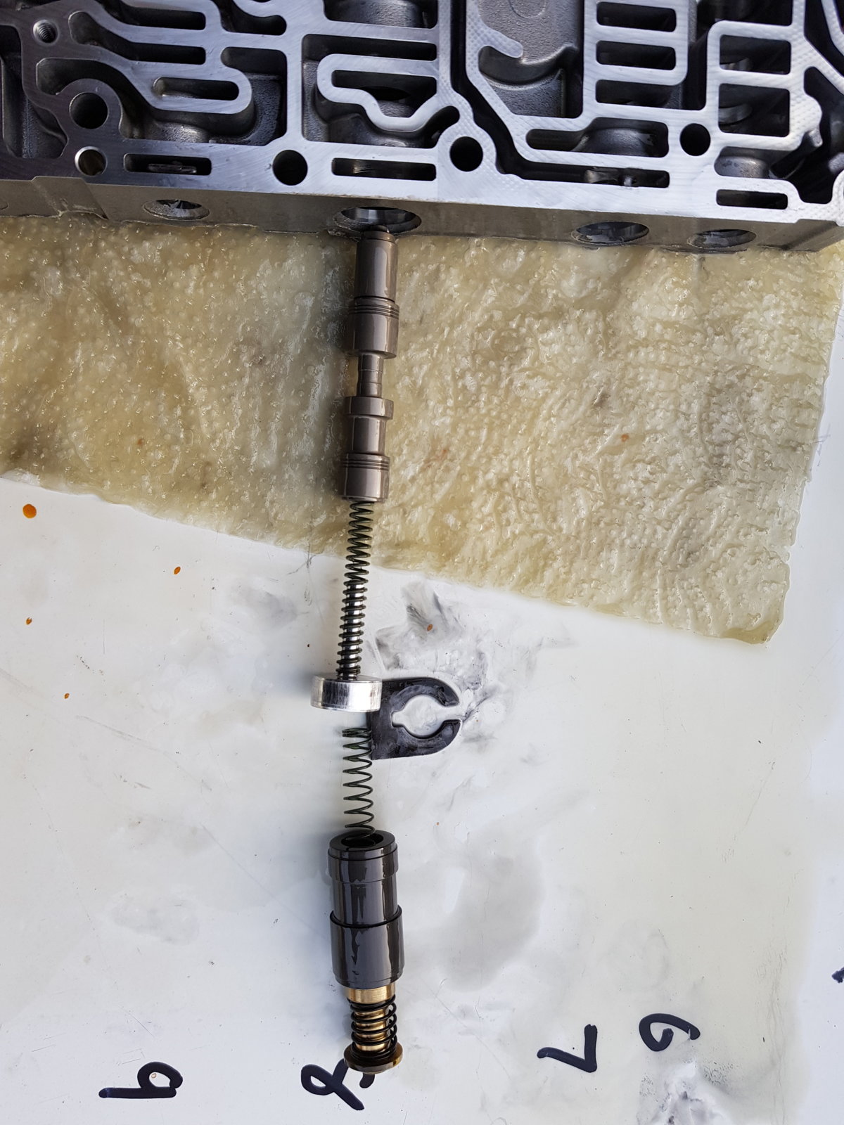

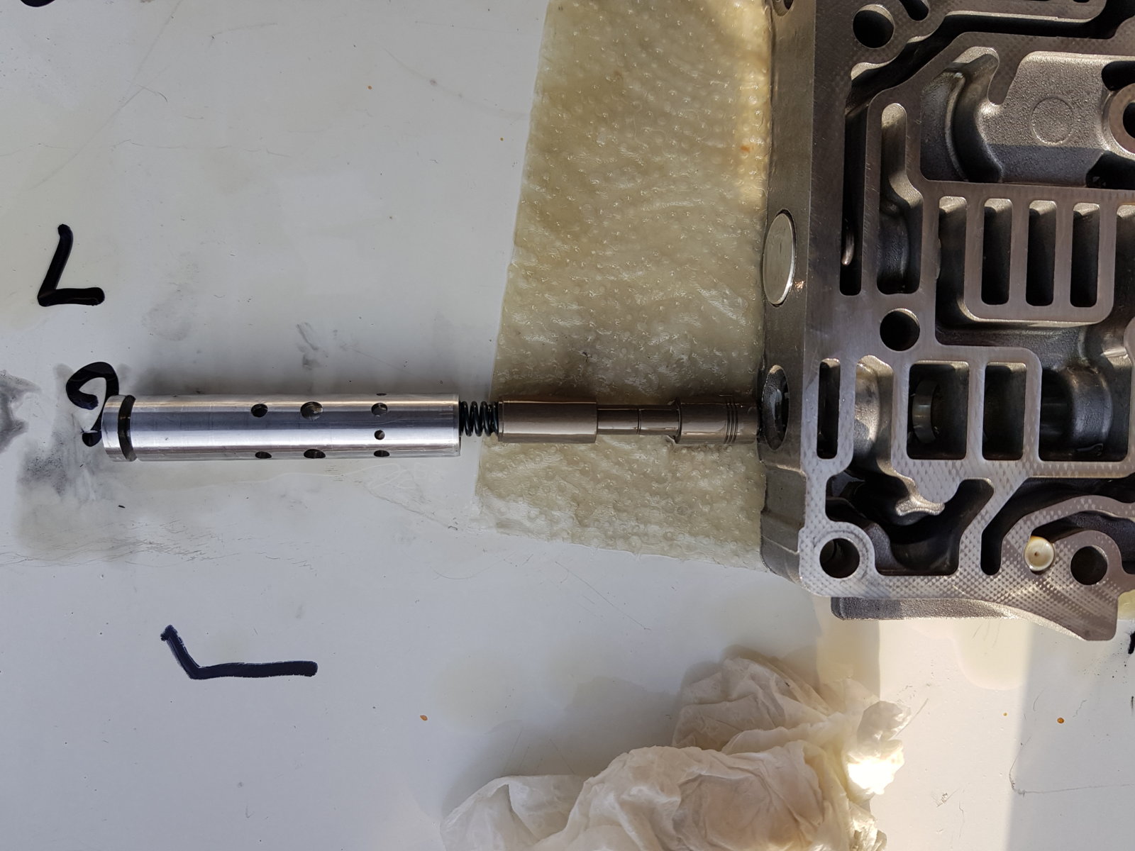

This was interesting, two spring pistons inside a sleeve with a sprung damper on the end!.

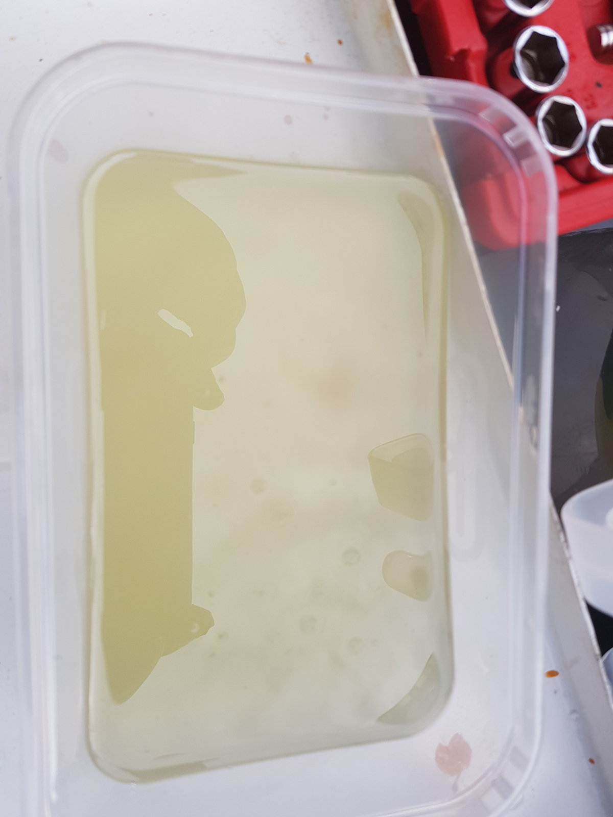

Hard to photo but the Seafoam did react with somthing as there was globules floating on the top afterwards.
I did give all the solenoids a good kicking (1 amp 9v supply) whilst cleaning as well so could have been some sludge that has dislodged.

Do those pistons have any ring of any description? There's a pretty heavy groove on the left hand end.
John :)
No John there are no "rings", the pistons are an incredibly close fit into the bores, a grain of sand would jam the valve body!.
I think they're there to pull oil into the bores for lubrication or to graduate the clutch action.
Some have the grooves and some don't.
It's all beautifully made (should be at £5,000 a box!).

The longest control piston was a task to remove (but again no signs of scoring due to debris).

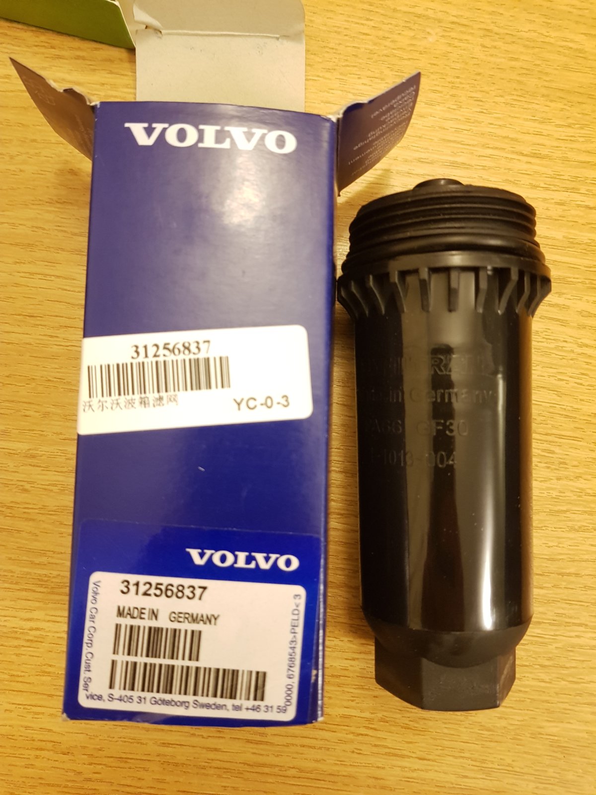

I can buy a Mecatronic unit at £1500+vat BUT it comes completely blank (no firmware).
Would have to fit it then transport car to Ford and pay them to flash it..
Well OCD has got the better of me, I've ordered a 3l Ultrasonic cleaner to use at next oil change in summer to give the solenoids a wash (can crack that off in a summers weekend).

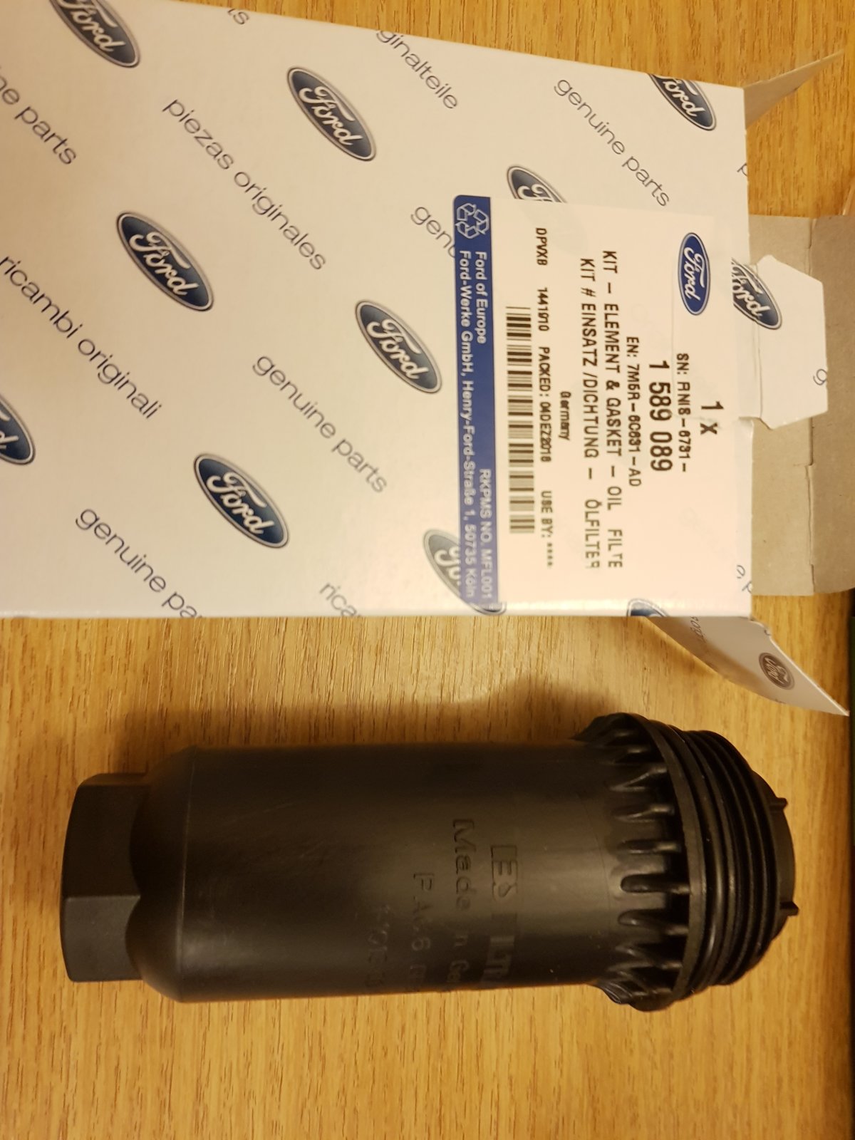

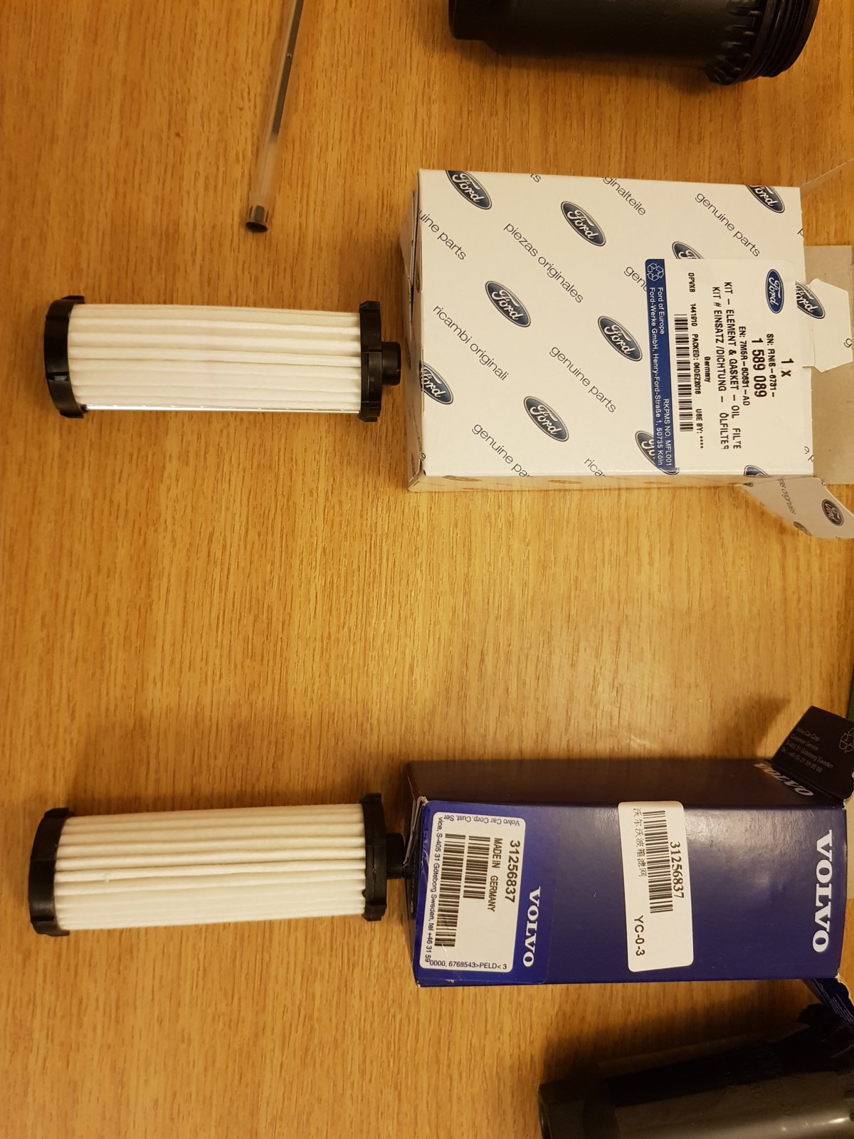

More importantly I've managed to source genuine Ford gearbox filters at £22 each (local dear wants £40!).

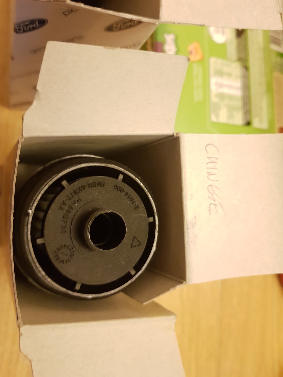

Last two changes I've been using "Volvo" filters that I got hold of at £20 a piece a while back BUT comparing them to Ford I think they are Chinese knockoffs....

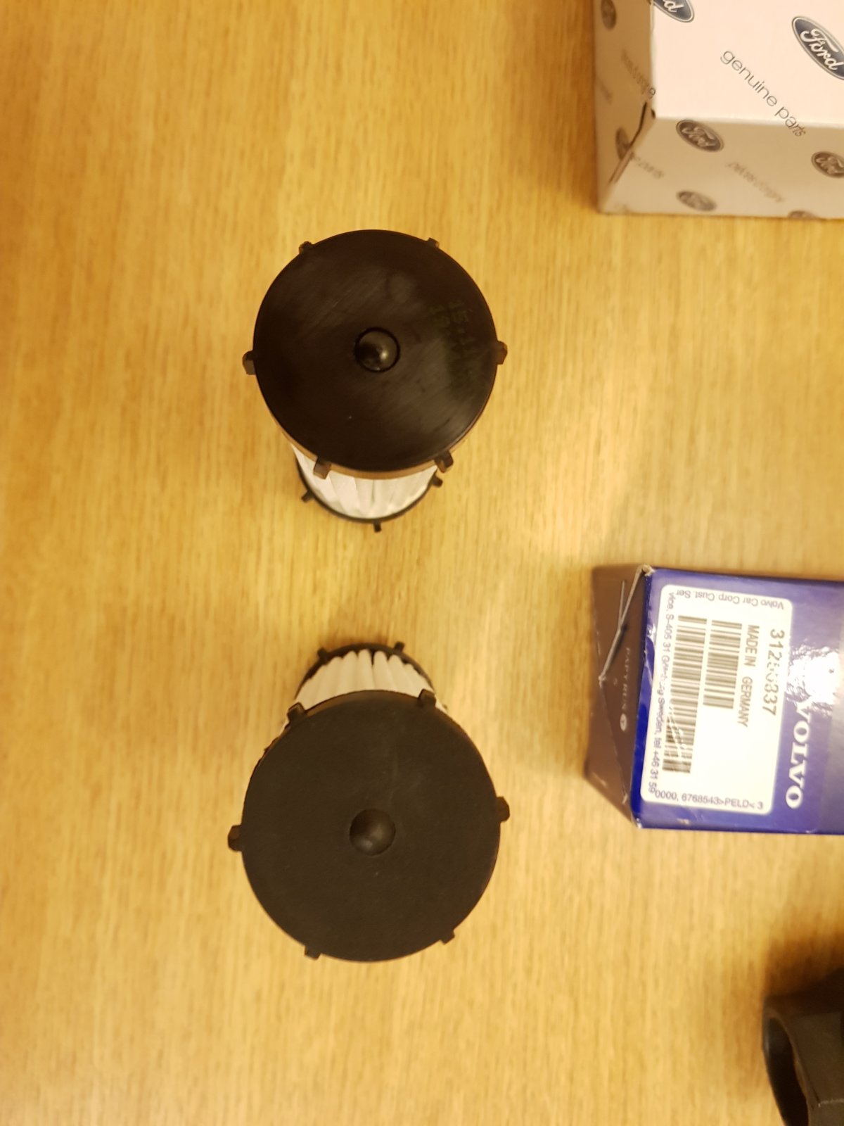

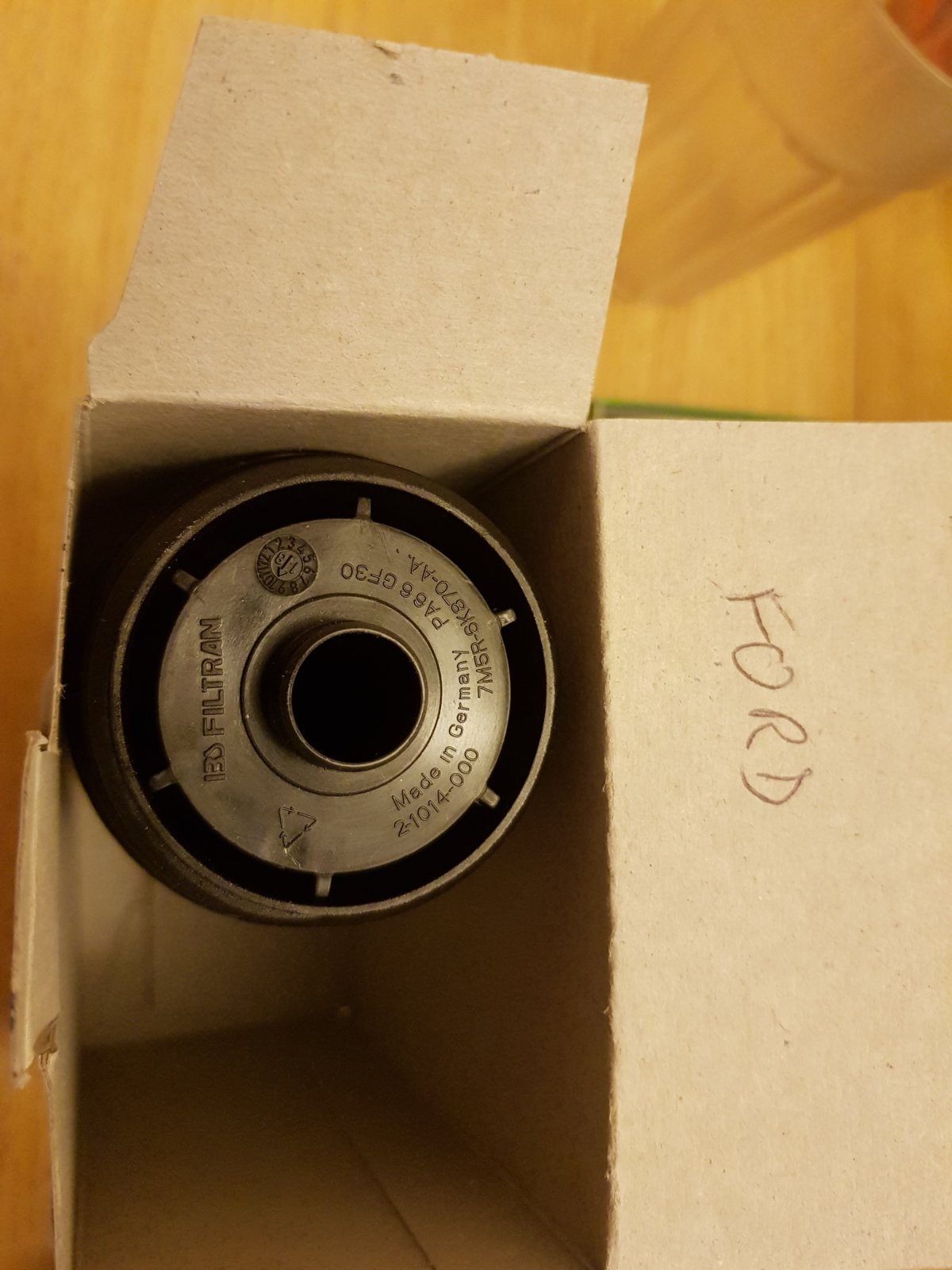

The Ford filters have a Matt housing (much stiffer), the cartrige end caps are shiny, the cartridge middle has a feint red line.
MOST IMPORTANTLY, there is a Bypass check valve on the bottom and the Ford bypass is at least HALF as stiff as the Chinese knock off, more like a third as stiff.....
Googled a few more Volvo filter pictures and they look identical to my genuine Ford ones!.
The Ford 6dct450 and the Volvo MPS6 is the same unit, neither company make the filters (IBS Filtran make them).
Maybe a result?. Poor flow through a sub standard filter and the stiff bypass causing the hydraulic pressure fluctuations?.
