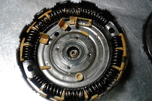

I found a few small pieces of plastic/ nylon, the size of a large grain of sand or better the salt you put in a salt grinder.
So looking into this they use plastic/ nylon around the clutch damper springs!.
Basically every time you set off, the engine pushes the outer of the clutch basket which then pushes the springs (via plastic spacers!).
So all the load of setting off with a full car and 2100kg full tow on the back goes through plastic spacers/ guides..
At this point I've given up, either I have to take the gearbox apart and machine suitable replacements for the spring guides (no chance plastic/ nylon is going back in!) or get shut and lose probably 9k over 2.5 years use.

I'm just trying to decide what those plastic retainers actually do, how much stress they are under and why are they failing so dramatically?
For sure, the filtering will have to be spot on to cope with that, obviously magnets aren't any use here.
Have you got the thing in bits again, or is the clutch pic an older one?

This is from Macktrans, but the debris from mine is identical.
