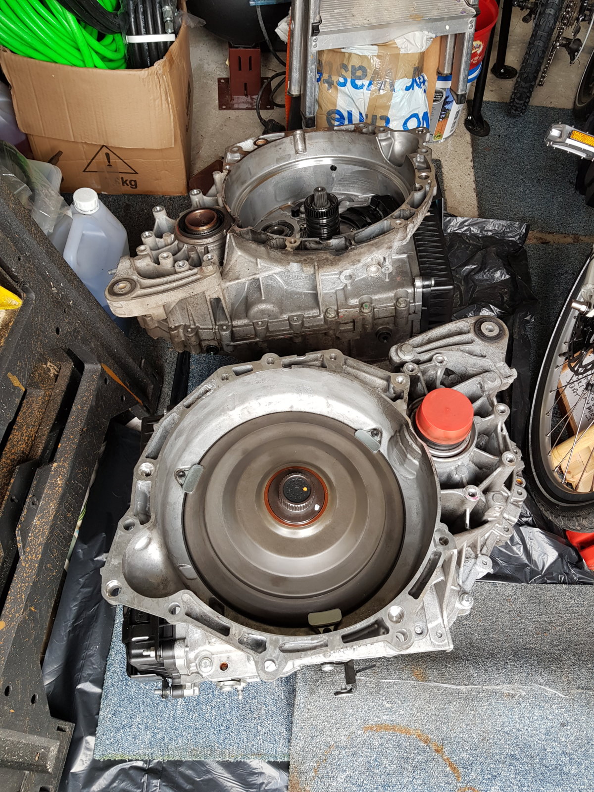

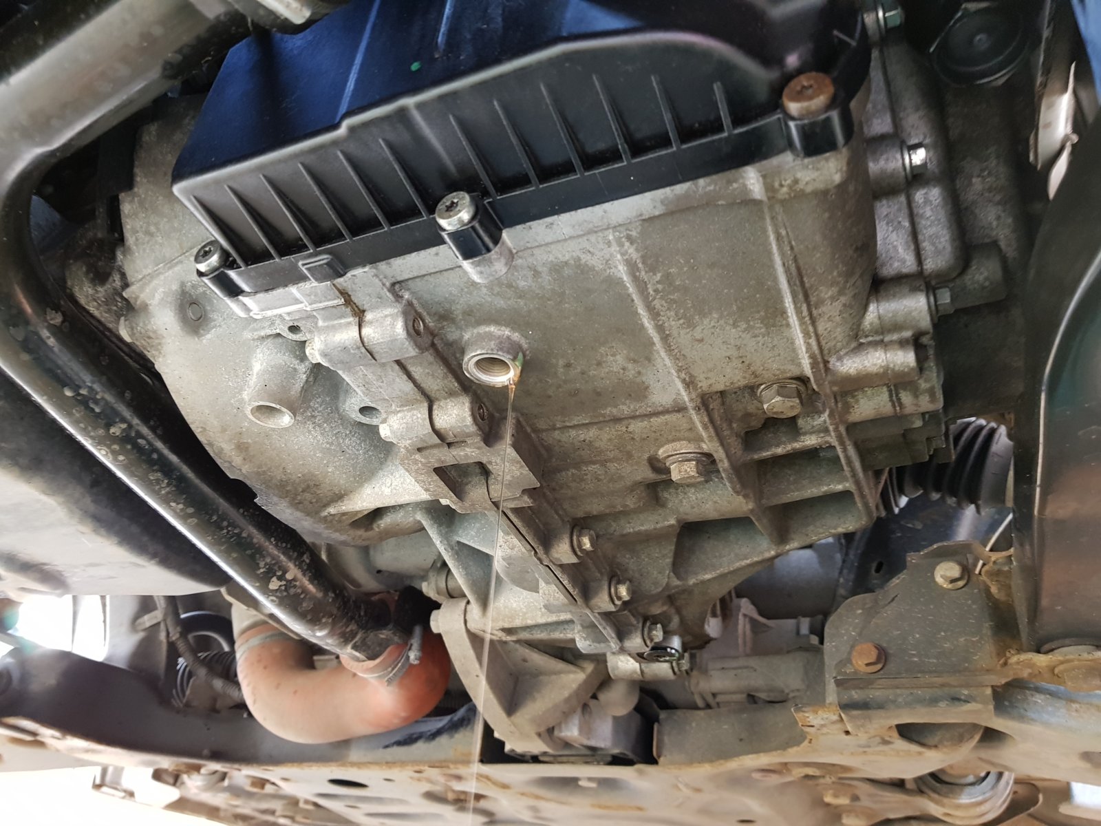

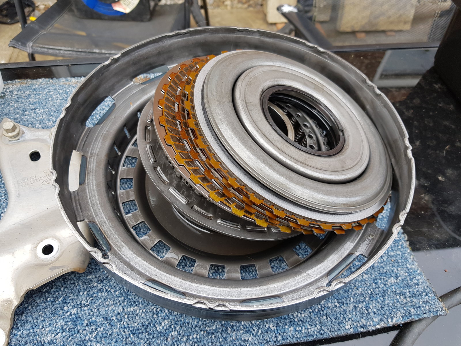

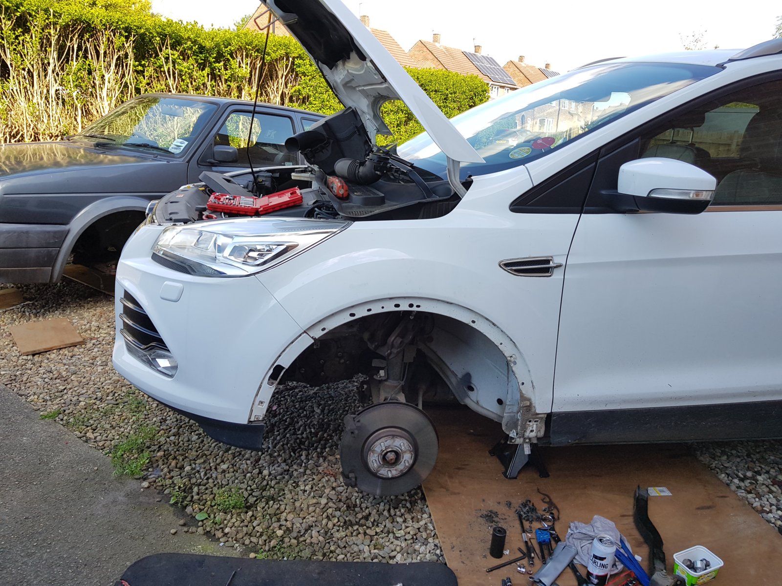

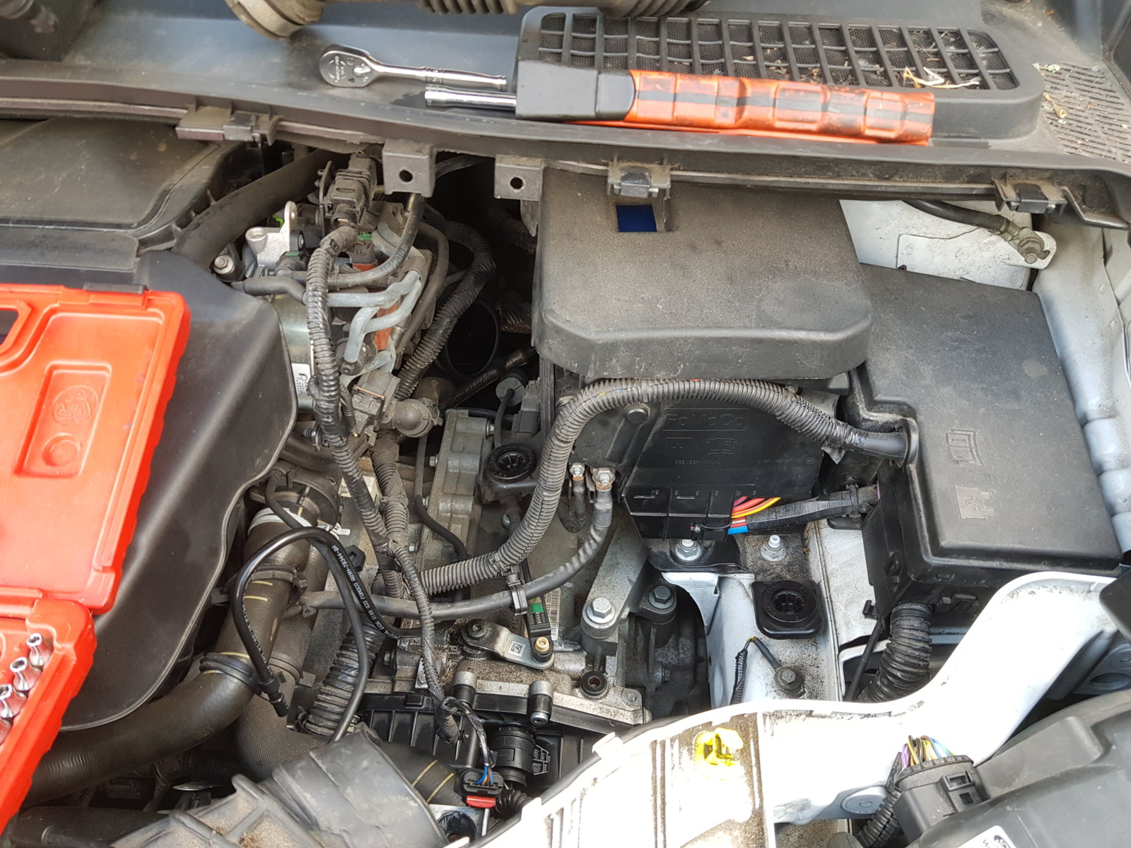

Had a few hours on it yesterday afternoon, looks a right ball ache to take out..

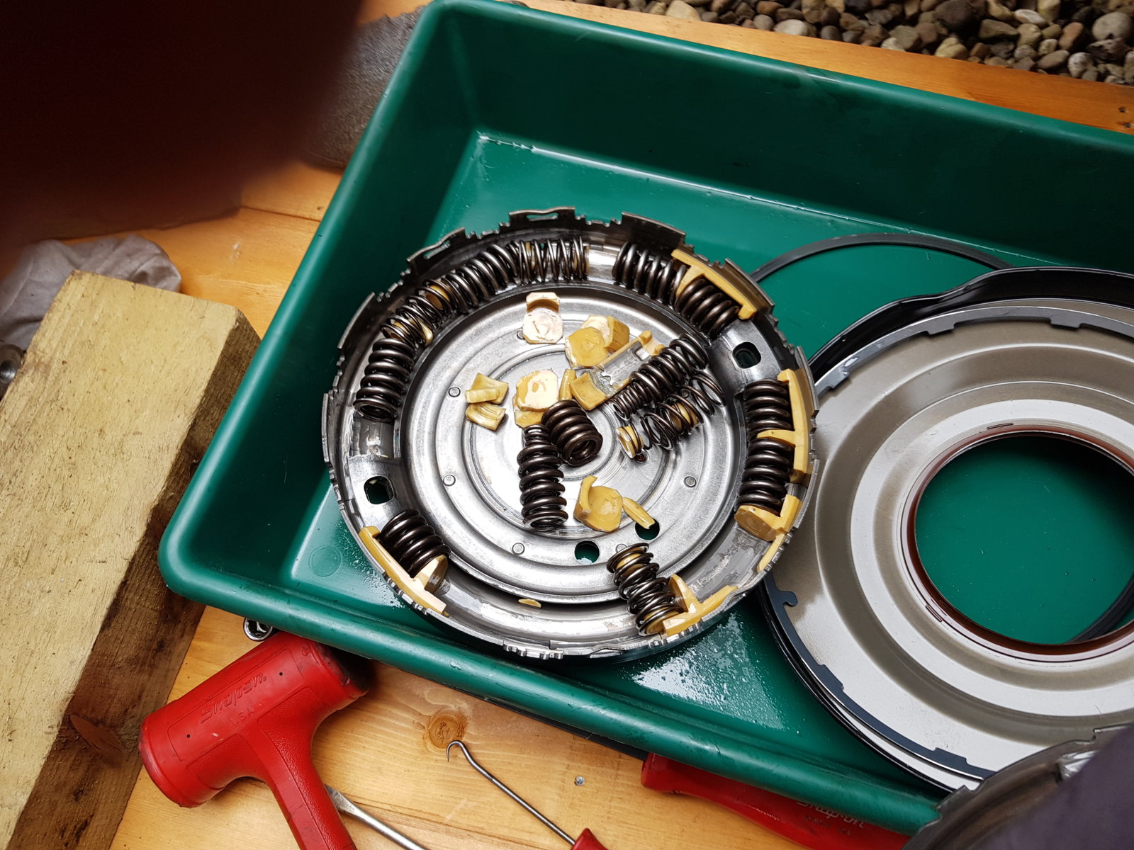

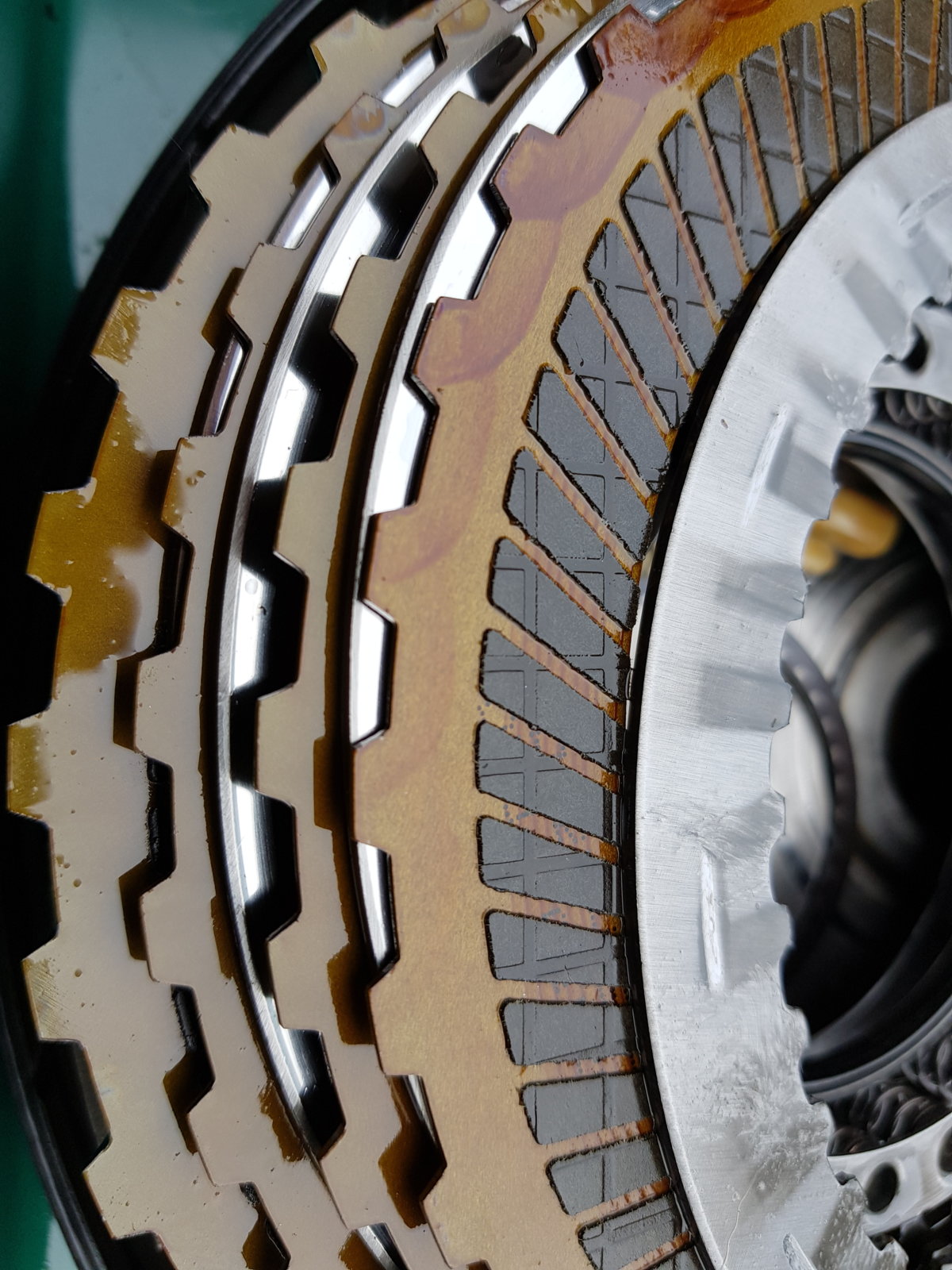

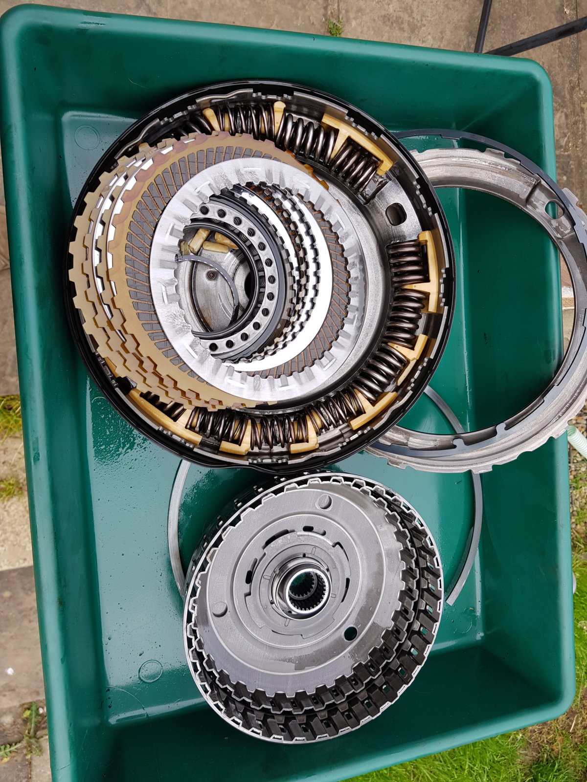

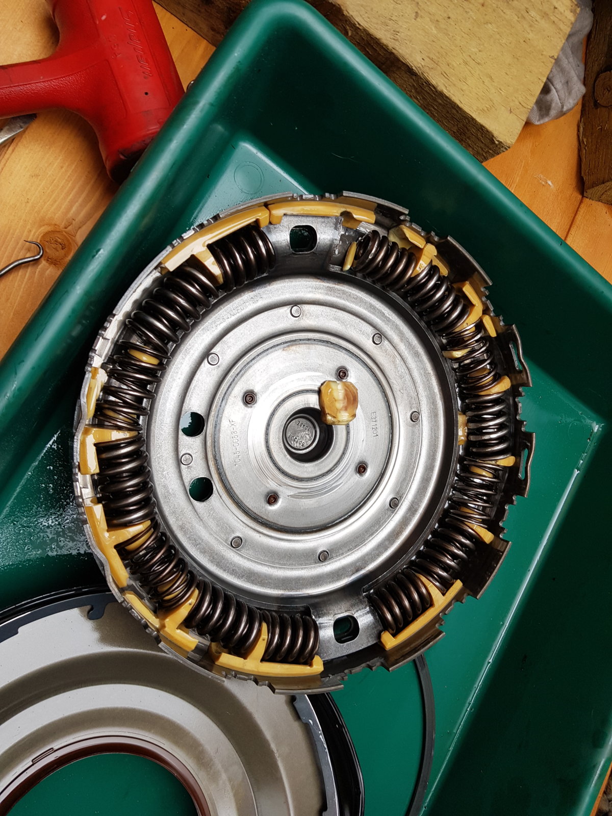

Shes out!, stripped the clutch packs, the dampers are absolutely shot, terrible design!.

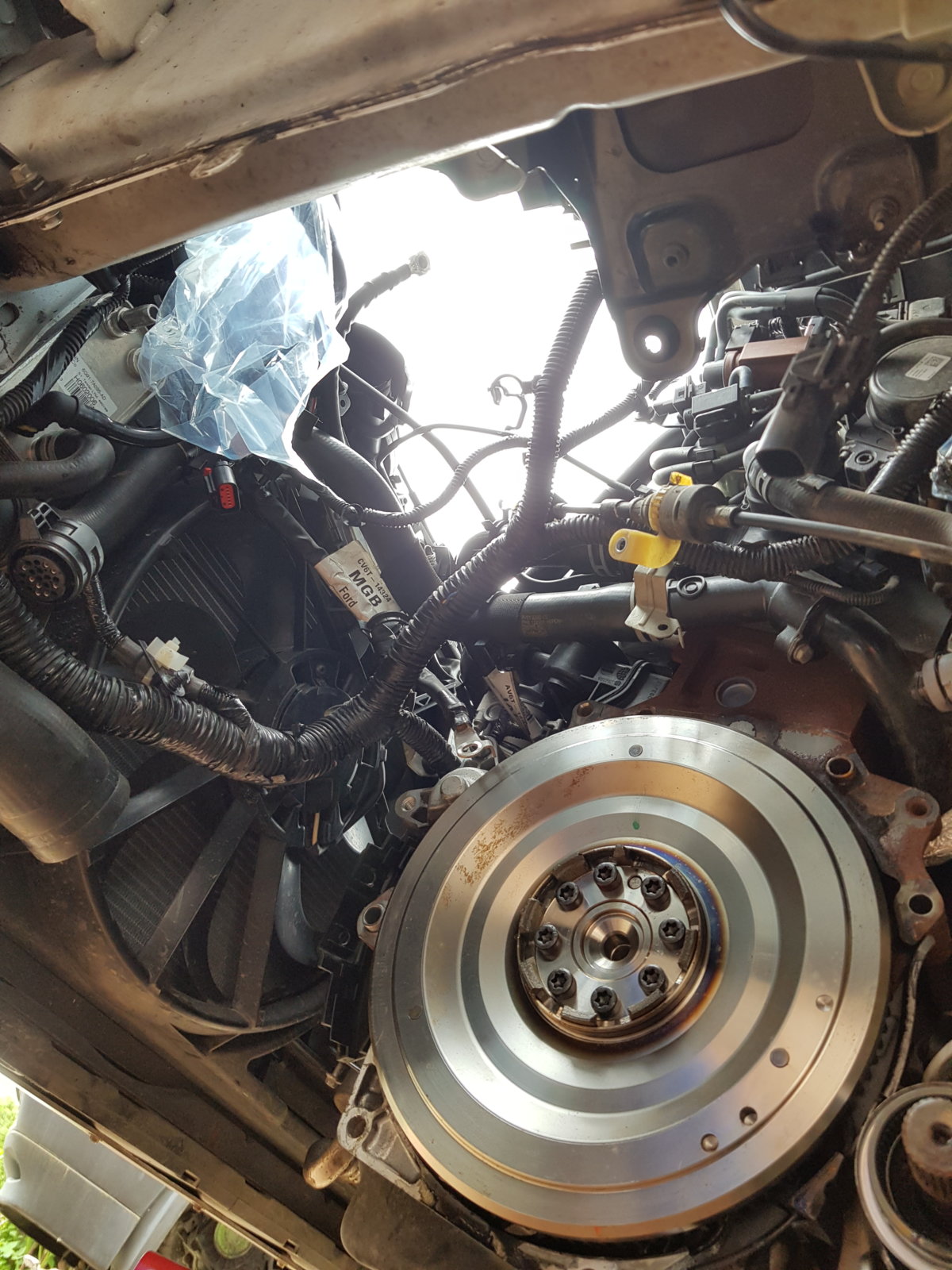

Negative side is the new gearbox doesn't fit!, positive side is it looks like they've moved the dampers back into the flywheel on the 2017 box.
So decided to design a conversion plate and modify the 2017 flywheel to fit (after I've bought it).
Seems worth the effort to get the updated gearbox working.

Ridiculous what you have to take off to remove a gearbox nowadays...

The clutches look fine, plenty of meat left just the plastic has let it down.
There was a fair bit missing, this has all been spat out chewed up and run through the gearbox.

I can't see what is causing the plastic spring retainers to fail.....for sure, yours can't be the only transmission failing like this :(
John :)
Fatigue, heat and being made out of plastic I think!.
Theres loads of these boxes failing, reading between the lines most people pay a fortune for a rebuild (with plastic) then get shut!.

Will see what my 2017 flywheel looks like tomorrow when it turns up. The drive coupling is completely different between my 2013 and the 2017 unit.
