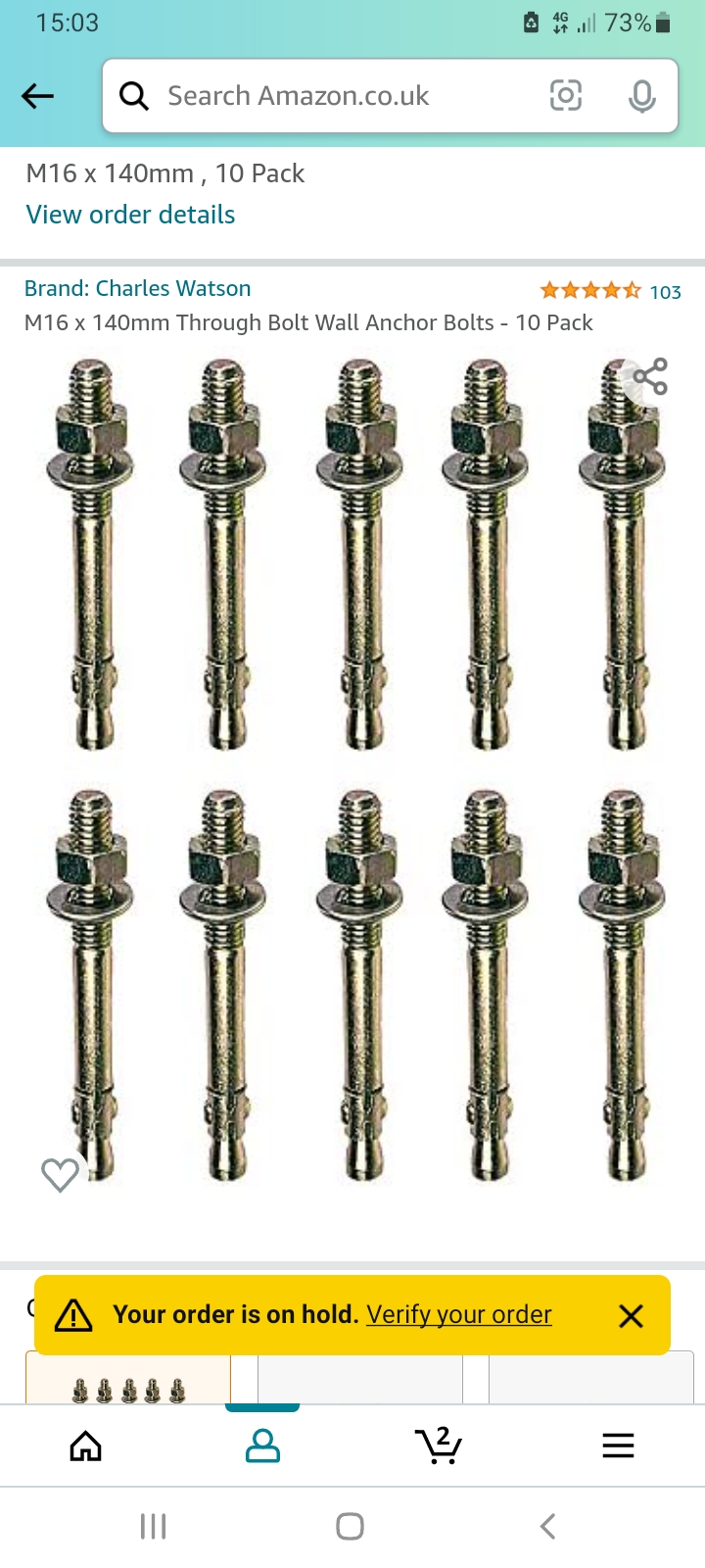

Used a 16mm drill piece in to brickwork. All that happens is the whole anchor pulls back out instead of just the tapered but in to the side.
Instructions say 16mm hole.
What do you reckon try a 15mm hole or am I missing a trick?

You can pre-expand them a little so they're very snug on the drilled hole and then they'll grab as you tighten them - sometimes requires a little agitation to get them to grab initially. You'll find that a lot easier than reducing your already drilled 16mm holes to 15mm :)
Although as above, for all sorts of reason chem-fix is superior.

The depth of the hole is important, it needs to match the fixing, so the fixing bolt hits bottom. You need to put the bolt in, then hit it with an hammer to open it up to grip enough to be able to tighten against it fully.

thru bolts arent the best to be fair. you could get rawl bolts that use the same size drill.

If you've got an impact driver use that to start it off, usually works.
Of course if your masonry drill is a bit worn and the hole has wandered that won't help :)

16mm? LOL. Is this a railway bridge o_O
Is there any brick left to hold these in? That's your problem.

Haha its funny you say that as I posted previously a question about my ledger board (not on here) and got beasted for using m12 on it so removed them and upped it to m16.
I've just ordered some high tensile galvanised m16 stud and resin as well so will be drilling 18mm hole now. .
They are strategically position though to avoid the mortar lines
