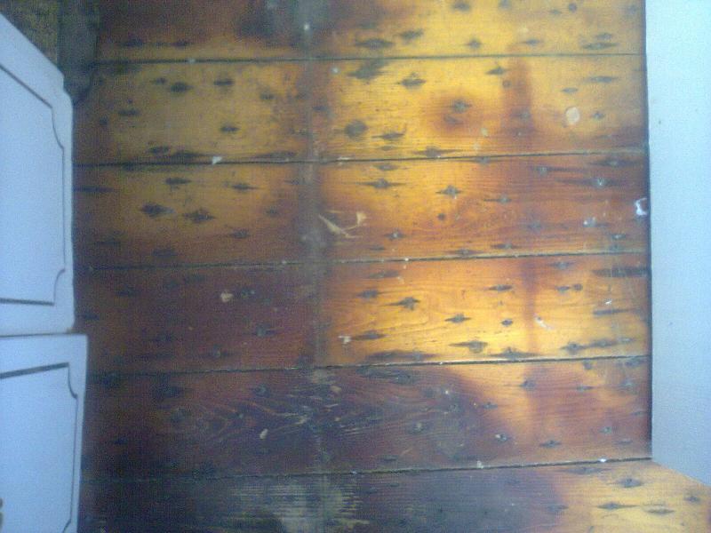

This is the floor.... so im going to put down the ply 12mm wbp.... then screw it down with countersinking screws every 150mm.... then use acrylic primer on the ply.... is that correct.... have a mate thats doing the tiling... just want to get everything ready
Confusing, your last post said you’d “taken up the timber on the floor” which I assumed was the original floorboards. If your overboarding, fix the ply through into the joists (check for pipes & cables) not just into the top of the floorboards. Make sure the original floorboards are well secured first using additional screws if necessary.
An alternative would be to use tile backer boards.
Seal the BACK & all EDGES with acrylic/SBR primer. DO NOT prime the top tile face unless your adhesive manufacturer recommends it, most don’t & it could affect tile adhesion.
