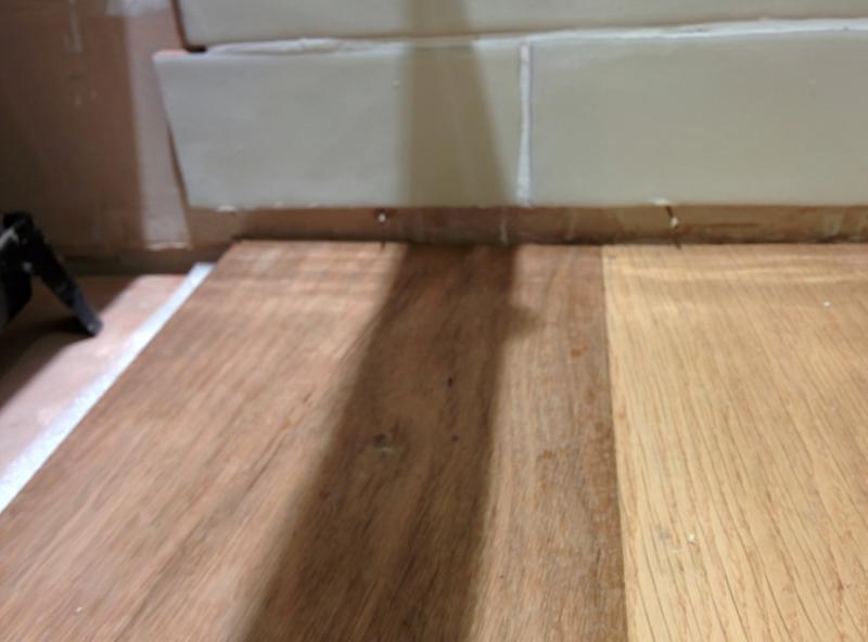

In the bathroom, I've laid a new wooden floor and tiled down to about 1inch from it.
What is the best way to finish it off?
Tile down the wood floor with small gap?
Leave a Small gap?
Or Silcone the small gap?
Or Wood bead?
Thanks[/list]
Treat the tile to floor as tho its tile to bath tub rim - leave a very small gap and silicone it. The gap in the pic is far too large.
There will be more than average movement in the wood floor, and the silicone will have to be watched and renewed when gaps appear.
