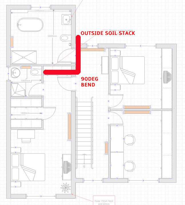

I'm putting in a new ensuite bathroom and I've worked out that I can avoid a macerator type toilet in favour of 100mm pipe. (I can drop 40mm per metre - which appears to be the recommended drop).
I have a few questions though:
1.) I need to make a right angled turn but I'm quite fortunate that the ensuite is part of an extension and the 8" joists run in my favour - meaning the waste runs 'with' the joists both ways (i.e. no joist cutting) which is handy... Anyway, I intend to achieve this right turn with this http://www.diynot.com/shop/Adjustable_Bend_Black/76709. but I notice there is no facility for rodding on this bend. Are there any other options to make a 90 degree turn that allow rodding?
2.) Is a 90 degree turn OK for a soil pipe? I'm worried that it's a bit of a tight turn for the solids to handle - even though I can still drop at the prescribed rate.
3.) Flexible waste that connects to the actual pan.... I bought one in B&Q and the more I look at it the more I'm convinced it will fill up with solids in the flexible parts - and block. If no one has seen these before, the only way I can describe it is that it looks like the vent pipe that you'd use for extractor fans in the bathroom. Am I worrying needlessly? Has anyone successfully used these before?
Many thanks in advance

you don`t want rodding acess inside - and probably not outside unless the drain clearing guy is a scatologist :eek: You just want a bend as large a radius as you can fit in 90 degrees. It`s not the "solids" that are a problem ...it`s other things that can cause blockages. Flex waste - use it if there is no neater solution . it`ll only block in the hollows and will slide through nicely when they are filled ;) so it`s a good thing for really awkward installs

Wow -that was a quick response - I hadn't even posted my diagram yet - which incidentially was this
Anyway - much appreciated! After installation I'll change to a high fibre diet to 'fill in the gaps' as you say. ;)

I'd second Nige's advice. Use 2x 45deg bends if possible to make the turn. Slower the bend, better the chances of not having problems! If its installed properly in the first place, hopefully you wont have to rod it! :LOL:
Again, flexi pan connector if a must, but will a rigid version be able to do the job? I never liked them in the first place, but then saw one that had actually 'popped out' where it went into the drain in the floor. Drain had blocked, pressure when W.C. was flushed was sufficient to push it out. Soon had that out and replaced with a rigid version..... :D

Now ive seen the diagram i'd look at using an access branch where the ensuite joins the stack. Will provide point of access should the worst happen.....
