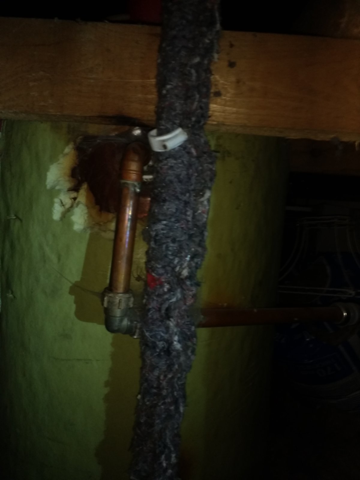

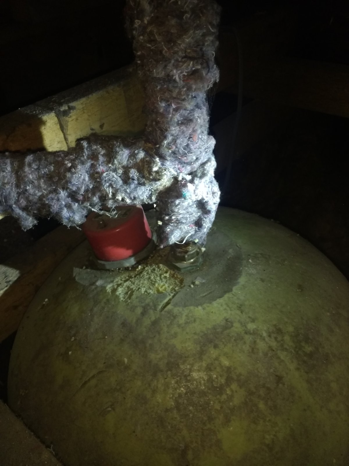

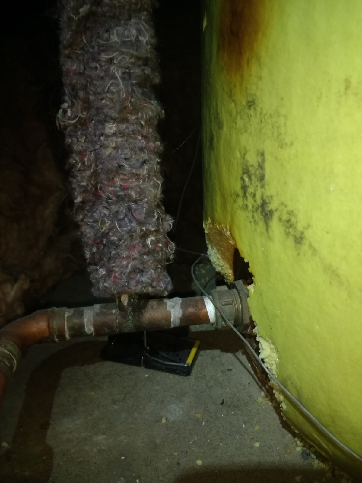

Is this stove solely for hot water?, could you post a pic of your hot water cylinder including the side tappings?.
Yep, the stove was initially for heating only and I had an immersion heater heating the water then I got the back boiler fitted to heat the water. I'll post some pics.
Thanks.

IMG_20200103_180222799.jpgside, bottom IMG_20200103_174348930.jpgtop IMG_20200103_175253061.jpg side,top
Thats a direct cylinder you have, you SHOULD have a copper boiler fitted in the stove, the heat leak would need to be a non ferrous ( brass towel warmer type) and not a standard radiator.
