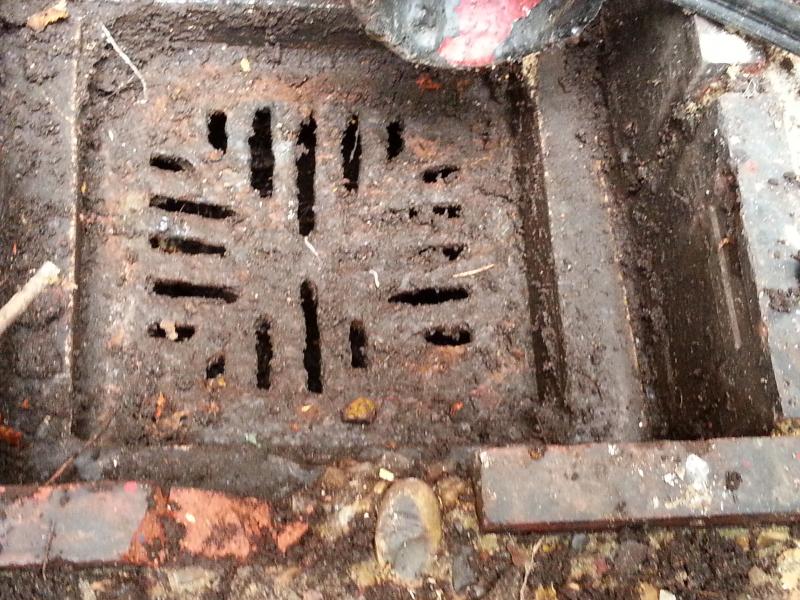

    Hmm, well your rain water may be supposed to go down the gully, through a trap and either off to a rainwater drain in the road or possibly a soakaway a few meters from the house.
    I bet it hasn't for any time in the last decade.
    Are there any neighbouring houses with a similar set up (but no tree of course). Might be worth a look. If its going off to a street drain there should be manhole covers at all junctions and major direction changes, not the same ones as the foul water for the loo and sinks, which are generally deeper, so if one floods into the other, its not foul water leaking into rainwater drains that go untreated to rivers and ditches or whatever. If so, there may be telltale roots visible when looking down the manhole, giving a scope for the problem- being unobstructed roots can go suprisingly far along a pipe.
    If its a soakaway, the pipe will go a few metres from the building and just end, in what was once a hole below the pipe end filled with stones and gravel, that is now probably a mess of weeds and rotting biomass.
    In pre-war properties rain water and foul were not separated, but this leads to sewage works flooding when it rains, so nowadays they are very much kept apart.
    Right now I'd be wondering if it was easier to plan for a new soakaway, or at least a new trap and a outlet pipe to connect lower down to the existing. I'd be extremely impressed if the tree can be removed with the drain intact, looking at the pics - I'd expect the roots of a thing like that to have expanded to a size to have already split the ceramic pipe below ground, just consider what damage dandelions can do to a concrete runway and scale it up. If the tree has broken the metal grid, its likely to have done the same for the pipe..
    Equally, if its not giving flooding trouble, can the rainwater just be diverted on to a flower bed or similar and the old drain simply abandoned for ever, just sawing the tree off short, lets not over complicate it.

    I think a course of action would be to remove the concrete around the gulley - say 18" square or so - and investigate what lies beneath. I'm pretty certain the gulley will be burst through the action of the roots, and any rain water, if it does seem to disappear from the area, is just running away underground. The gulley would need to be replaced, and reconnected into the existing drain if thats in good order. Hardly major works, even if it does sound like it!
    Personally I would doubt if the insurers would come to your rescue - I think they would claim that remedial action was not undertaken some time ago, or similar.....their job is to avoid paying out but do give them a try.

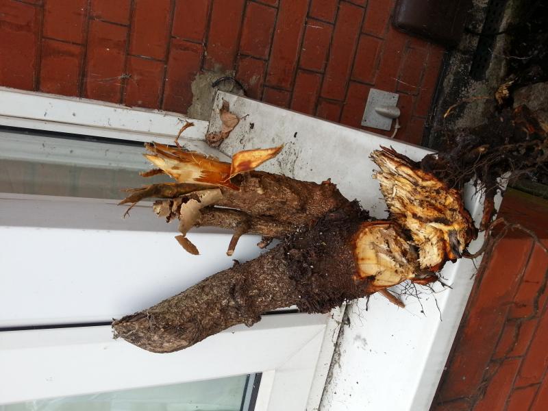

    Hello everybody. Phew.I think I have had a lucky escape. I have removed the triffid! !! It seems that the grating prevented the roots going in. One root had bent along the gully. I chiselled everything out. See the pics.small little finger size roots 2no in the brick wall remaining. But otherwise I believe I have got them all out. I can hear water running down the gully.
    I think I'm in the clear unless you people think otherwise.

    My my! Someone has been on your side this day....there's no problem now.
    Congratulations!
    Just looking at your pics again......the first one is surely convincing!

    Hi John. Thank you. I had such fun and games today and so satisfying. The hammer missed the chisel on several occasions. My left hand has changed colour! also hammer landed on the tile lining of the gully, chipped it as you can see in the photo. Didn't know how to use chisel so I hammered it in like a nail and then couldn't get it out.hv to go on Utube to found out how to use chisel but I got there in the end.
