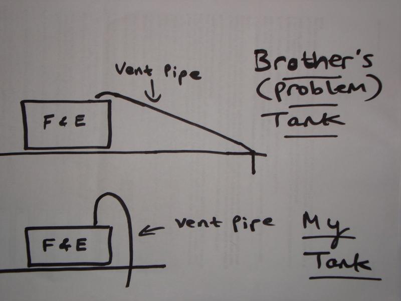

Please excuse my Rolf Harris type diagram (can you tell what it is yet kids?). My brother's vent pipe has a constant trickle of hot water into the F&E tank when the system is on. I'm not sure how long this has been going on - poss. years. Everything works fine.
The pipe rises on a diagonal from where it comes through loft floor, then just rests on the edge of the tank. The vent pipe in my house rises vertically, and curves over like a 'shepherds crook'.
Is the vent pipe the problem, or is there another reason(s)?
there can be various causes, but in the tank with the sloping vent, there is very little extra height for the water to rise before being pumped over, yours is correct with the rise and bend.
Things to do:
1) check the pump is at low speed
2) adjust the ball valve so that depth of water in the tank is only a couple of inches above the outlet
(these are both quick and easy)
3) do a bit of piping to raise the vent pipe so that it has a bend a couple of feet above the water level, and then coming down through the lid on the tank
As it has been pumping over for some time, it is likely to have a lot of corrosion and sediment in the system, you can give this a simple chemical clean and flush (I like Sentinel X400 which you should do before the end of the heating season, since it ought to be circulated hot for 4 weeks before draining and rinsing.

The two sketches are also clearly labelled "Brothers (problem) tank" and "my tank". :roll:
To the OP
The problem is that your brothers vent pipe does not rise far enough above the water level in the tank before it bends over. The distance between water level and the top of the bend should be at least 400mm.

This is from the Vaillant Installation manual:
It is possible to have the pipe sloping, provided the length from the water level in the tank to the top of the bend is still 400-450mm.

D_Hailsham - The length of the vent pipe from floor to tank is about right, but it doesn't rise at such a steep angle as the one in the Vailant manual that you included. Also, the pipe rests on the lip of the tank, yours is some way above the tank.
It's not the length of pipe from the floor but the length of pipe above the water level which is important; this is clear from both diagrams.
When the water is cold, the level in the vent pipe will be exactly the same as in the F/E tank. When the water is heated, the level in the tank will rise due to expansion, but the level in the vent pipe will rise further because the pressure in the vent pipe will be higher than that in the cold water feed pipe. If the vent pipe is not long enough you will get pumping over.
This problem is reduced by ensuring that the connections of the vent and cold water feed pipes to the flow pipe are no more than 150mm apart. Ideally the flow pipe should be horizontal with the vent and cold feed rising from it - the cold feed can be connect in a inverted loop as in the Vaillant diagram; this prevents air bubbles rising up the cold feed pipe.
