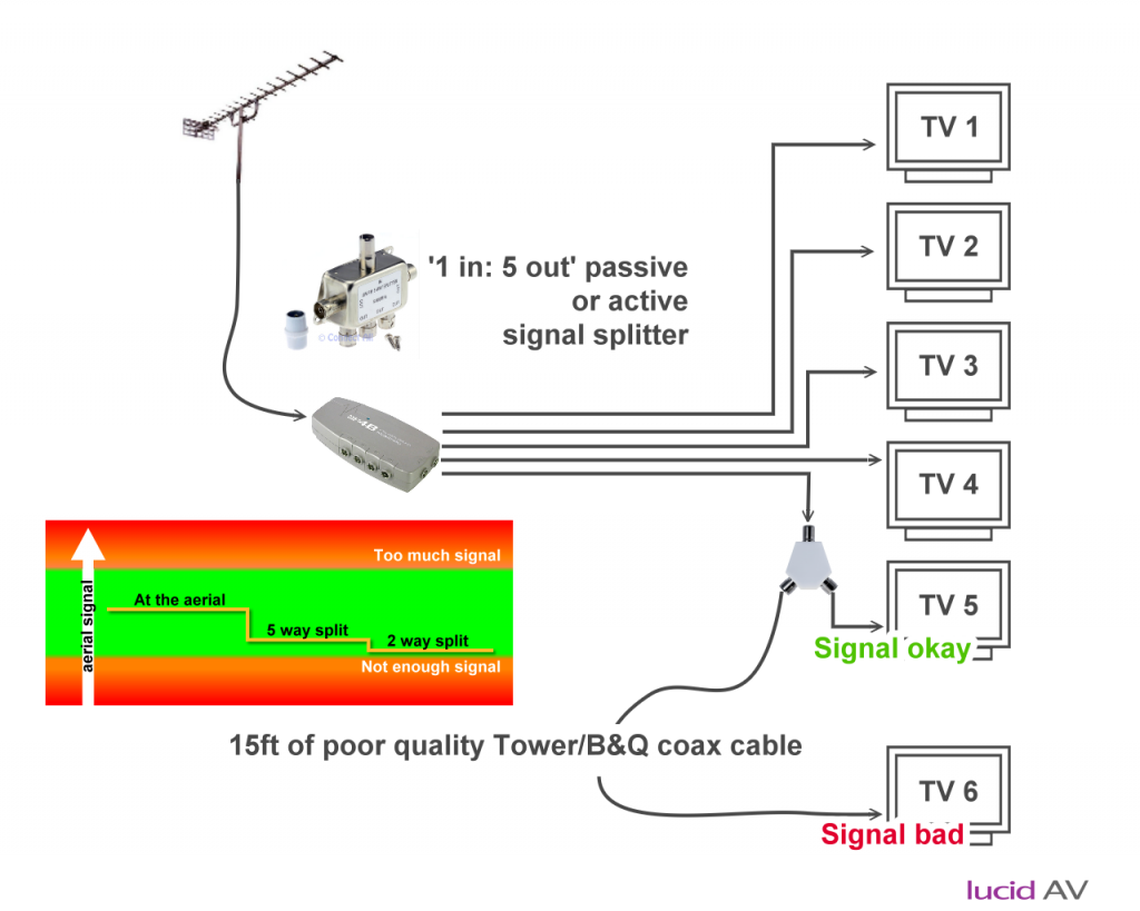

I live in an area where TV reception is difficult so the houses have very tall outdoor Ariel's. My Ariel lead comes in through the bedroom window and with the aid of adaptors and enhancers I have connections to 4 TVs. in the bedrooms (The reception is perfect)
For the 5th TV, the Ariel lead continues from the window on the outside wall and enters the living room to the 5th TV. However, I keep getting distortions on some channels. I have unplugged the other sets leaving just the 5th plugged in but I still get distortions Is it because the cable is slightly longer (only about 15 feet)
Can someone please advise.

From what you have said I have this as a vision of your system layout:
The signal split to feed TVs 5 & 6 is where you've said the issue is. But only affecting TV 6.
So what I'd guess is happening is that the signal is just about okay after the two way splitter and there's enough quality to drive TV 5 via the short coax cable. But when you've added 15 or so feet of iffy B&Q cable it's the straw that broke the camels back. The quality is bumping along the very bottom of the acceptable range. The weaker channel groups are starting to break up.
Changing the cable from the splitter to TV 6 will claw back maybe 1 or 2 dB if that Tower cable is really bad. You should also check through the rest of the connections in the chain from aerial through all the splitters. Multiple adapters and cable joiners won't be helping your cause.
That's pretty much what I described except I would use a proper low-noise masthead amplifier (not a "signal distribution booster"), a fully screened metal splitter (not plastic) and the two split cables should feed the shortest runs, using the best cable.
