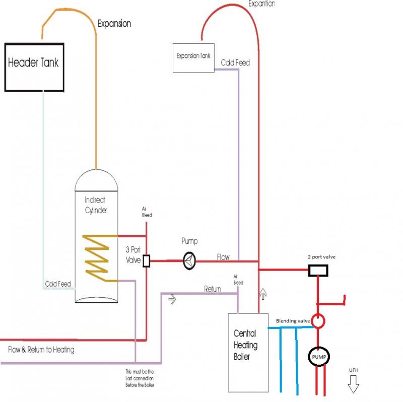

My plumber has added ufh to my small extension and having done some research before hand was wondering whether this would work, in terms of controlling ufh seperate from ch. the ufh has its own room stat and my controller is 3 channel. have attached a sketch of how he did it.

Sorry haven't worded the question well. I have read alot about "backfeed" and that i should convert to s plan system otherwise when ufh calls for heat it will also call at the mid position.
The system isn't OV by the way. just had wrong diagram.

Where does the UFH Return connect to the Common Return?
The UFH pump will normally just circulate through the loops, depending on the size of the UFH system of course, and if the UFH system is on, on it's own, how you going to get circulation from the boiler to the UFH manifold?? Lastly, there's a danger of uncontrolled circulation through the open port on mid-poss valve(HW) when it's at rest. A circulation pump will circulate to anywhere if there's no valve in it's way & the resistance in not too big for the pump head.
Not a good design, one pump could pull against the other when both on. this would cuase cavitation and if it was an OV system it would cuase water to be pulled down from the expansion tank and would cause pumping over via the expansion pipe, what size are the primary flow and retun pipes?.

It aint gonna work.............is this a condensing boiler? , if not i can see trouble ahead. :shock:
You wont be able to have the ufh on its own as the three port valve always has one port open, so you will either have the rads on with the ufh or the hot water cylinder with the ufh, perhaps your "plumber" should have another go.

Can anyone stop the mistakes in this schematic picasso posted up??
I would have put the cylinder return as the last connection to the boiler other than that ?? (the cylinder isint showing as unvented)
