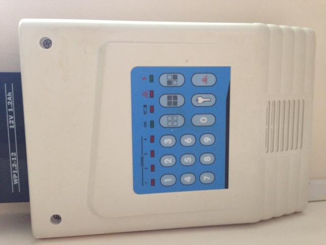

    As per the forum post, I have what seems to be an unidentifiable Alarm, taking the lid off and trying to find any markings on the core PCB haven't proved fruitful. So whilst all installed and seemingly working, we have no way of knowing how to arm, disarm. We had an alarm guy out, he wouldn't touch it and wanted to install an entirely new system.
    We have PIRs all over the house seemingly wired into the mains. They look quite expensive and well installed.
    Can we use these with a new alarm system, are PIRs standard, or do they need ripping out and new ones installed?
    Will try & post a picture of the alarm later.

    Feel the quality. Here she is. Help!?

    Well, I'm afraid I'm beaten, no idea, sorry.

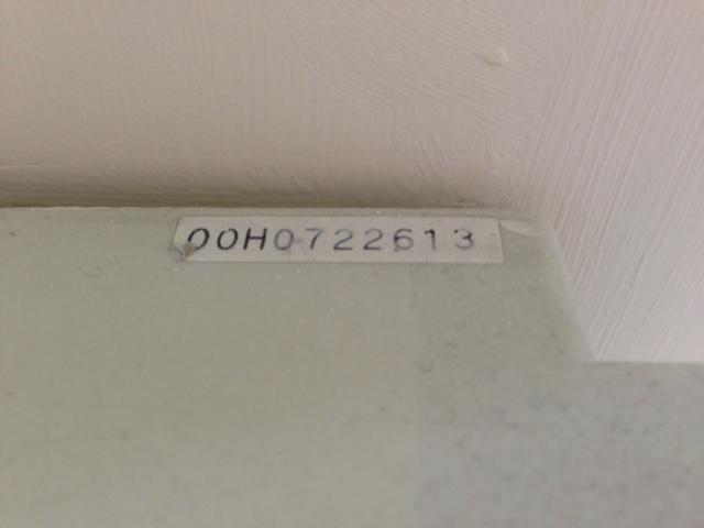

    Let us have that number, it might mean something to one of us and I would like to run it through all my manuals, you never know.

    I think its a Response alarm from one of the sheds, wickes, B&Q etc. Sadly doesn't seem to be on their current line up of stuff though.

    Nope sorry it's either some American or European cheap panel....

    Half right with the Shed bought. Still no wiser for a model number.
    All honesty, I wouldn't ask about what it IS, but what you should replace it with.

    Looking at your picture I would say that it is an old Response alarm.
    Note the conformations,
    BS6799 Class 3 for Wire free alarms
    and
    DTI MPT 1340 Radio Communication Alarms Standard

    Its wickes, "" Ist got their name on it ""
    If you really want to use it then contact their customer services.

    Guys thank you so much, really appreciated, I'll post up that number too to see if that's any help, and then go from there.

    Definetley a wickes wirefree 4 zone response alarm, just need to find the manual now. Tried in vain, it must be somewhere

    I would contact Response and see if they can identify it.

    Thanks guys, just spoke to Response, they've IDed it as a SOLA 400 and sent me the manual. Thanks to you guys, I can use this Alarm now. You're all welcome round at mine for PIMMS and BBQ. If anyone wants the manual, let me know.
