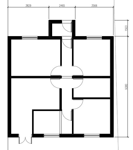

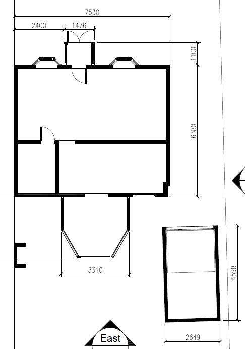

Our drawings, which were submitted as part of our application clearly show that the existing external walls, which would become the internal walls once the bungalow is extended, are to be demolished and a new floor plan will be created. Furthermore, the drawings also show a completely new roof plan which is to be supported by these walls.

I spoke with the officer this afternoon and confirmed that we are building in line with the drawings. By comparing the existing and proposed drawings, it is clear which walls are to remain. The officer hinted at the fact that we should have built the wrap-around extension first, and then demolished the existing external walls once they have become internal walls. The fact that this would have been difficult (and expensive) to achieve is of no concern to them and only concerns Building Control.

I have uploaded most of the drawings which formed our PP as well as the only 3 conditions within the Decision Notice. If you guys wouldn't mind taking a look to confirm your advice, that would be great :).
