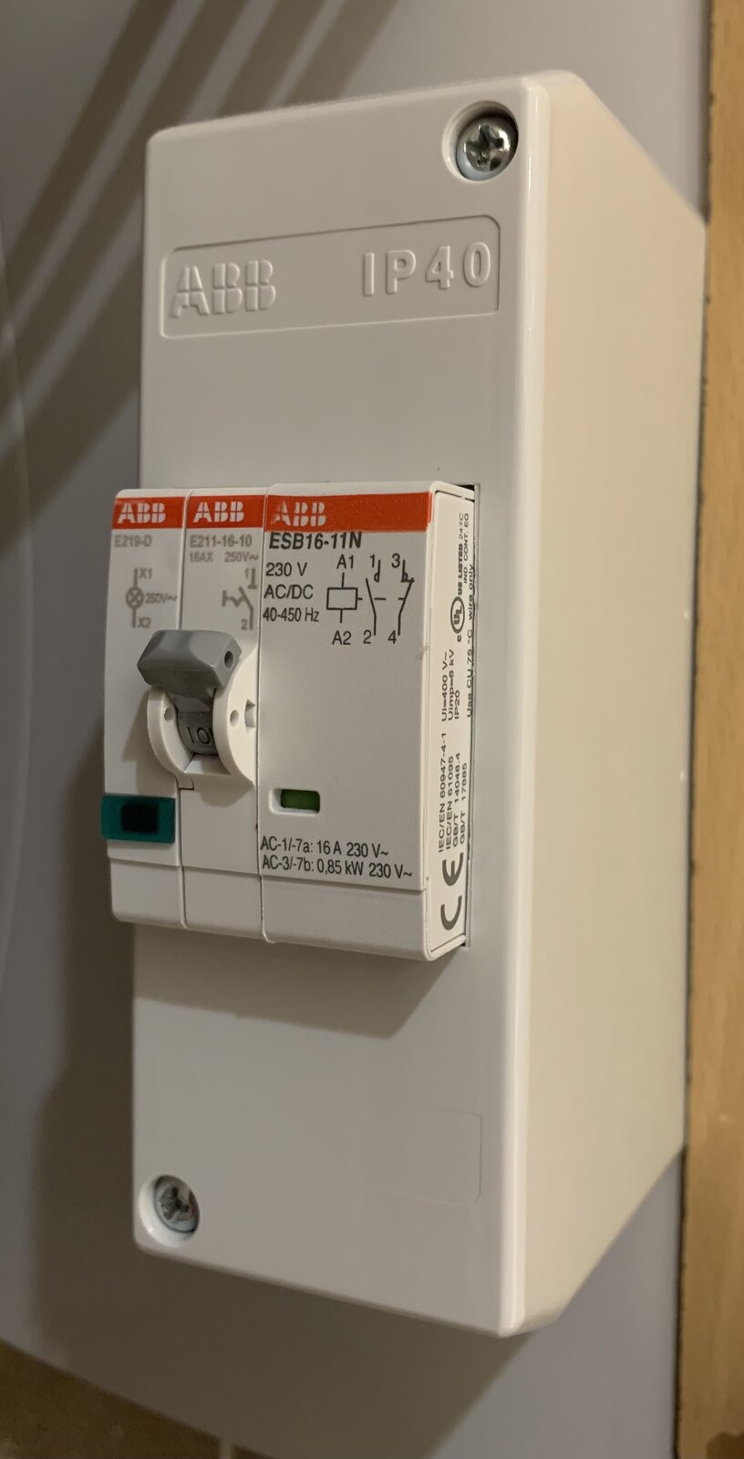

    As a bonus a simple relay, a switch and an indicator lamp.
    The lamp shows us that 240v DHW is active.
    When 240v DHW is active and when switch is ON the relay breaks 240v live for heating demand, shutting all heating valves that results in immediate removal of 240v from RT terminal of the boiler even if Nest thermostats are demanding heat.
    When switch is OFF the relay does nothing, allowing Nests to steal overheated water during cylinder charging cycle for heating.
