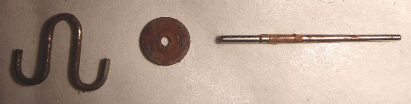

We still have one of these boilers, which is still going, despite now being about 35 years old. It can however be a bit temperamental, and since recently changing a leaking servo valve, I've noticed the CH doesn't always fire up after using hot water. I've tried adjusting the push rod that activates DHW, but the problem seems to be that the rocker/push rod is not returning all the way down when DHW stops. I can easily push it down manually with a finger, and then CH fires up. I don't think the servo valve/rocker is sticking, since its new, so I assume the issue is in the water valve. I did recently check and clean the water valve when I replaced the diaphragm and there didn't seem to be any issues with the push rod - it was moving in & out freely. However - there's another sprung rod inside the water valve (below the diaphragm) which is not moving as freely or smoothly. According to the parts diagram, this lower rod is the 'water quantity regulator' At one point it looks like it was possible to remove this regulator by unscrewing it using long nose pliers, but it's basically seized in now so I can't take it apart to clean it up. Is it possible this regulator/lower rod is sticking, and stopping the upper push rod from lowering properly when the pressure changes inside the water valve? On a related note, I seem to go through diaphragms fairly quickly, and its always due to a small hole where its pushing against the end of this lower rod - which gives me more reason to suspect its sticking and giving more resistance than it should.
So the question is - should I just get a new complete water valve, or could it be something else? (I see in the installation manual for this boiler that I can also adjust the microswitch position using a couple of screws - worth trying?). If I do get another water valve, I think its part no 0011299 (which no longer has a point to connect the pressure vessel) - is that right?
Many thanks for your help - I'm determined to get a few more years out of this boiler, until its no longer possible to buy spares.

Clean out all the servo control pipes (use cycle brake bowden cables). Check the banjo bolt connection on the diverter (sometimes they have a restrictor - if so pull out the bits, see the image).
