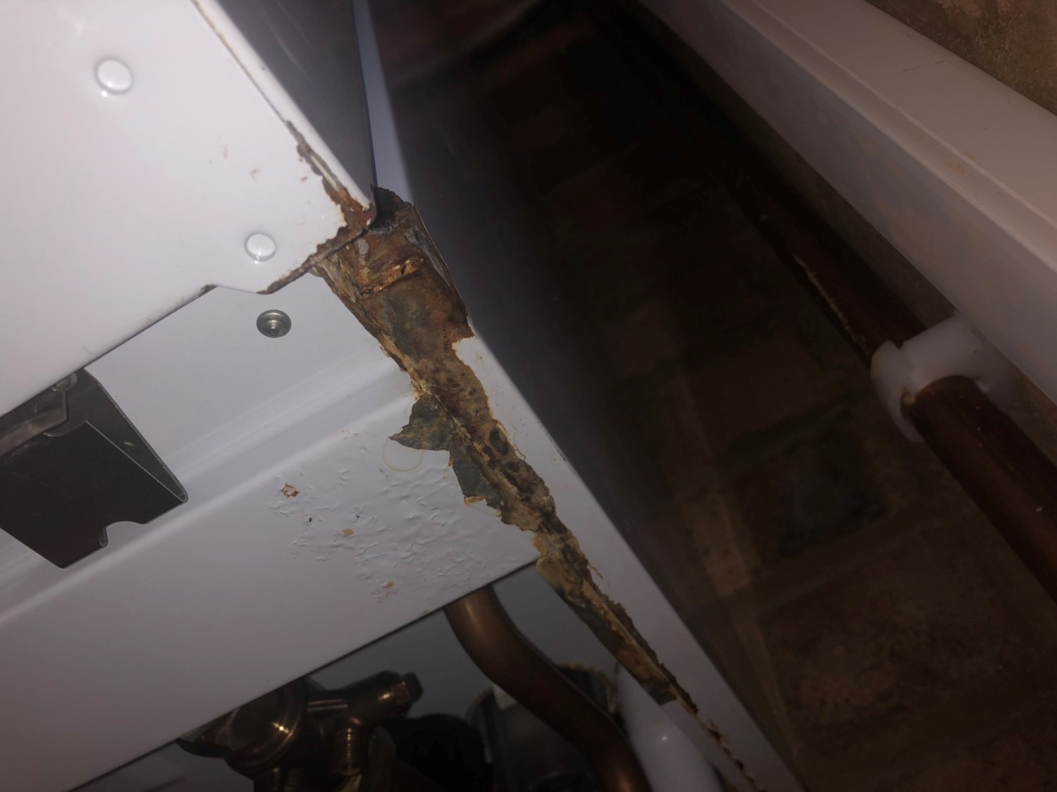

Hi Guys
Last night due to sleeping in a bedroom above the garage I was awoken by a clunking noise at 4am which i tracked down to the boiler in the garage below
On closer inspection I felt slight moisture, possible 1/2 drops of water on the bottom of the casing corner, as well as rust along the bottom
I have homeserve cover albeit with £95 excess. The lady on the phone was very kind told me rust was normal and got me to fill the pressure gauge to 1.5 bar which i did and keep an eye on things and was said the drops can just be condensation
It does seem plausible but it seems alot of rust and peeling for condensation. The boiler had its last homeserve inspection / service in March this year and they only thing flagged up was a powerflush needed which I had done . The boiler is 6 years old and ive included a picture of the issue below
My question is, is it worth paying the excess and getting someone out or am i being Paranoid?

That does look more like a leak to me but hard to tell from the pic. Mine had a very small drip. Small enough that I thought it might be condensation but a bit of investigation and it turned out to be an o-ring on the inlet pipe. Pretty easy fix. I was quite surprised how deteriorated the old one was.

if it is the condensate pipe within the boiler thats split which is common on this boiler then the boiler is classed as dangerous ;)
I spoke to Valliant homeowners technical helpline and they have advised to get homeserve in and reckon the boiler casing might be compromised after seeing the pictures. I will keep you all informed

It’s whats going on inside that you should be worried about ;)
Ok engineer has been:
The boiler is BER and needs replacing because the casing is corroded through and has separated in places . The leask was done to a faulty air release vent that was slowly trickling out water
My policy does cover a replacement boiler, does anyone have any idea on what they use as replacement models?
Further update, I have received a call from Vaillant who are organising a heat survey to determine what new Vailant Boiler is to be fitted . Yes homeserve probably arnt the best but in this case they are replacing like for like boiler and has been done pretty quick, all for an £70 yearly premium and a £95 excess
Seen this many times with Vaillant ecotec, one of two things usually, a leaking diverter valve (internal seals)
Or internal flow or return pipe seals leaking, the connections being push and clip with an O ring seals.
